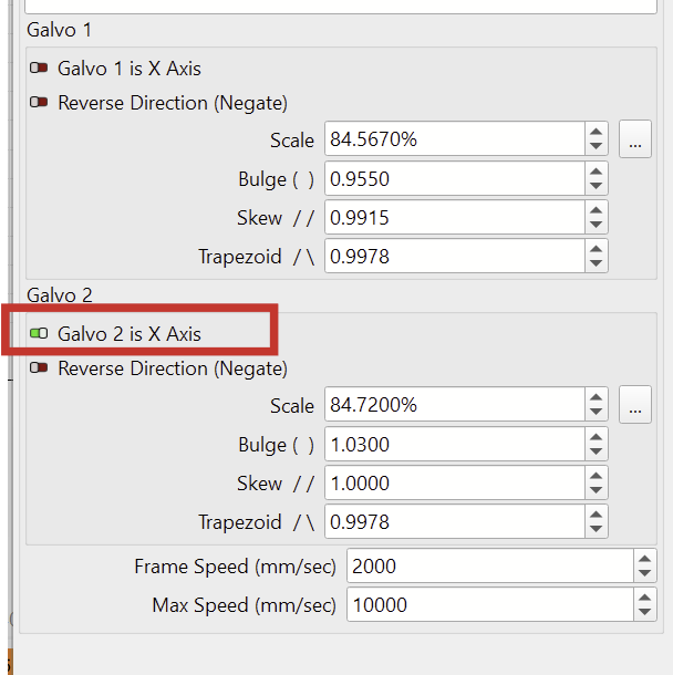

Ugh. I watched the Gweike tutorial again last night, and I retraced my steps, and I believe I forgot to add the device parameters after creating the device. It is now working as expected, except the text is rotated 90º clockwise. I’ll figure that out…
Edit-
…and figured the rotation out. The device parameters image provided by Gweike shows galvo 2 as the X axis, it should be galvo 1,
Flip this switch:
The instructions in the video might not apply to your specific machine.
I’d suggest using either the screenshots from your USB stick for the Scale, Bulge, Skew and Trapezoid values, or the config file I posted. if you are also using a 150mm lens.

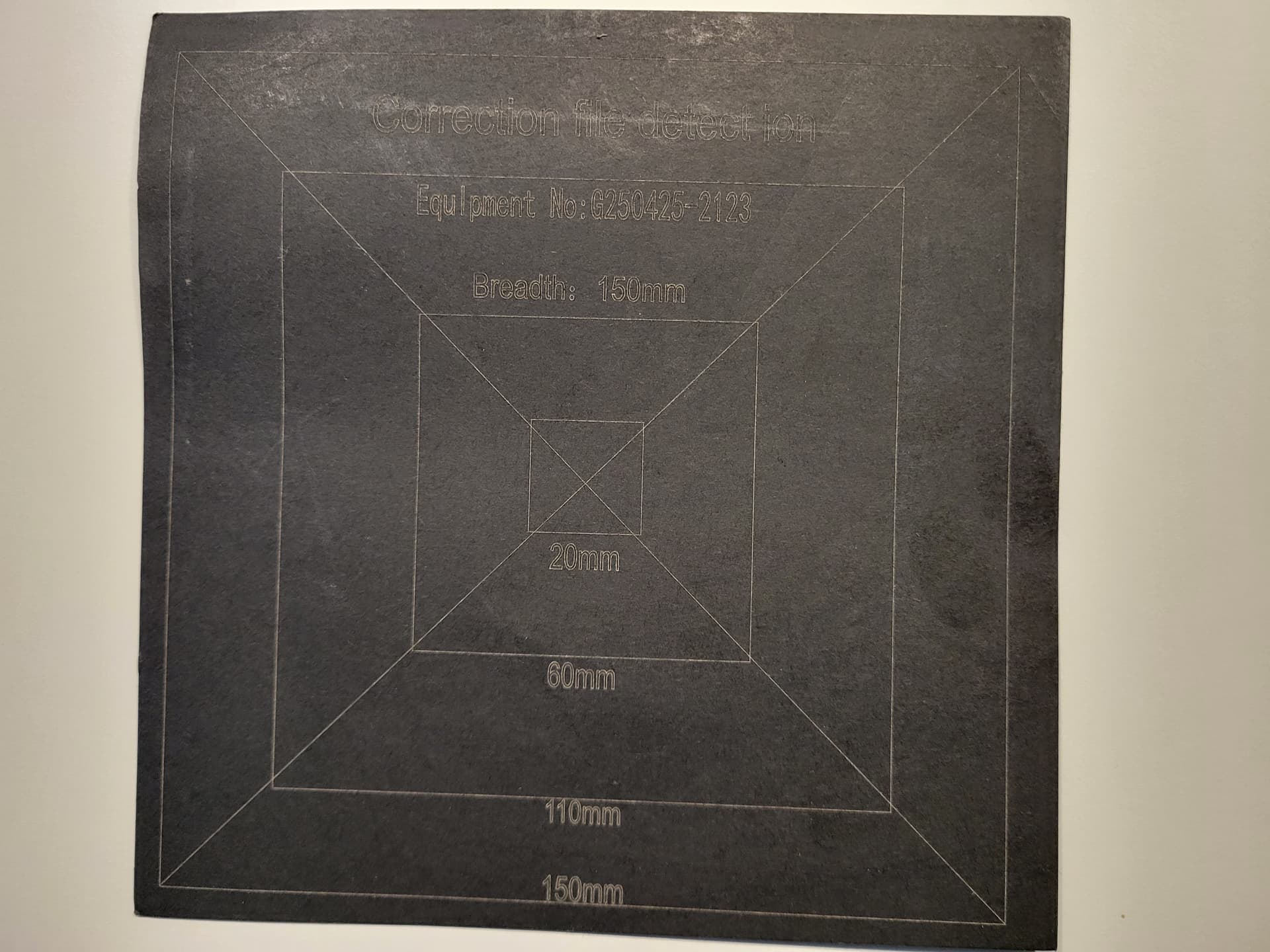

OK, the G2 came with a black piece of paper with 20mm, 60mm, 110mm, & 150mm boxes so I used that.
I created a square and increased the size by those increments.
the 20mm square was properly square and dead on for the measurements.
The 60mm square was properly square, but was slightly long on the Y axis, good on the X axis.
The 110mm square was not properly square and was also long on the Y axis. The lines along the Y axis bulged outward slightly, the outer limits of the bulge were 110mm, at the corners it was less. The X axis lines concave a bit.
150mm had the same distortions as 110mm, but more exaggerated.
I did this before you posted the timing values, I tried changing those but it didn’t seem to make a difference.

Here is the paper I mentioned:
I placed this on the base, centered on the red laser. I then used live framing with the incrementally larger boxes as described before.

Thank you for the picture. Now, I do remember seeing this paper. It went straight to the bin, because I didn’t trust the “Breadth” to be very accurate: :melting_face:
To measure the accuracy of the Scale value, you only need one reference distance at a large size.
You can use the paper, if you are sure the dimensions are correct. (Use a ruler to measure the sides of the squares)
But ignore the center point! As you can see in the marked circle, the squares are not properly aligned.
Just frame a square of a known size, and measure the length of the sides.

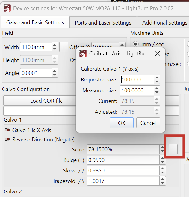

To fine-tune only the Scale values for more accurate dimensions, you can do the following:
  • Engrave a rectangle of 100x100mm (You can use the black paper)
  • Open the Device Settings and click on the three dots next to the Galvo 1 “Scale” field:
That’s your Y axis when looking at the G2 with the stand on the left side!
  • Measure the height (front to back) of the engraved square with calipers or a ruler and enter the value in the “Measured size” field.
  • Klick OK and repeat the same for the Galvo 2, X axis.

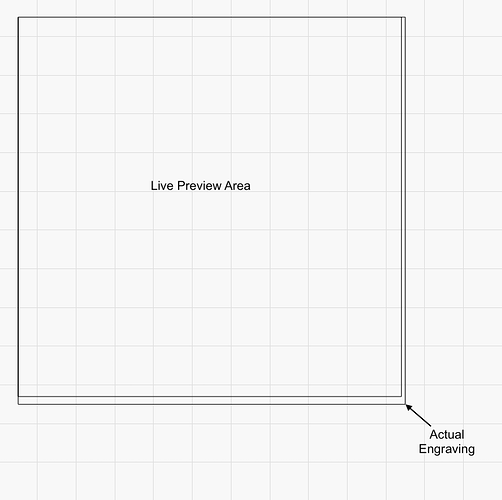

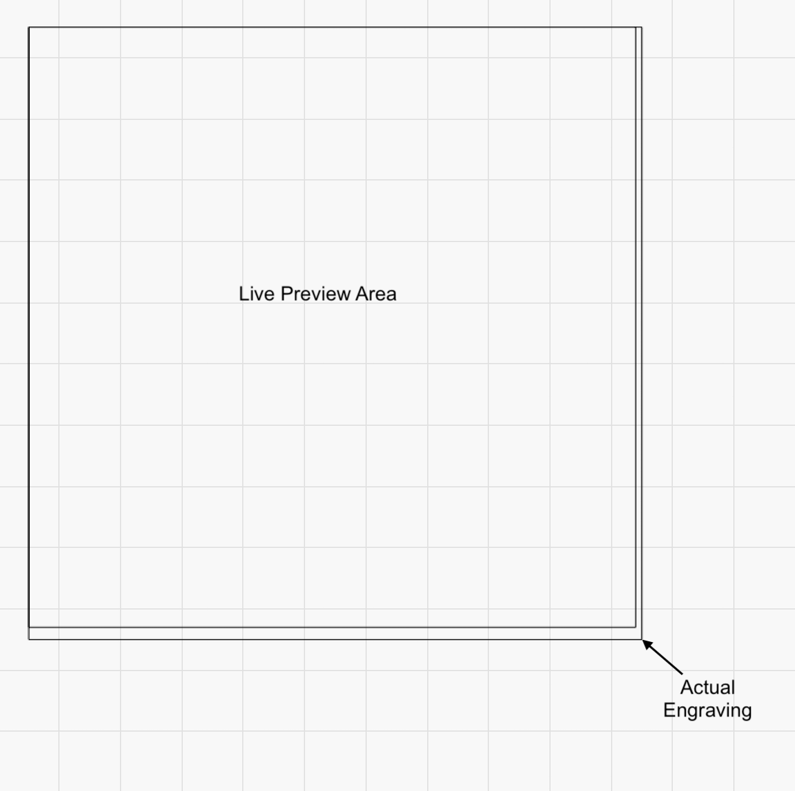

I need to make sure the center dot is actually in the center of the engraving area (75mm X&Y).
I need to ensure that the Live Preview and the actual engraving are the same. Specifically, I know that right now the engraving is exactly 100mm x 100mm, but the Live Preview is smaller by 2mm on the Y access and 1mm on the X access. The Live Preview is also not centered on the engraving, it is indexed off the upper left corner of the square, see the pic below.

The video got my Live Preview aligned with actual engraving. The center dot and dot used for live preview are not perfectly centered, but I think I can live with that.
Thanks again for all your help on this!
