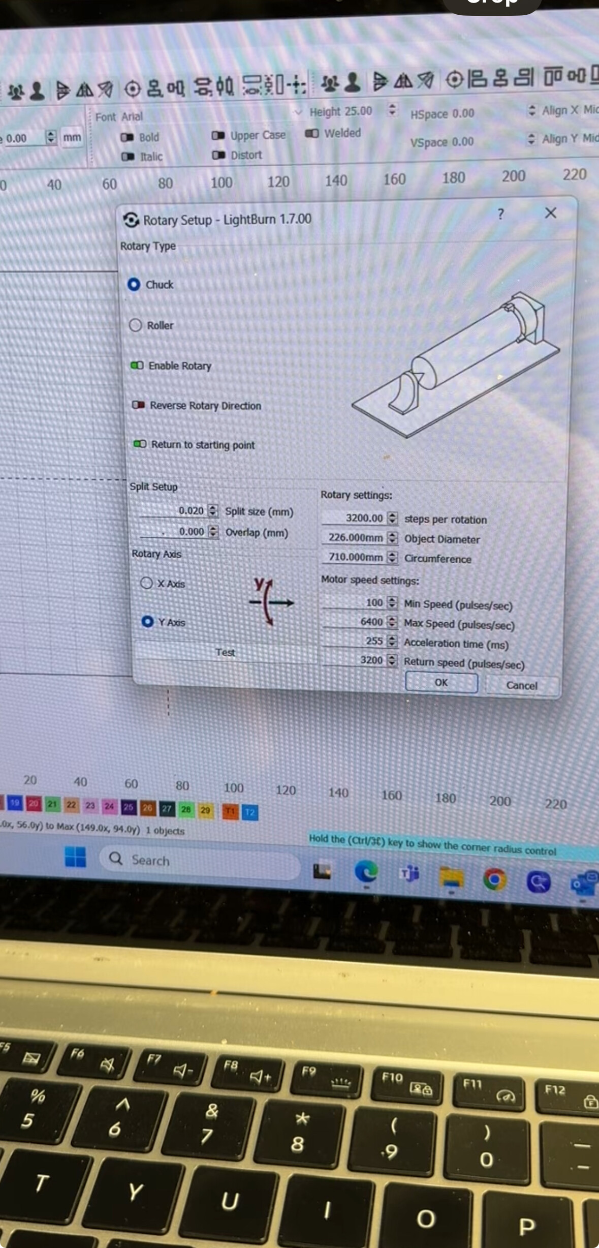

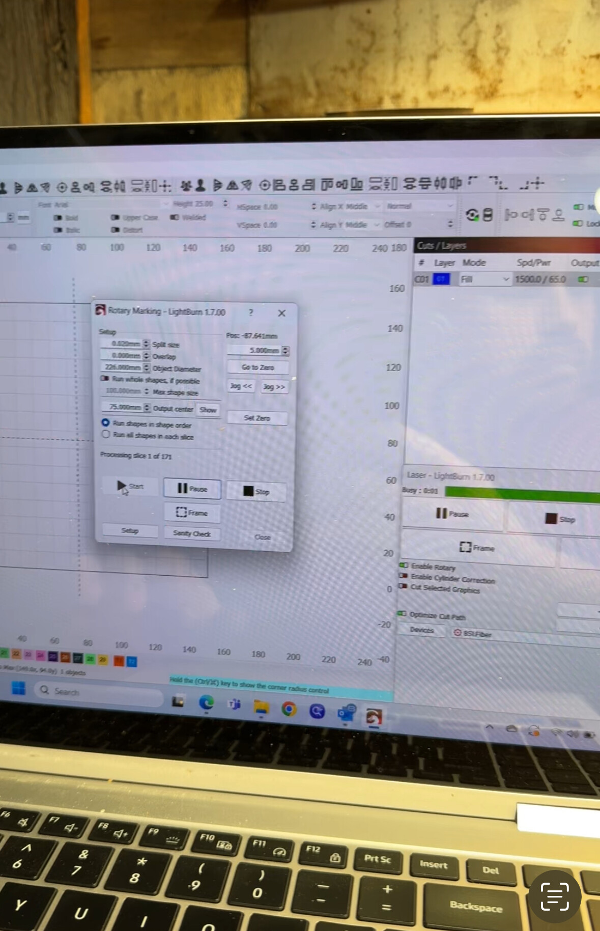

I have installed the 1.7 beta for the G2 and have recently been trying to figure out the rotary chuck. It work as should when in test but when I attempt to engrave the rotary will not turn and just engraves the pattern on top of itself in a thin line. Worked with gweike engineers half the night and they couldn’t find anything wrong with the setting but to no avail.
Is the rotary enabled?
Is it configured for the correct axes in the Device settings.?
The rotary is enabled and I am using the y axis as it’s set up left to right. This is set in the rotary settings. It uses the correct axis when engraving. Just the rotary doesn’t turn with the pattern so it engraves in a line
If the test button in the gui rotates the chuck 1 rotation and back, then it would be setup properly.
Do you mind posting a screenshot of the rotary gui?
Here are all the settings I have looked through.
If you press the test button in the rotary gui, does it rotate one turn and back?
Yes, there’s no issue during test no
If the test works, I don’t know what to tell you… Success with the test button means all the parts are setup properly…

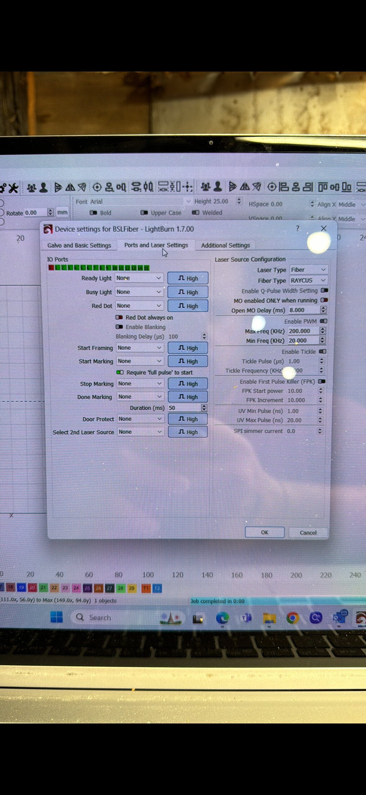

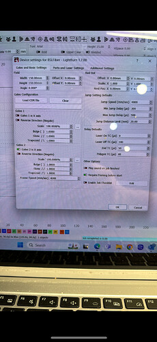

I don’t quite follow, but I’ll take ‘Yes’ as confirmation that the test is fully working as described and as documented.
The GWeike G2 is BSL based and is still in Beta. You’re probably right, I am not willing to make that assertion just yet. :slight_smile:
I have reported this internally to the Galvo Laser team. It’s after end-of-day for most of them but Adam might be on shortly after Midnight EST. Hope to hear back soon.
