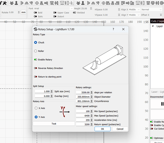

Gweike G2 rotary won’t turn while engraving

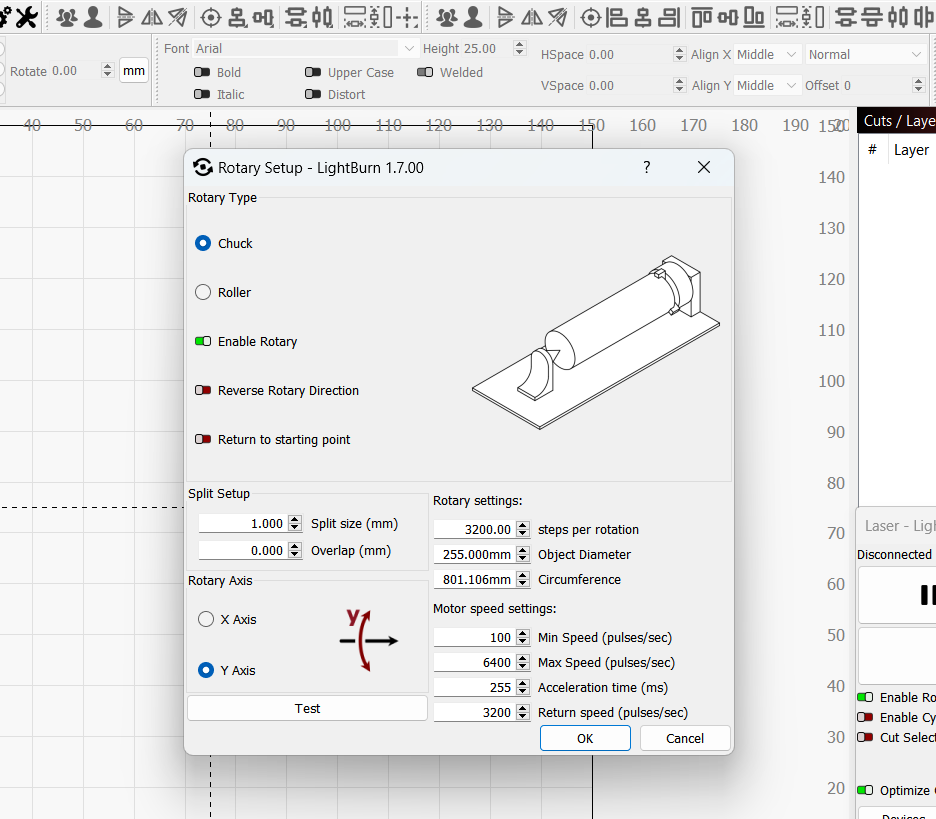

Does it work if you use a larger split size? I just ran a test on my own G2, and it’s all working as expected. The only significant difference between my settings and yours is that I used a 1mm split.
Smaller should work, so I’m going to try your setting next - it’s possible that the tiny split is causing the issue.
Edit: In fact, with your settings (226mm object diameter, 3200 steps per rotation), the smallest usable split size is actually ~0.055mm, and it should tell you that on the screen. It’s supposed to use the smallest split size that it can, so I’ll check to see if there’s something weird happening there.

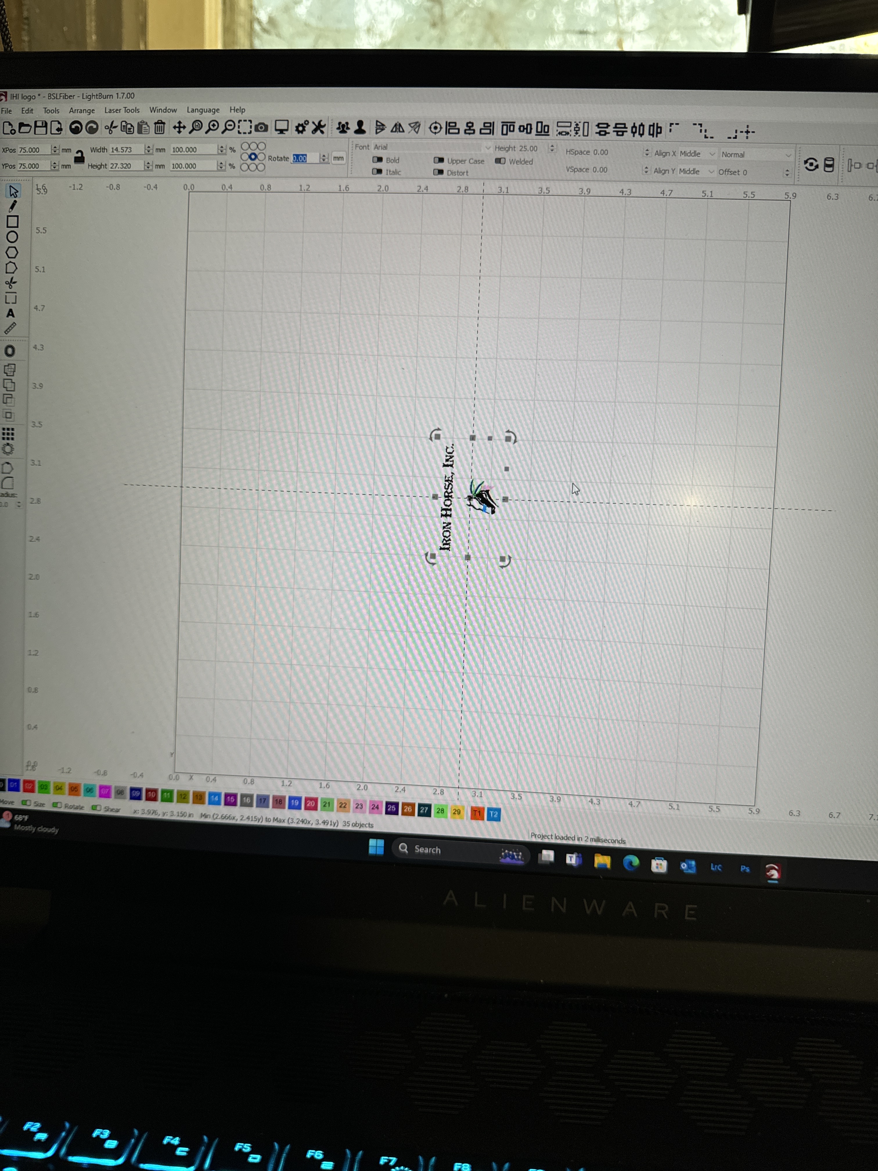

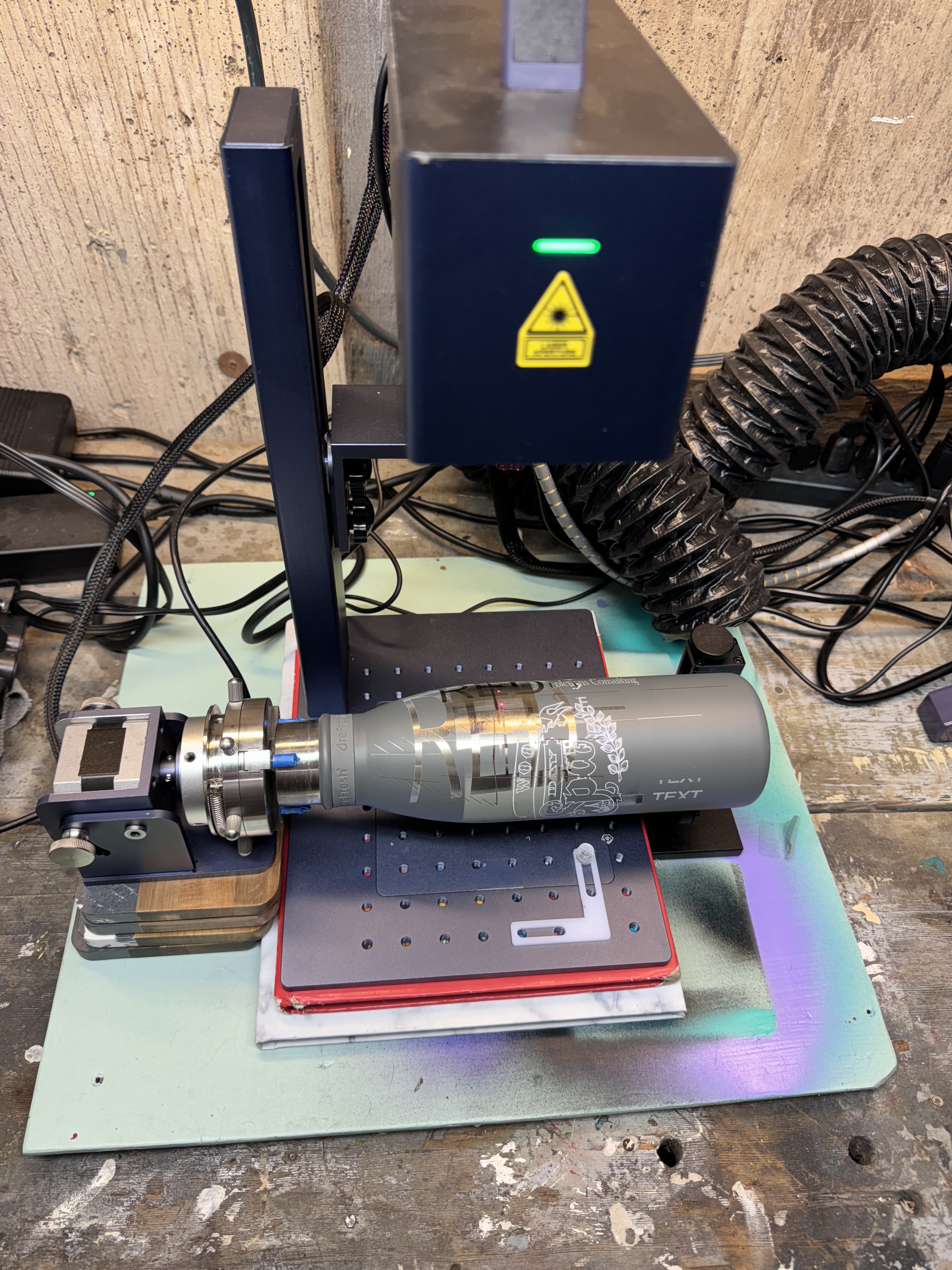

Ok, even with your split setup I’m not having any trouble. Can you show a screen shot of how your design is laid out in LightBurn, and a photo of how you have the rotary set up under the laser?
I tried it with the larger split size and it still doesnt rotate when engraving. Still works fine in test.
I haven’t received a alert about the split size.
If you remove the tumbler and replace it with something very light, like a cardboard tube or aluminum can, does it work then?

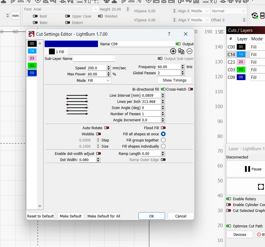

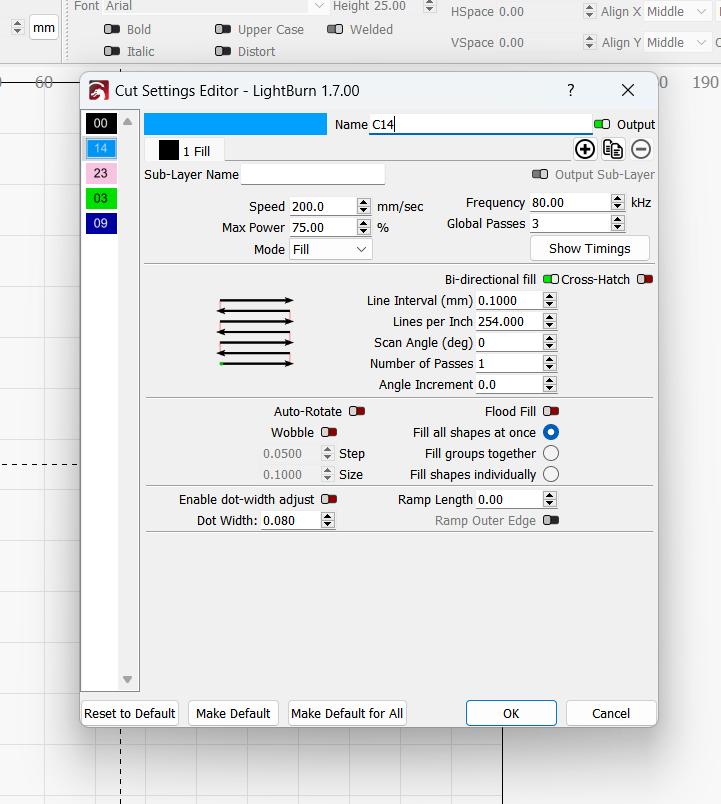

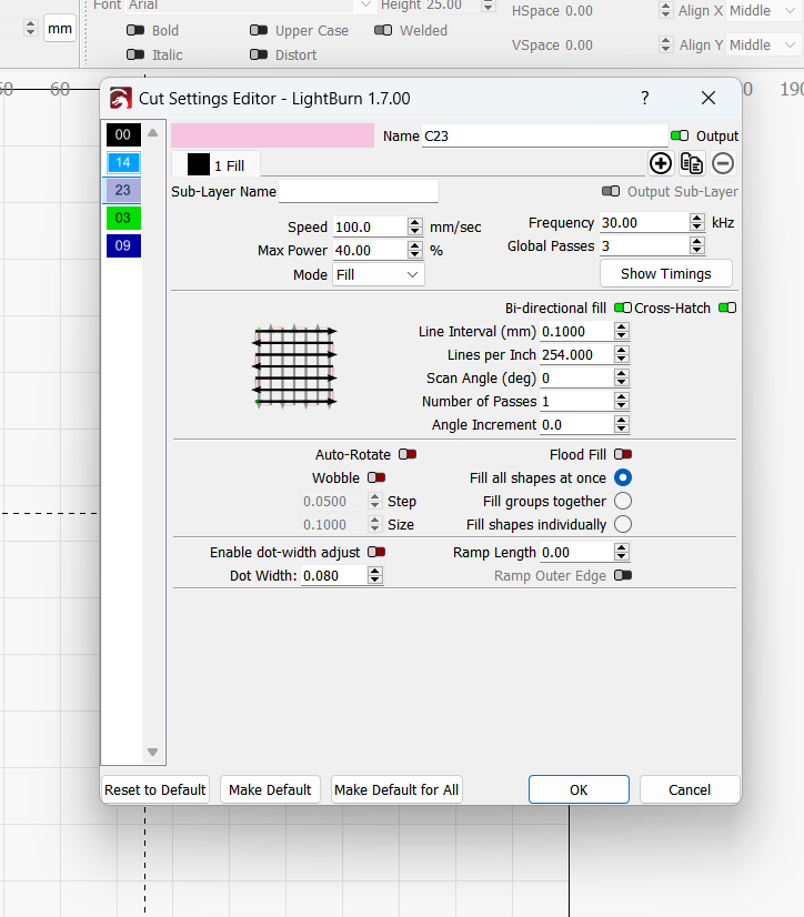

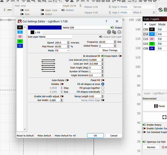

Also, can you show a screen shot of the settings for your layers? I’m wondering if you have repeats or something else set up that could be making a single slice take longer than expected. Have you tried something simple like a filled rectangle?
I have tried a circle and acted the same. I will try a smaller diameter later when i get home.

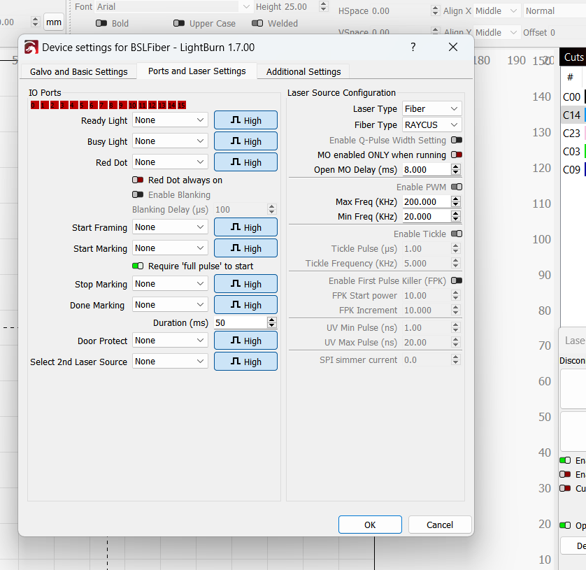

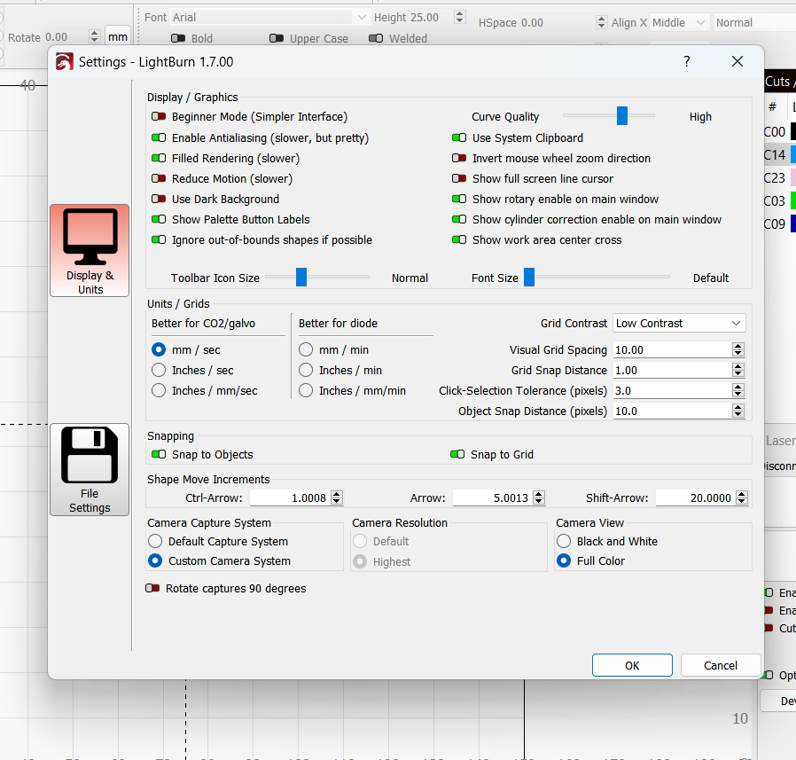

It works fine with Gweike native software and functions fine when i test. I have to be doing something in the settings i would think but i only changed the rotary settings for the steps and acc speed max and min speeds to Gweike settings for this rotary. All software settings are default to whatever LB had from install.

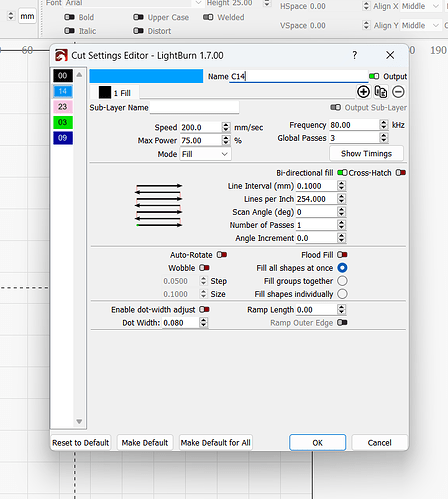

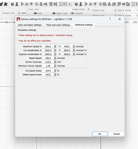

Here is everything I can think of for settings

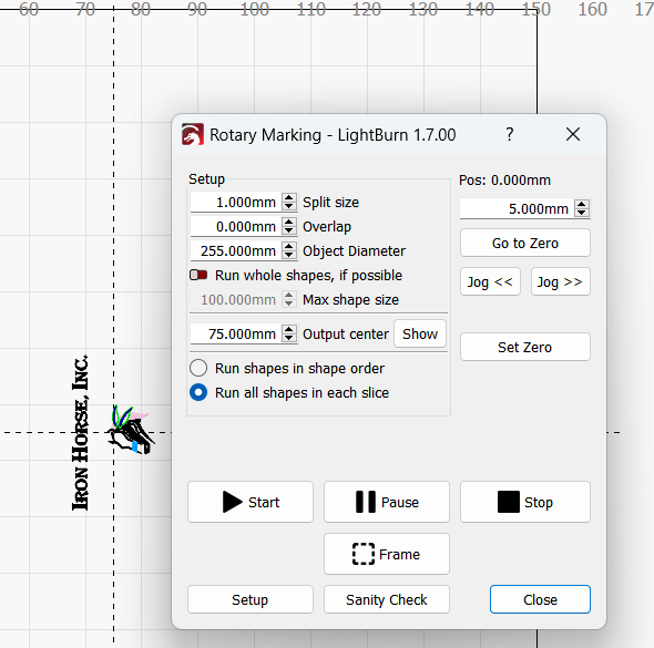

Using cross-hatch on your job is a little odd, since your splits are so tiny - doing that will make the splits take longer, but it shouldn’t prevent the rotary from rotating.
When you run it, do you see the slice counter in the window increasing? It should say “running slice x of y”… and the ‘x’ number should be increasing. If it is, and the rotary isn’t turning, then something’s up. If that number isn’t increasing, then something else is going on.
Yeah i noticed the cross hatch when i screen shot this. I fixed it now. I do see the slice counter as i should.
