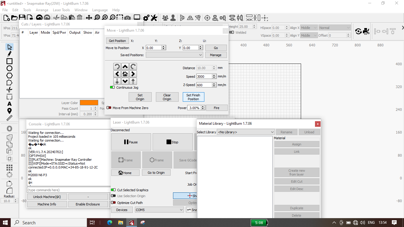

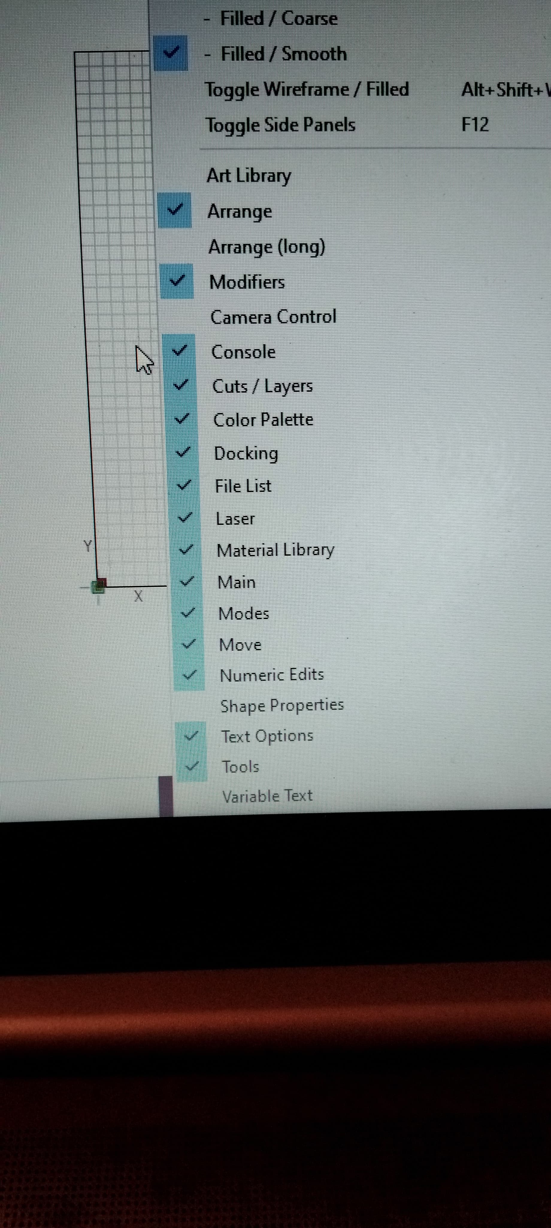

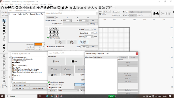

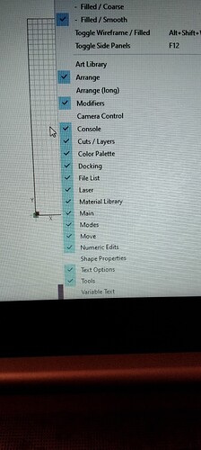

I was trying to use the macro function but it does not appear to on the list in the dropdown box under Window.

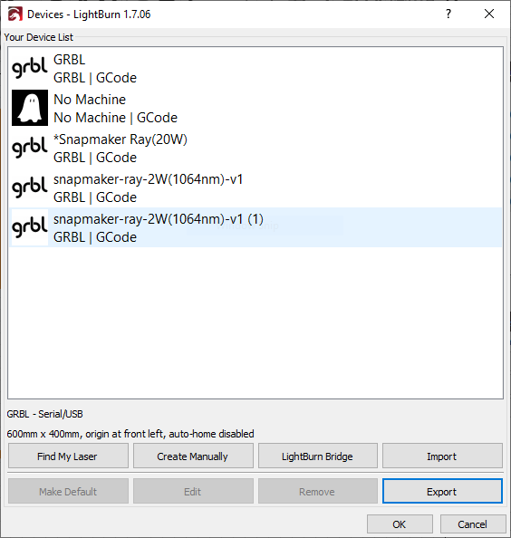

I do have grbl device selected:-
I cant do a screenshot of the dropdown box for Windo, as the dropdown covers the snip tool..but Im certain that macro is not there.
Any thoughts.
Its behind the Cuts/Layers window on the main screen

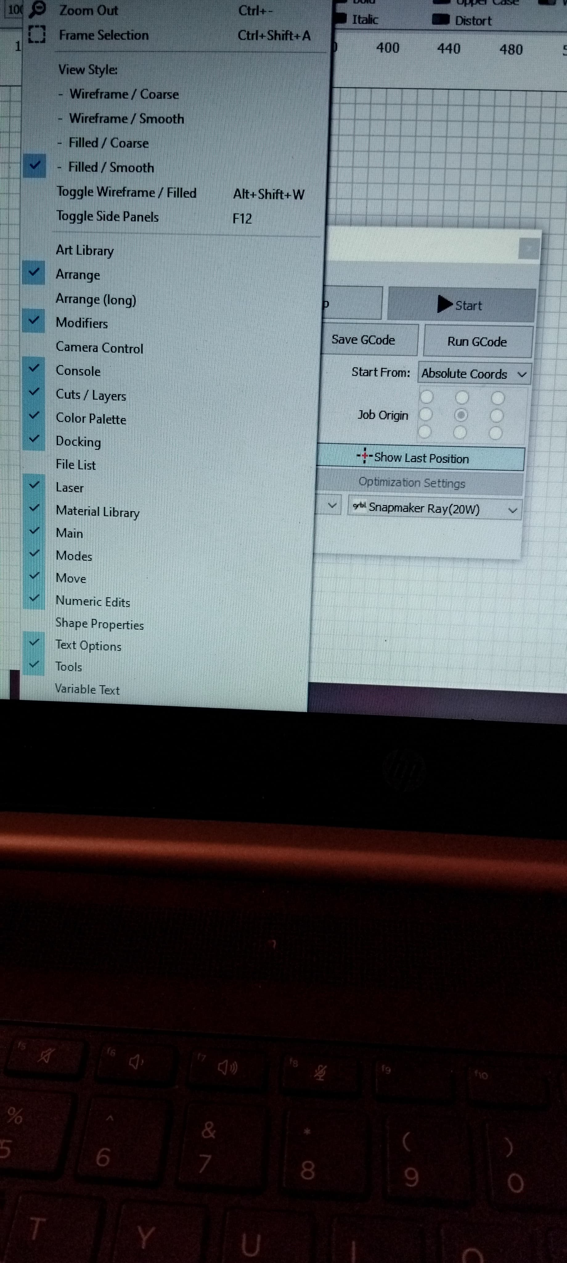

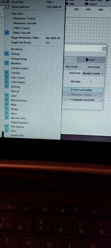

I just dragged them all left, but I see no macro
Also, I moved the main screen to the right so I could use the screenshot tool but Window dropdown box disappears when I do that.

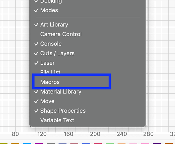

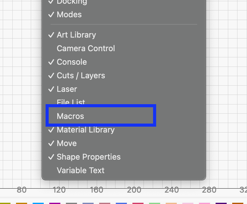

You need to enable the macros window. Window Menu> Macros.
Hi Tim
It appears that Macros aren’t available for that device profile. Switch to your 20watt and see if they’re there.
Same thing
Interesting. I have no idea then.
