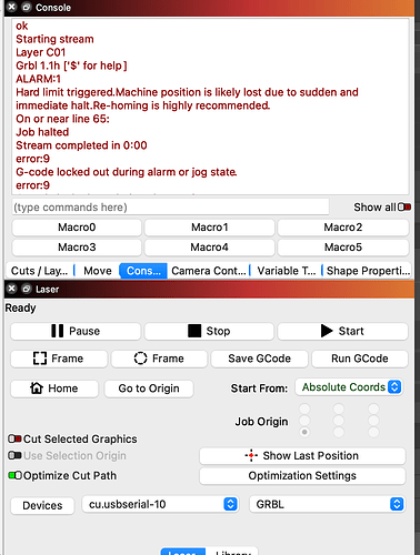

I’ve just been setting up a TwoTrees TTS-20 Pro and followed the ‘first project’ Lightburn tutorial. Everything seemed to be going well until hitting start! At that point I started to get
ALARM:1
Hard limit triggered. Machine position is likely lost due to sudden and immediate halt. Re-homing is highly recommended.
On or near line 65:
Job halted
errors.
Reading through these forums this seems to be related to the laser hitting my X Axis stop. I’ve checked that I am using Absolute Coordinates and I’m really not sure what the problem is. I tried removing power from the X Axis stop switch but the laser head just moved left and right and didn’t output any laser beam (I’m hoping that’s because the stop switch was unplugged, but I’m not entirely convinced…).
Please see below a couple of screenshots of my settings, and here is a YouTube video showing what happens. Any help very much appreciated!
What happens when you go from frame to start without homing?
Thanks @Dskall - if I do that it just slams itself back to home and triggers the switch.
Do your jog controls work and move in the right directions?
Yes they do. I’ve actually just had a breakthrough - it was overscan set to true on one of the layers. With this enabled it kept triggering the switch! Turning it off has solved that issue. Now I just need to work out why the laser isn’t firing!

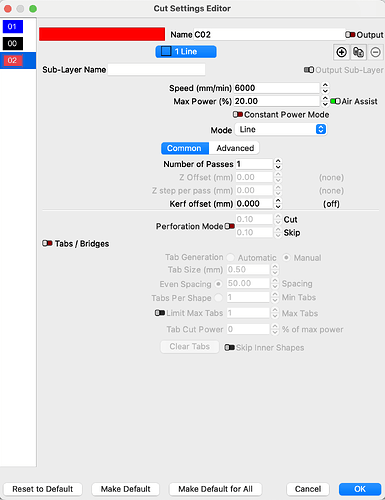

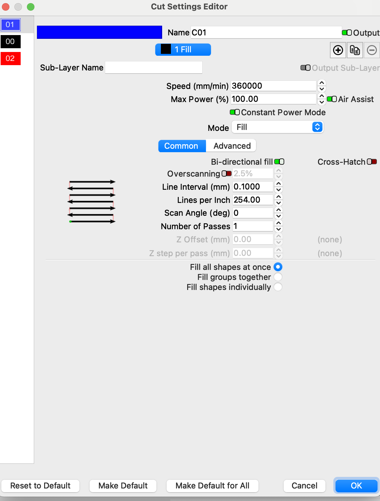

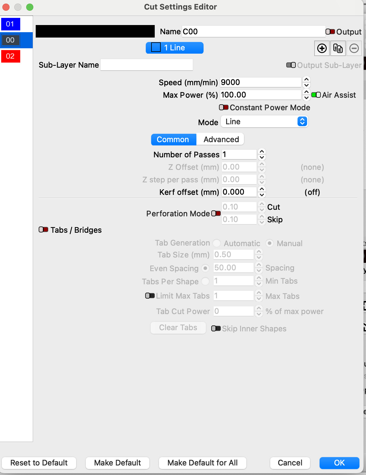

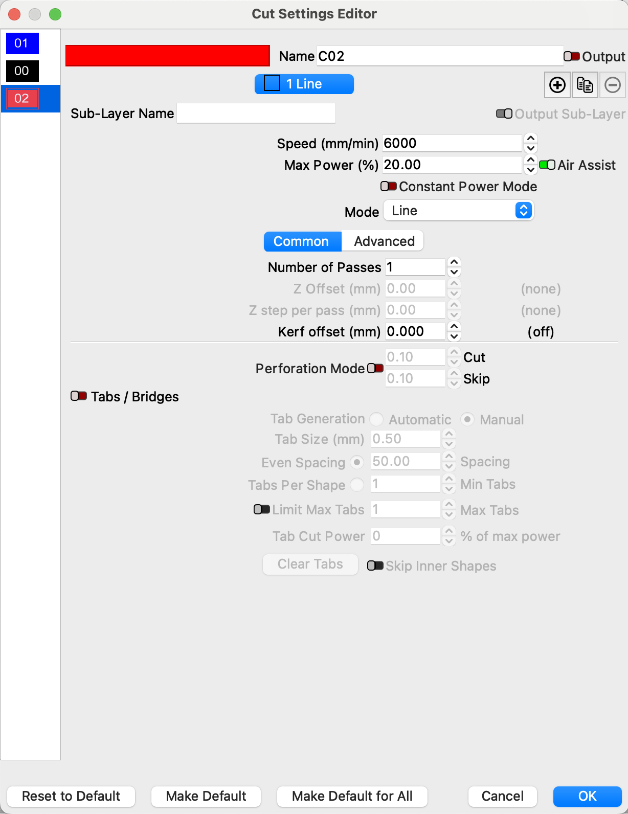

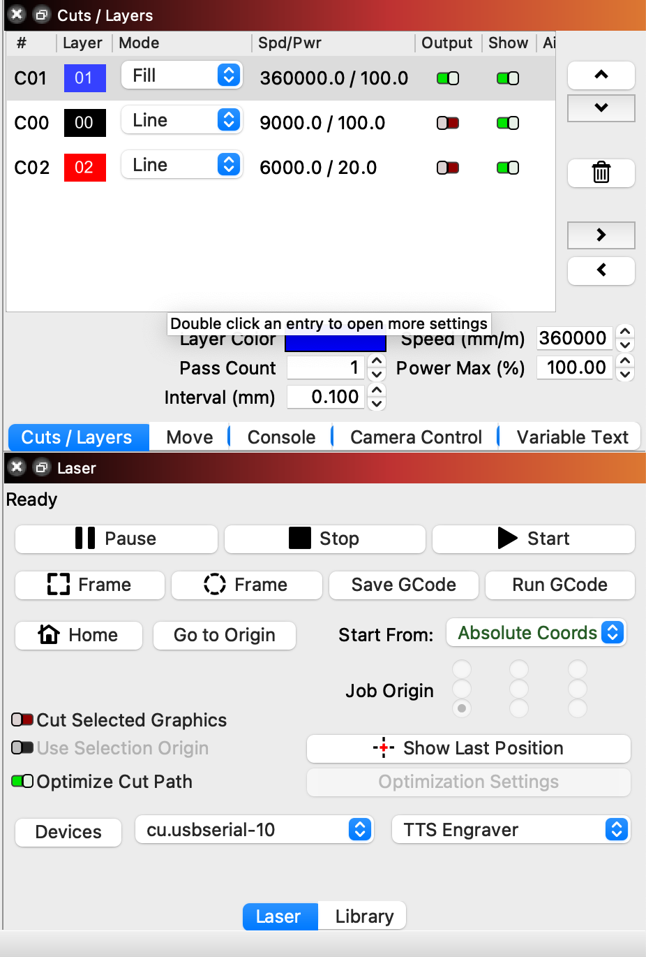

This (and the full run) outputs a blue dot, but it makes no impact on the ply board. I’ve tried differences focus depths but no difference. My layers are set to output, and for the time being the power is set to 100 with a reasonably slow speed. I guess I’m missing some power override setting somewhere perhaps?
Can you screenshot whole area with cuts/layers and go to console and input $$ and paste results.
Sure - here are screenshots of the panel and then some more detail for each layer.

360,000 mm/min?
May want to slow that down a lot.
3600 maybe?
Yeah I just noticed that too! I think that is a recent typo from playing with settings trying to get the laser to work.
