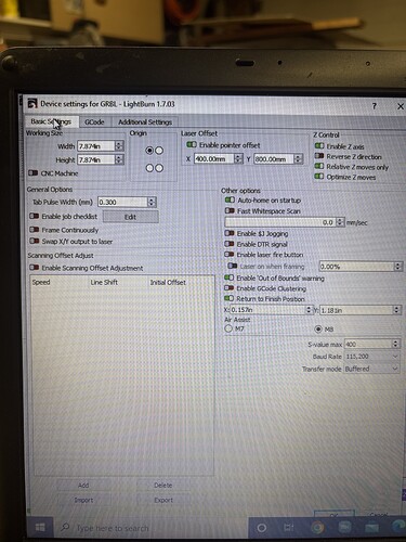

Not to be snotty sounding, but you’ve tripped a hard limit. We’ve all done that with grbl machines.
This may help us get started so we can help you.
No snottiness detected. I’m actually helping a friend and should probably let them explain. But I did trip it, how do I fix it? I’m on windows 7 Sony e series

Do you have the proper machine origin in the device settings?

Oh and I’m running light burn 1.7.03
This is what I get when I fire it up

@Cleadley, it seems you are having, for the most part, motion issues.
Alarm 9 means your laser isn’t touching the switches correctly
Alarm 8 means your switches were touched but the laser was not able to pull back from the switches
Alarm 1 means your switches were touched while laser was in an engraving
So all tells me that something in the overall step-up of the laser is not accurate
A video of the laser homing (from the centre) would be ideal, maybe you could record and upload to youtube and share?
But if you lack a video, can you take a handful of pictures of the laser, especially the belts?
