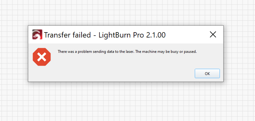

I have just attempted to send a cut file across after updating to 2.1
As soon as the file Transferred into the machine. The machine jacked the bed lead screws up smashing straight into the laser nozzle. I hit the power button just after it hit.
Since then. I have had to reset the machine over and over again to get it to reboot and actually load the display screen.
And when it does finally go through its power on test and calibration. Its like something in the software/controller is continually trying to push the bed up button over and over repeatedly.
If i hit the menu button fast enough time, it will enter the menu screen which seems to stop the continous button pressing, but as soon as you exit out its back to trying to lift the bed out of the machine.
I dont even know where to start to try and diagnose what LB has sent across into the machine that would cause this kind of behaviour.

Do you control Z-Axis with Lightburn? It is probably not on by default unless you enabled it from Edit > Device Settings
You may want to check all Z-Offset and Z-Axis related controls (settings and layer settings) inside the file you’ve sent to the controller.
I doubt it is a software related issue but either a physical button or the Z-Axis motor should have got stuck in your machine. If the buttons are not physically stuck, the machine may be trying to home the Z-axis to a wrong homing coordinate - if you suspect Lightburn was the issue, this behaviour cannot be created with sending a file; the only way to send wrong Z-axis home coordinates to the machine is by setting it from Manufacturer Settings and it should have triggered few warnings before doing so.

I have been able to stop the constant Z Up from occuring by installing LB 1.7 (what I upgraded from)
However LB will not allow me to send any files across to it any longer saying the machine is busy or paused.

I am now left with the machine controls functioning ok, BUT. Lightburn is reporting the machine is paused or busy therefor I cannot send any files across to test it or use it.

As soon as it sent its first file across, the machine became unresponsive again. Constant errors saying machine is paused or busy.
When I try and enter the file system on the controller screen it gives me an error stating incorrect file type, which seems to put the machine into a crashed state until you power cycle the controller and open it back up again.

It seems as though any file sent by lightburn now, even though I have tried reverting to 1.7 and 2.1.
Just stops the machine from responding and puts it into a busy or paused state.
A local laser tech recommended reloading The controller configuration across from the backup usb stick which I’m going to try and do. He seemed to think lb had somehow effected the config part of the controller.
