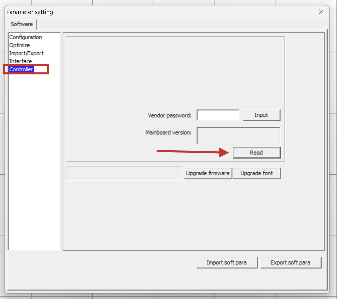

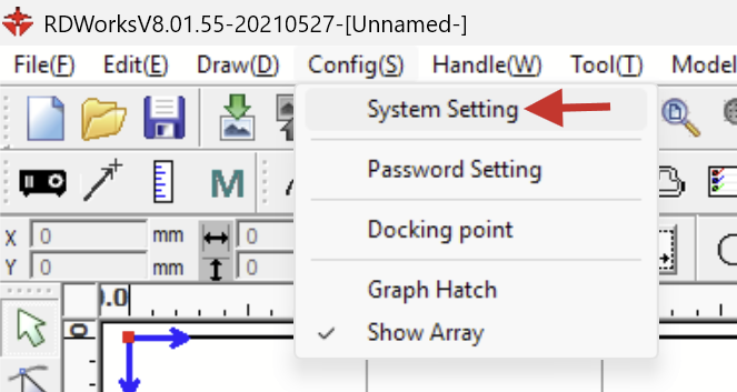

In RDWorks, that’s:
If you could first click ā€œReadā€ and let us know the current firmware version, that might help us assess the situation.

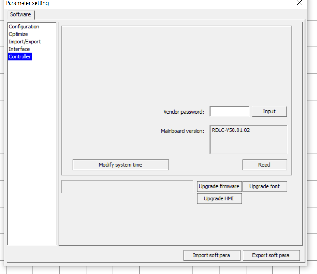

Hello, I bought my 8445s just two months ago, directly from China, and it is running version RDC-V50.01.07. It makes no difference whether I use lowercase or uppercase letters; it converts them to uppercase, and there are no issues whatsoever. I can’t say whether it behaves differently with older versions

@kersten_k thank you for confirming the firmware version and that uppercase filenames aren’t an issue with this version.
@DieselTuner Please check the firmware version of your controller with RDWorks and upgrade it if possible. (According to the RuiDa forum, the Vendor password is: RD8888)

Kersten has a newer version RDC-V50.01.07 installed.
Upgrade the firmware, and please report back.
As a safety measure, select ā€œExport soft paraā€ to back up your settings before the upgrade.
