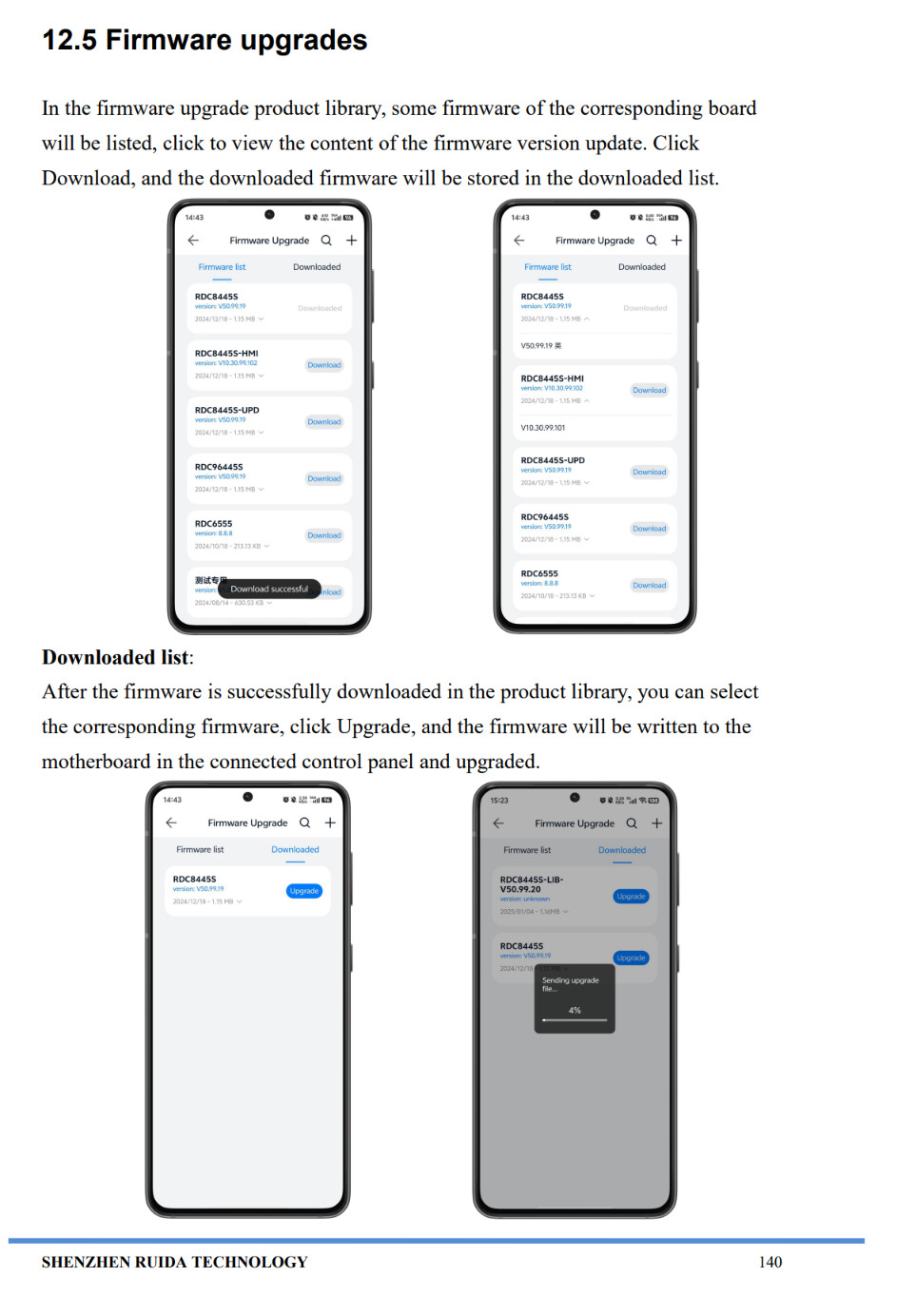

take a look at page 148 of the PDF
It looks like Ruida recommend updating via their Mantis app

I have received the latest firmware from Ruida RDLC-V50.01.08. Sent the update through RDWorks without issue.

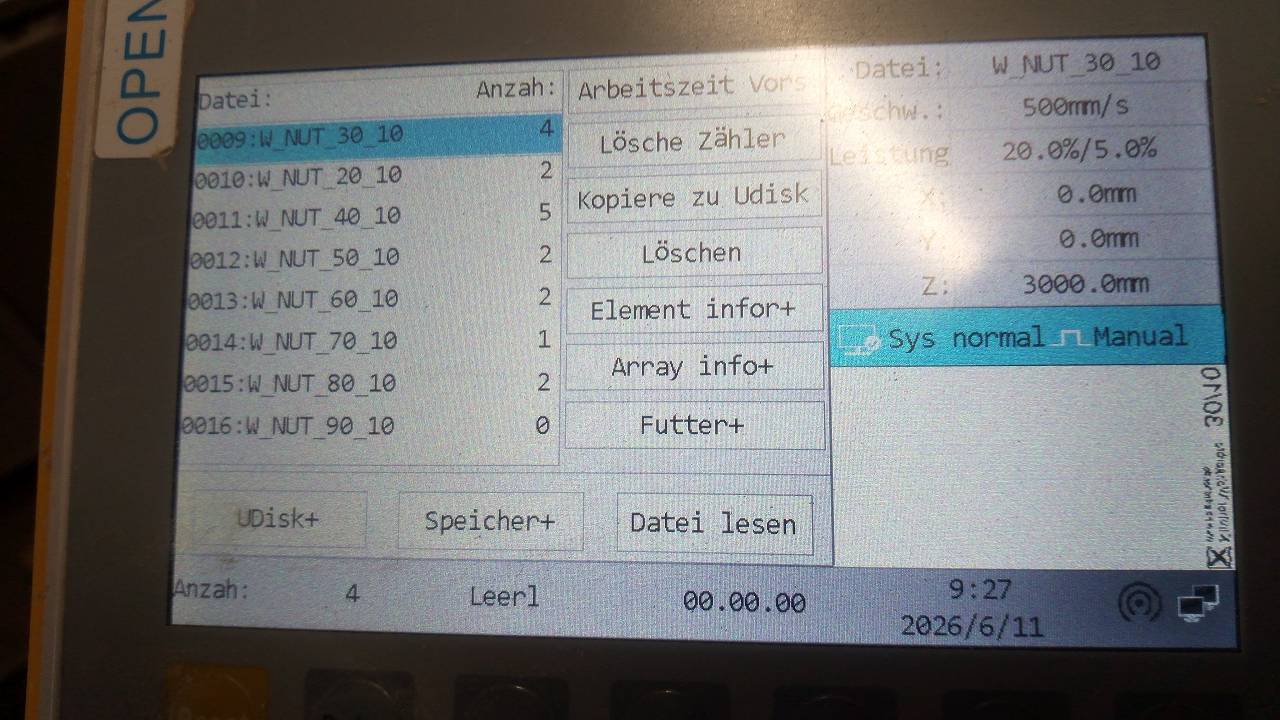

Maybe this helps. I can manage the files on the controller directly from LB and add new ones whenever I want—it always works. I currently have 35 files on there that are ready for use. Since I do serial production, I need to access these files repeatedly without a PC. As you can see, I use underscores to replace a folder system; this allows me to assign data to specific jobs, and it works perfectly.

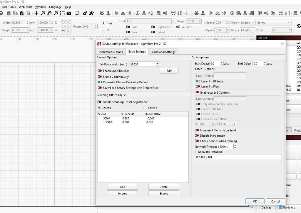

I had the same problem; we used that program to check if the IP address was actually free—it wasn’t—so we changed it, and then it worked. https://www.advanced-ip-scanner.com
Ok, that’s a good clue - I have an 8445 here so I can poke at this and see if there’s something messed up in the auto-delete on duplicate name.
I managed to get the machine to talk to the network again by issuing a static IP to it from my firewall and matching that IP in the controller.
Now that its communicating over ethernet, the overwrite error no longer occurs. So it seems that particular issue is usb related.
