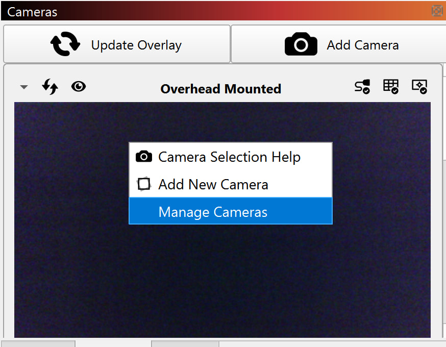

If you have more than one camera connect only the camera that you´re using for your setup.
Right-click the in the Camera window:

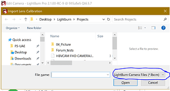

Then try importing an older camera calibration/alignement:

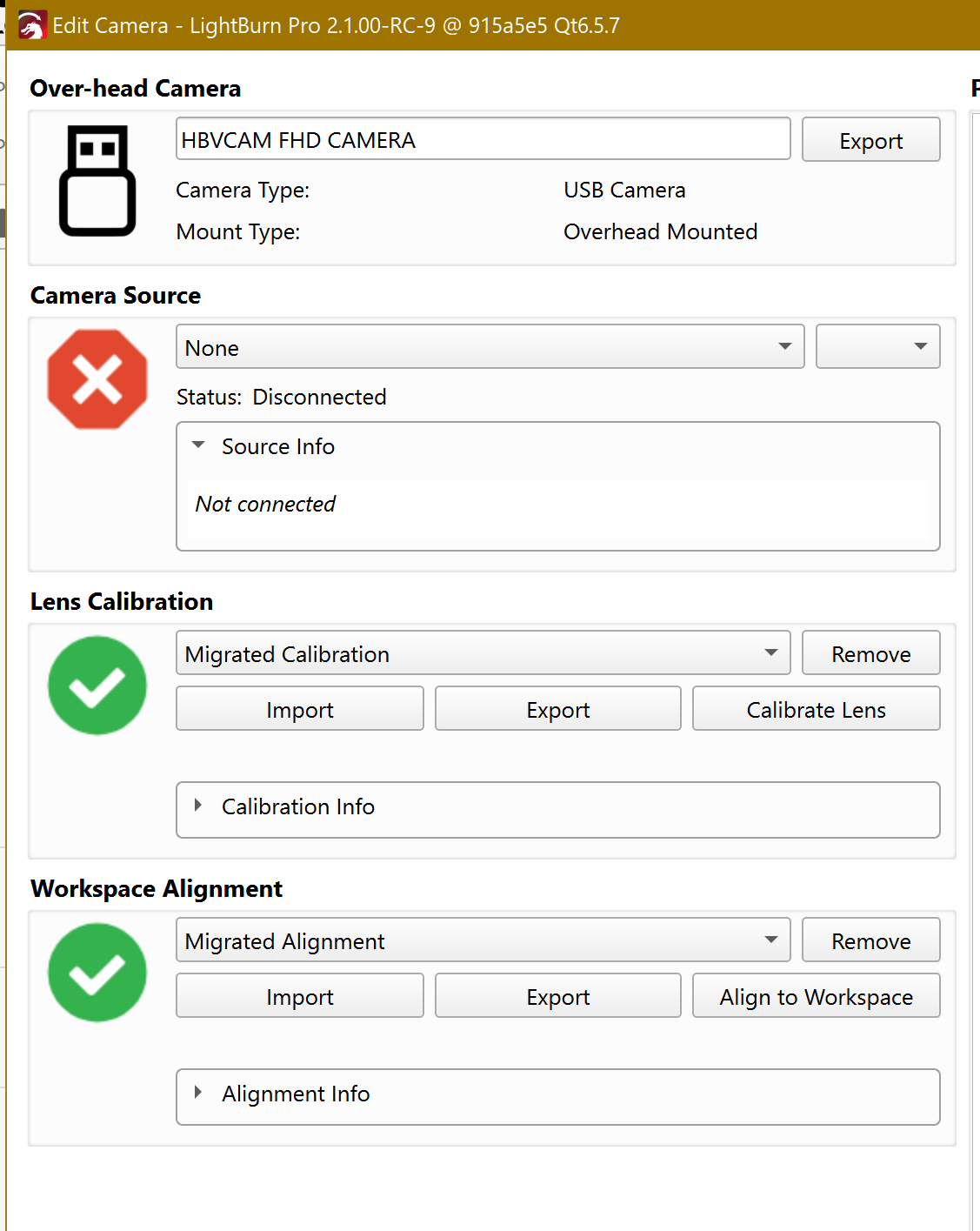

I only have one camera, it is selected..

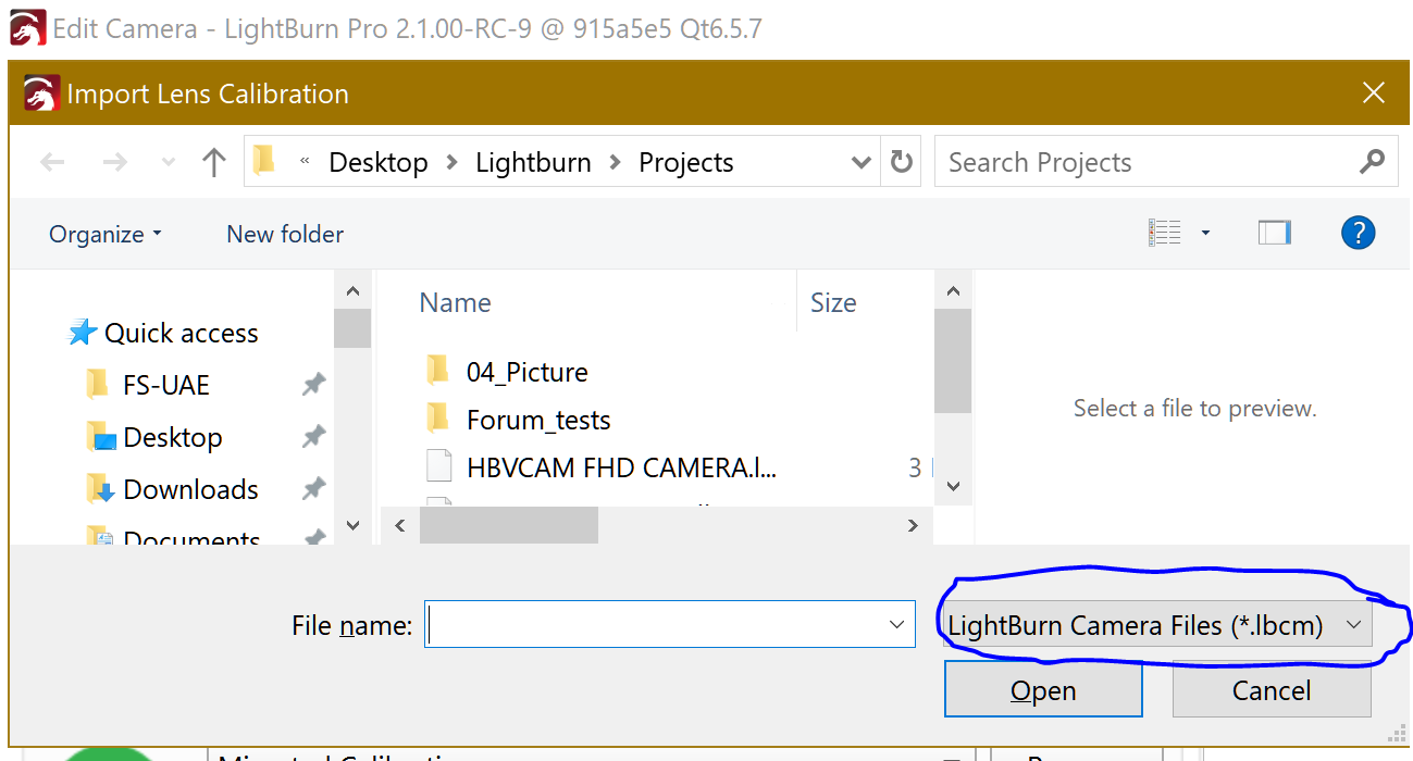

When I try to import, it just brings up all files.. It does not show me where the file is?
Do a search for .lbcm
You can also try exporting from 2.0.05 then importing into 2.1.00.

Since 2.1 is NOT an official release version, but a pre-release, it gets installed in parallel to 2.0.05. You will have both versions on your PC when you installed 2.1.
