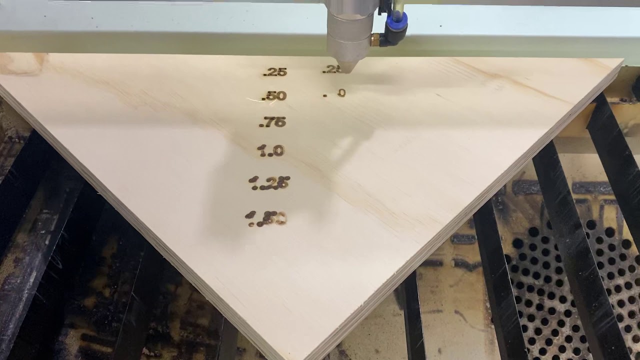

If you have a motorized Z, you can out focus Z roughly 10 to 20mm on a vector line increasing its width substantially. With the correct speed and power (cardboard or paper is going to be really fast speed and low power) you can remove a small amount of material without cutting though. All this requires is experimentation, your time, your machine, and your materials.
Here is an example of out-focused Z at various distances:
Also, I just so this posted:
I would recommend using a line in ‘Perforation mode’. It makes dotted lines, and it’s intended for this.
You set how long you want it to cut, and how long to skip, and it generates a dashed line when sent to the laser. You can see it in preview too:
I prefer the method I suggested for box making. And…. here is a demo :slight_smile: (I know… another demo)
