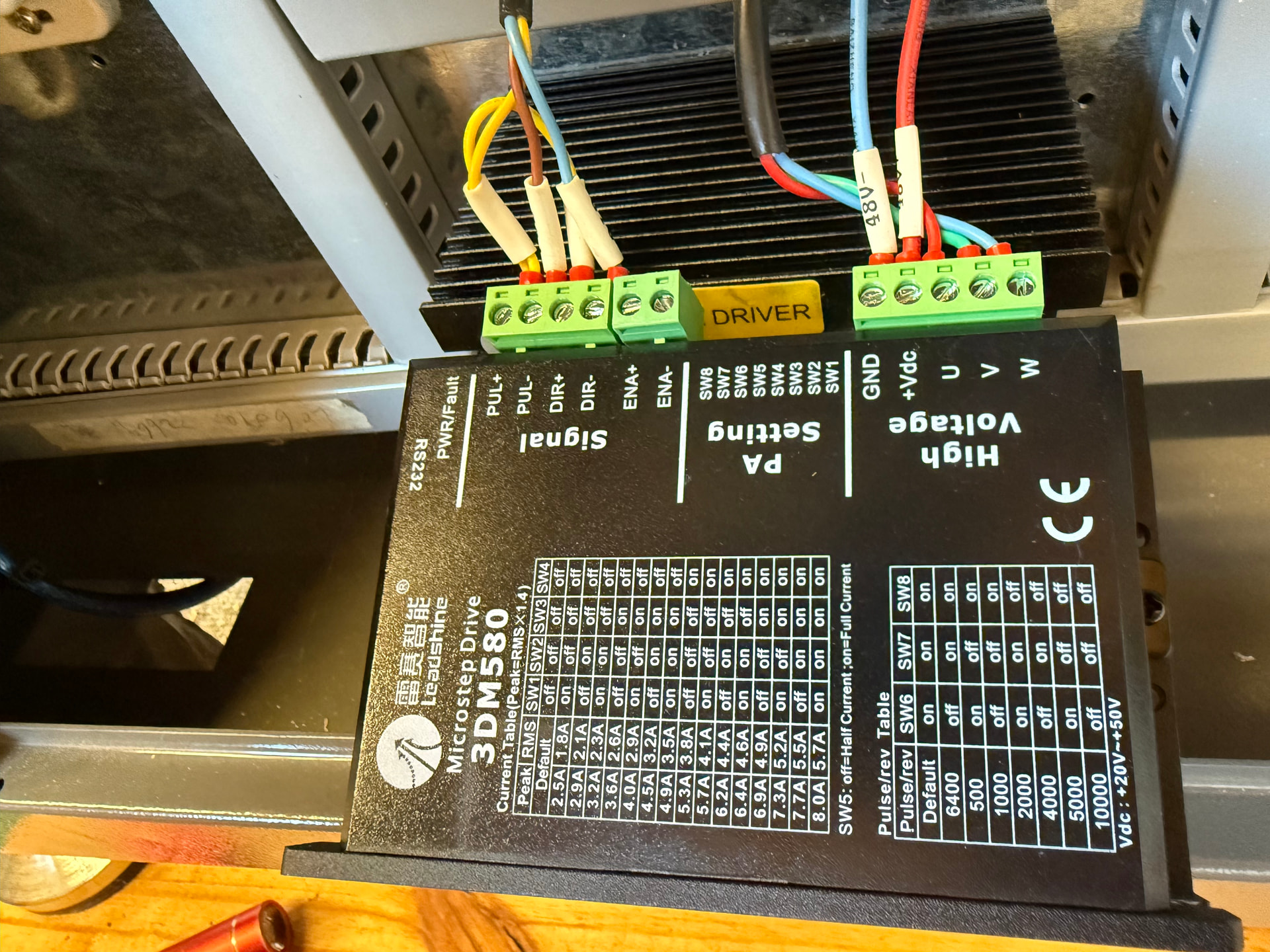

I have a GWeike lc6090 100w laser which has been working perfectly. I tried to install a homemade rotary attachment with a 2 phase Nema 17 stepper not realizing my laser has 3 phase drivers. OUCH! I have since replaced the y axis driver with an identical driver and dip switch settings. Now on boot up the laser x axis homes to the right as normal but the y axis crawls very slow to home and returns only a couple of inches. When I request the ganrty move 100mm in the y direction on the computer (Lightburn 1.6.03) it only moves about 10mm and very slowly. (as if it’s moving 1/10 the steps and 1/10 the speed). No software setting have been changed. My machine has the Ruida RDC6442S controler. No wiring or connectors show any signs of heat damage and I’m getting consistant ohm readings across all of the y axis stepper motor windings. Does anybody have any suggestions

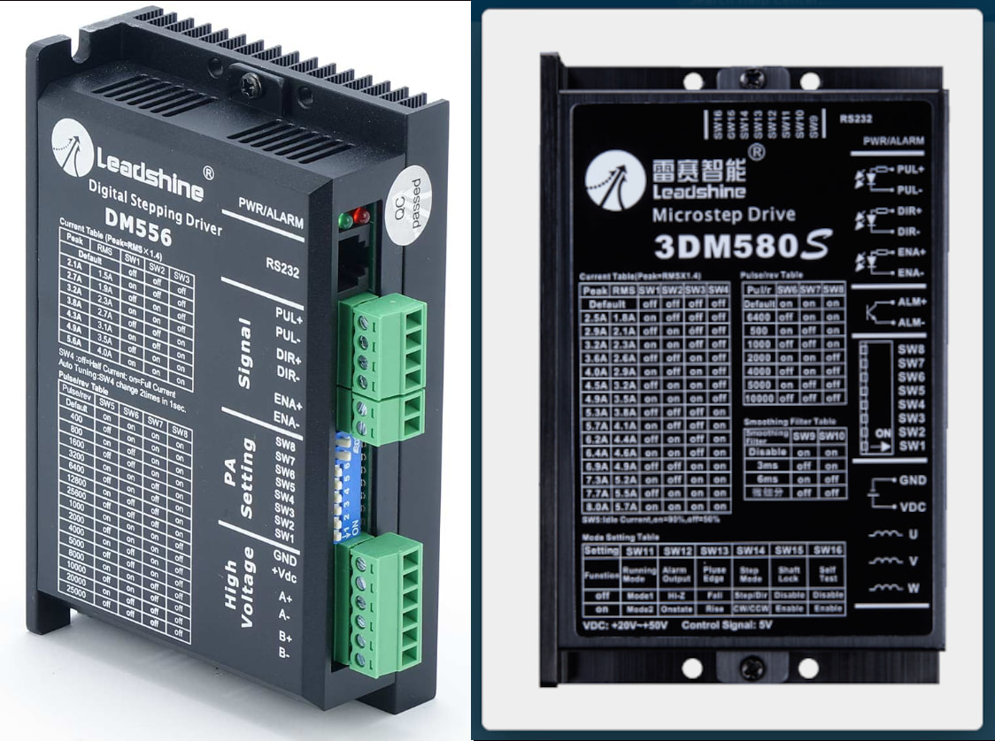

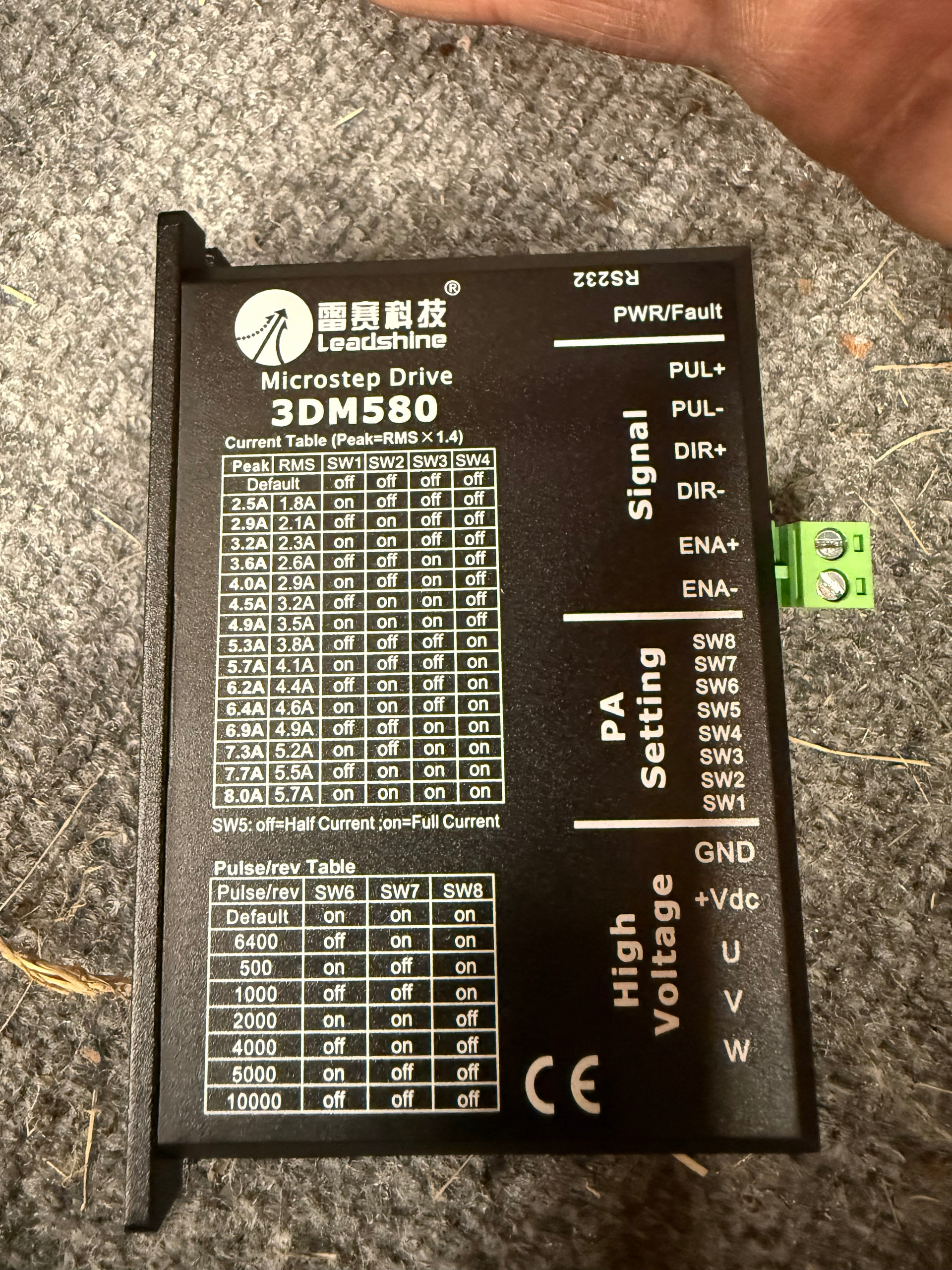

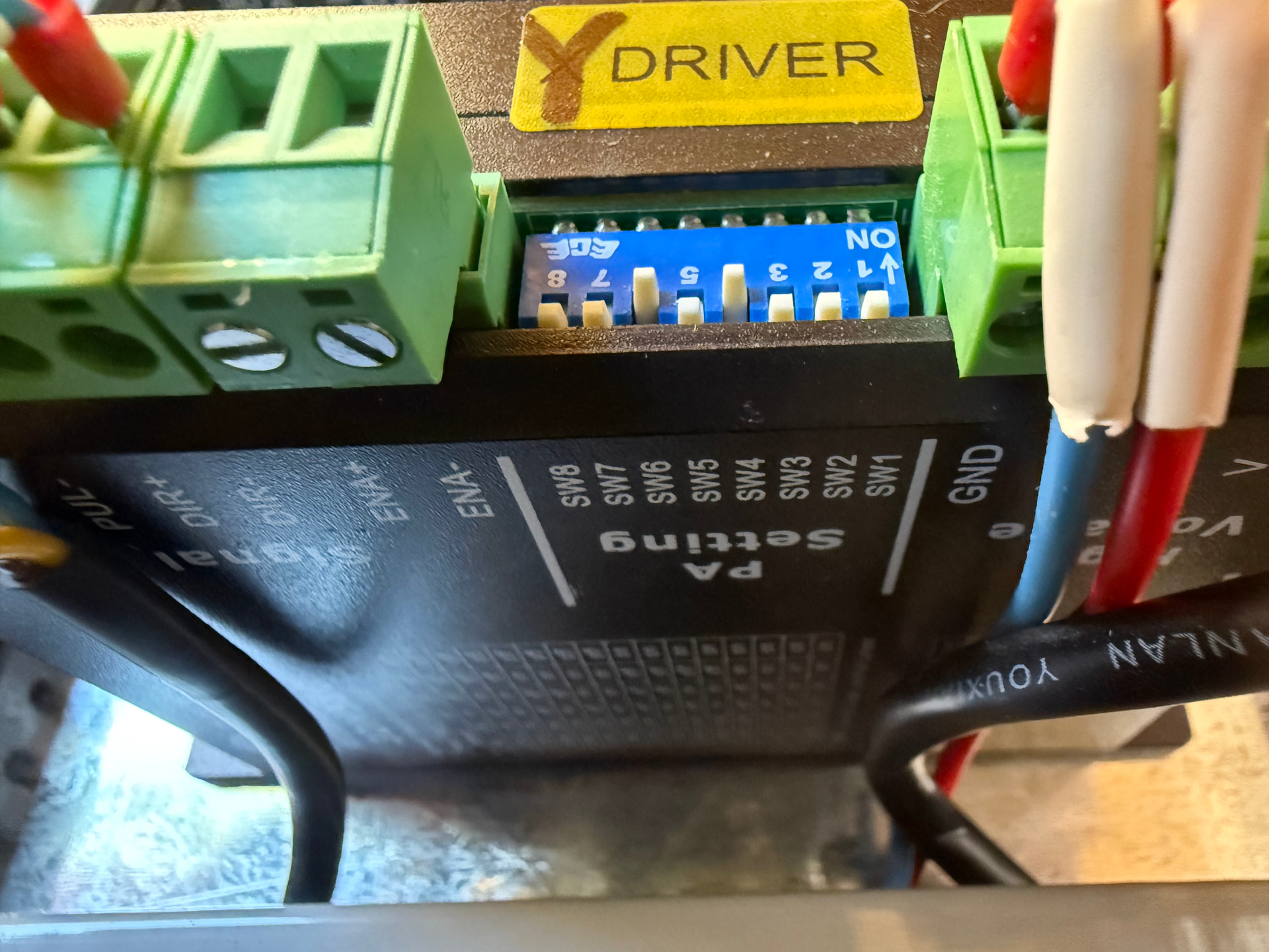

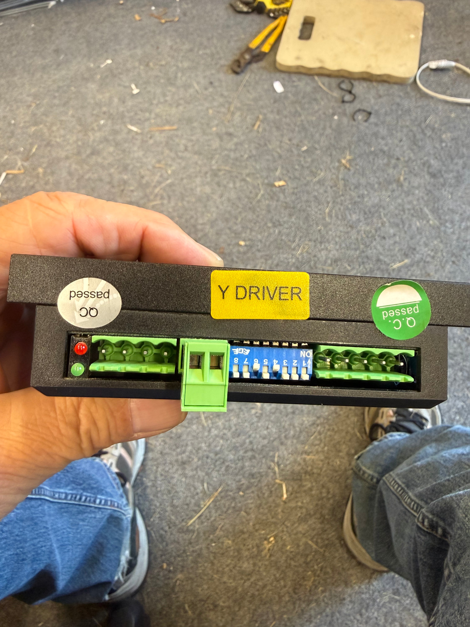

Can you post pictures of the “damaged” and the new drivers, front and dip-switches.
Image 1295 and 1286 are the “damaged driver”, Image 1300 and 1304 are the replacement

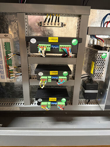

Check if the X driver is similar, pay attention to connections, switch X and Y drivers and test.
I have not removed the x driver but I see it is larger so I don’t know if I could swap them. I would be willing to reorder another y driver if it is still suspect.
Generally speaking, motor drivers are pretty tough. The output section could be damaged, but I don’t know how you’d wire a 2 phase motor (4 wires) into a 3 phase driver (3 wires). Like what did you do with the extra wire? That should have been a tip off.
As you can see they have a different label and output nomenclature.
If you did fry the driver portion, they are usually optically isolated from the machine. This means it’s very difficult to to damage anything upstream, so to speak.
Have you wired this up to the rotary, using 2 phase motor after replacing the 3 phase motor driver?
Sounds good, but in this instance I don’t know if he knows what damage has been done. You can also see the outputs have different pin nomenclature. I think a few minutes on the Internet could have prevented this.

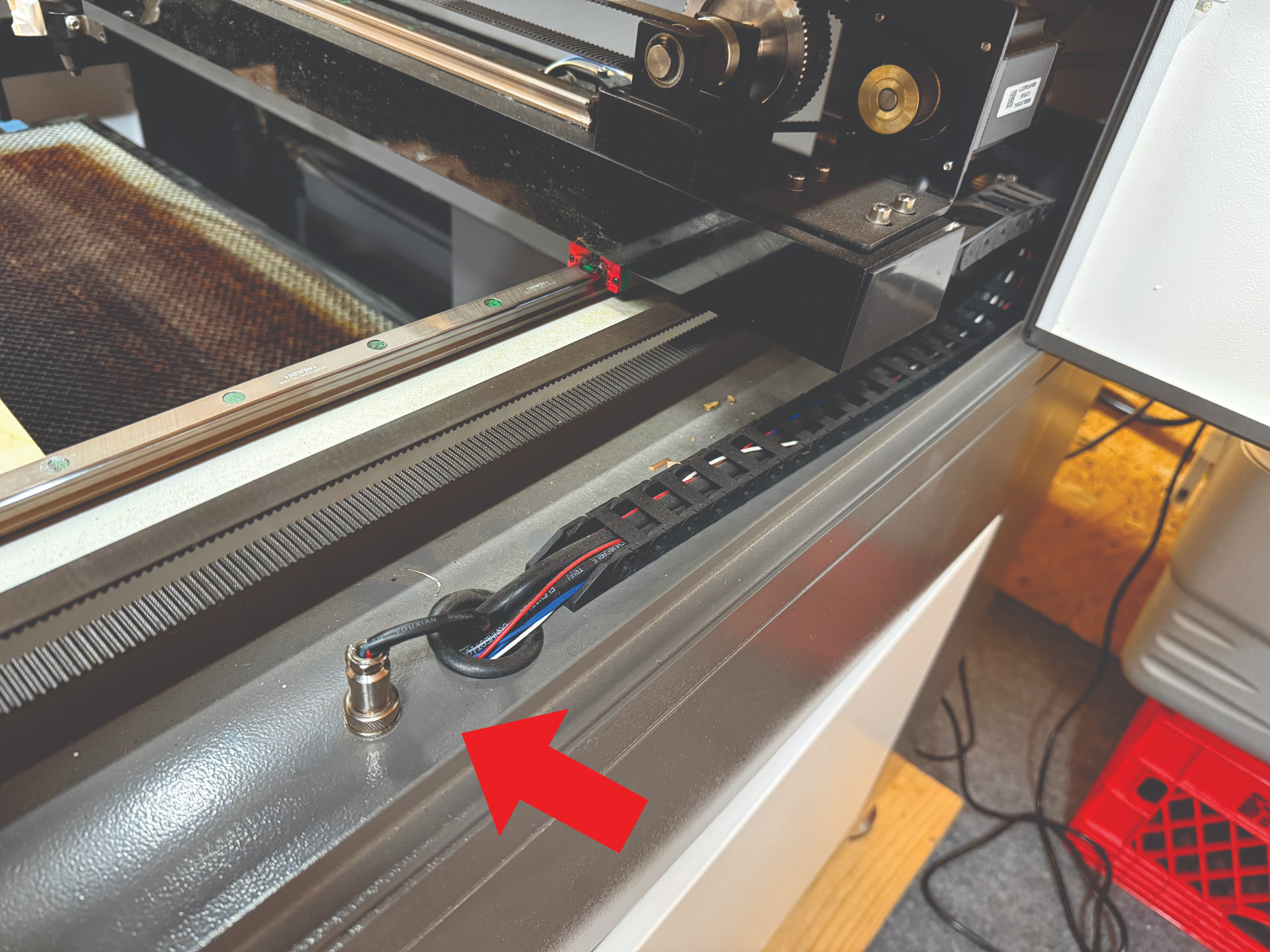

I had a customer pushing me for a sample so in my hurry I connected a rotary to the 4 pin avaiation plug inside my machice “assuming” it was for a rotary. I did trace it directly to/from the Y driver to the y stepper. It wasn’t until after the fact that I inspected the terminations and realized there were ony 3 wires attached to it. I’ve been kicking myself so much I can’t sit down anymore.
I do have a DM556 driver which I will use if I ever get past this. The rotary has never been attached to the replaced Y driver so I believe it should be ok, I don’t know what else to consider except the controller. I’m just not sure what to do next except replacing stuff.

Some large / fancy machines have a 36 V power supply for the steppers and a 24 V supply for everything else, including the controller. If the steppers run from a different power supply than the controller, it’s possible the stepper supply had a heart attack.
The red and green LEDs on the stepper drivers indicate their status: if the green LED is Off or the red LED is On / blinking, that’s a Bad Sign™ concerning the power supply.

I would also check if the motors are similar, then check if t X configs are similar to Y, and adjust Y accordingly.
The replacement work from 20V to 50V, check for that info on the “damaged” one sometimes they are not the same.
Deleted. I didn’t see the drivers were different.
