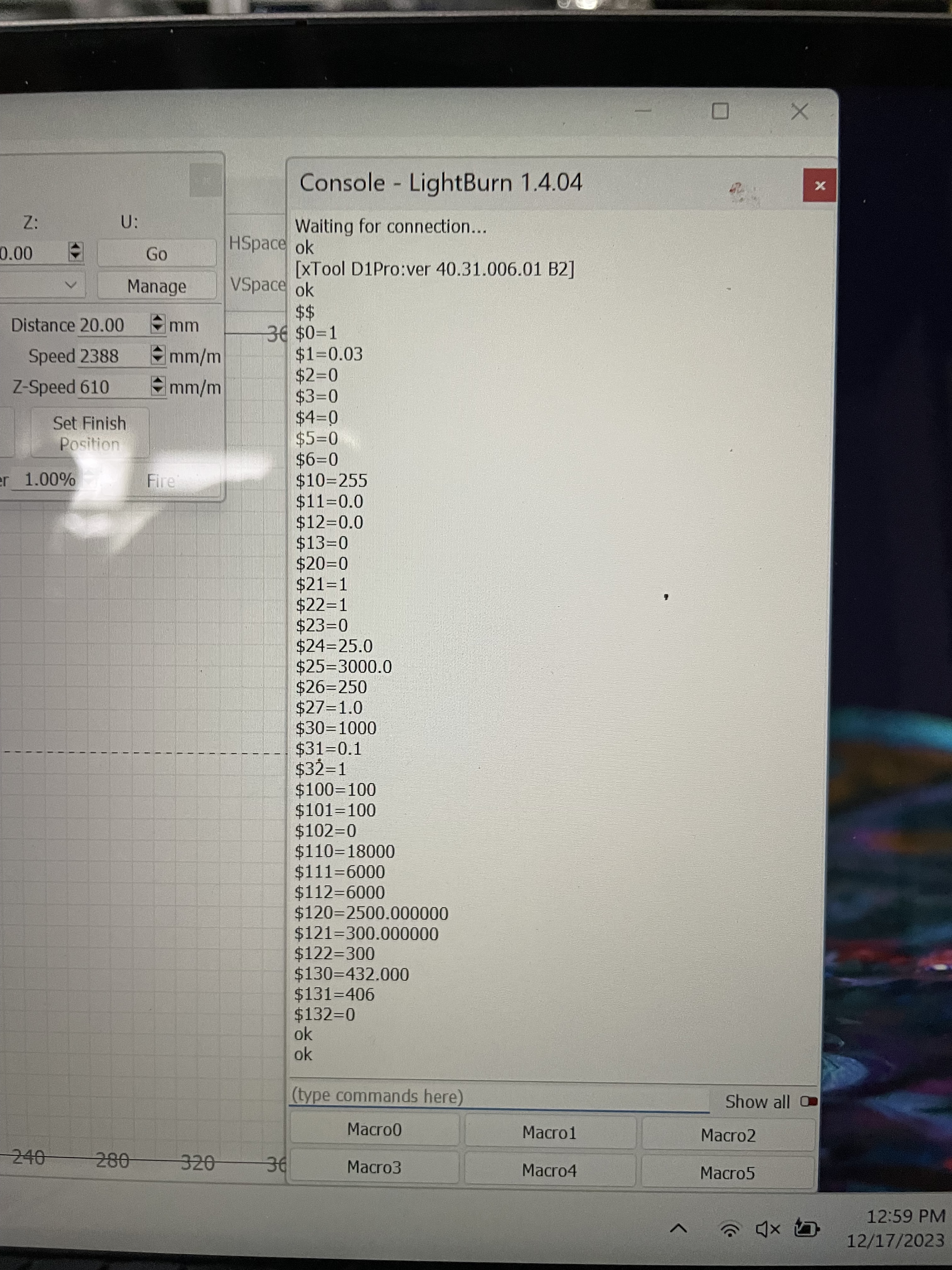

Do you have hard limits enabled?
Thank you for your response. I’m not sure if they are enabled or not. Are they supposed to be enabled? Is there a place in lightburn where you can check/set the hard limits?
Go to console and enter $$ then enter and paste to your reply.
I am away from my laser for the evening, but I will do it tomorrow and paste it. Thank you.
I typed in the $$ and here’s what came up

Checking $$ GRBL configuration for xTool machines is not particularly productive other than as a reference because xTool locks you out from making changes to the machine.
