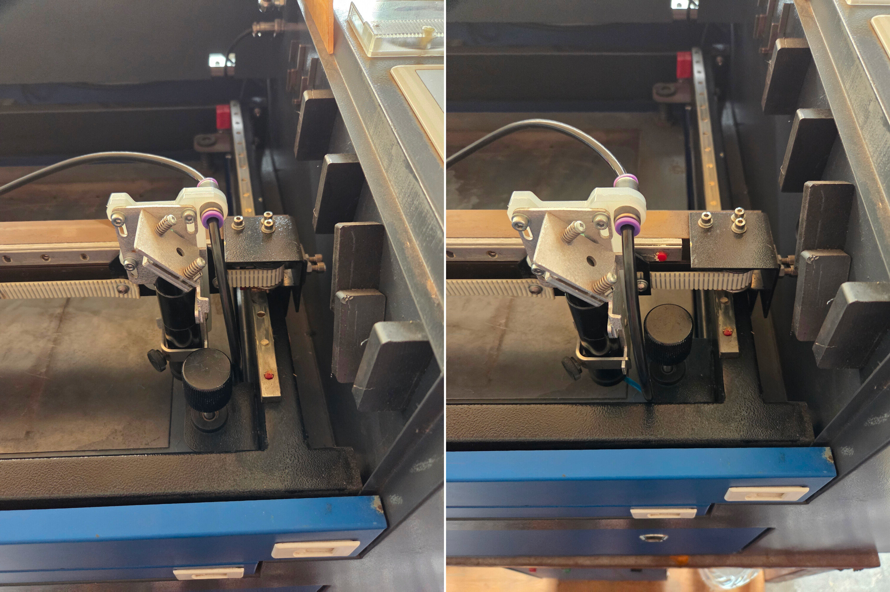

My machine is sold as a 20x12", the actual working area dimensions were 500x300mm (5030 type), this comes out 19.68x11.81".
I put a different head on mine, so I have a choice of which axes I can extend. I picked 504x340mm. The table screws are in the way to use all of the area.
Left is the X axes limit, right is the Y.
