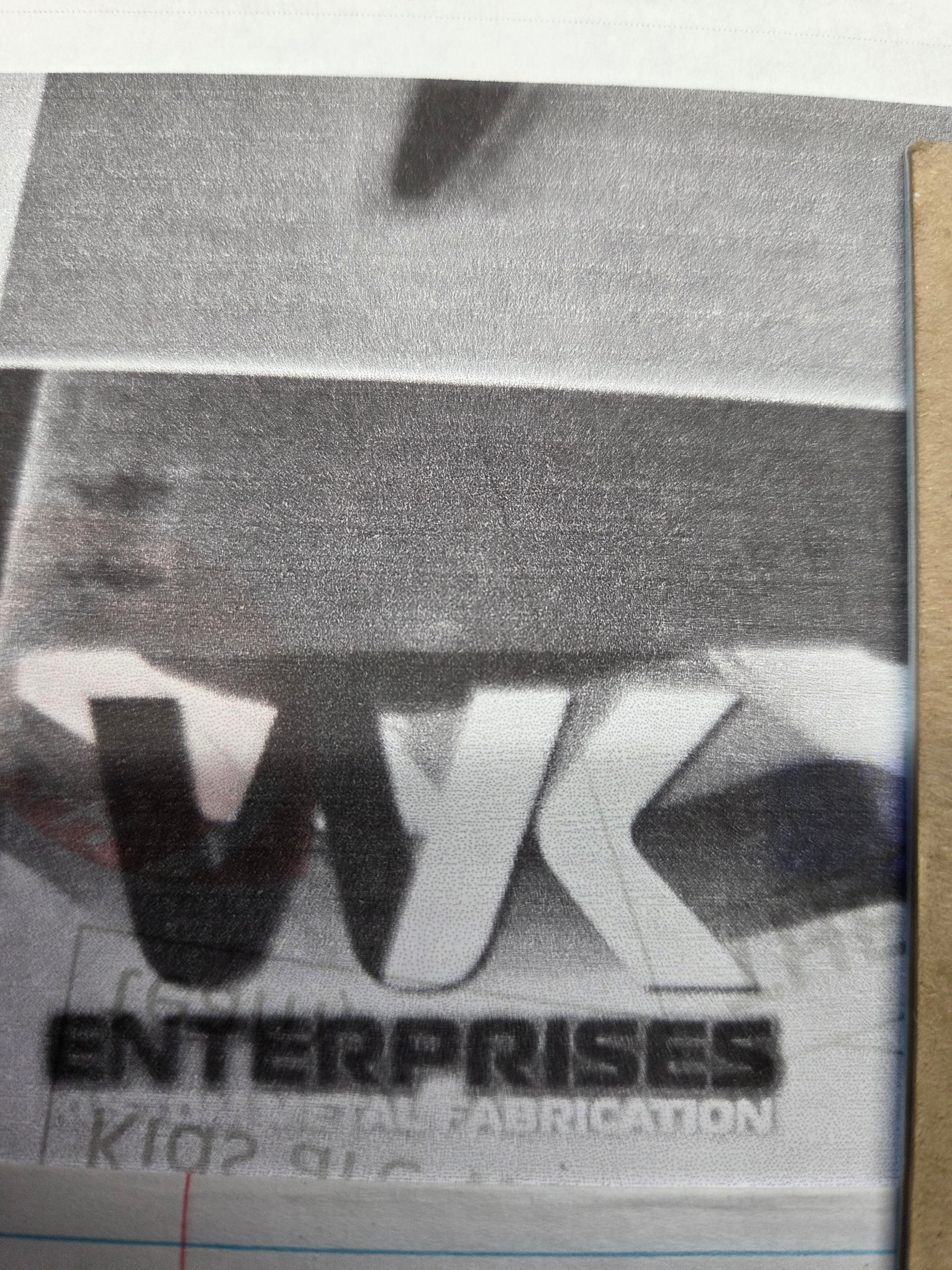

I have Creality Falcon and loaded a image of the Chicago Bull and when burning it everything looks black, So how do I change from a image so I can possibly add layers to get a better image. Wid 10 on a laptop

This is the image.
All black? Too much power, not enough contrast, moving too slow, line interval too small, use a different dither mode.
With all these variables, you will have to do some testing. Play with the attached .lbrn2 file and fine tune for what you want.

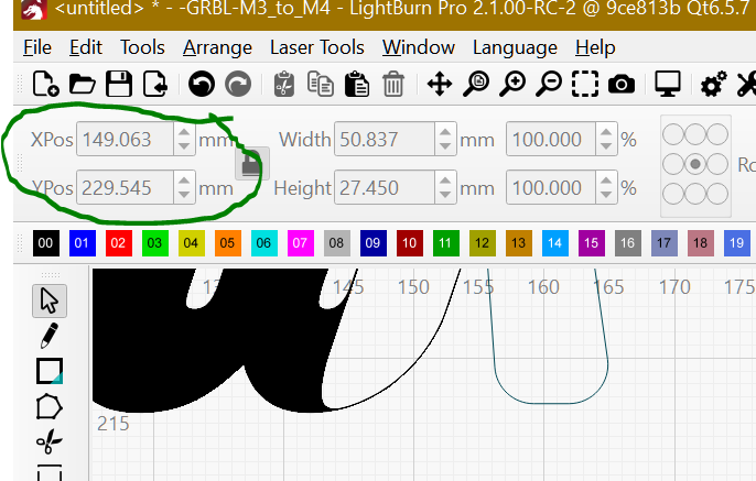

Now, I have this and I can’t get the radius on the bottom of the K. I managed to get the K separated but can’t move it and can’t put the radius on the bottom left. Like it’s not joined. When I click to put the radius and the opposite corner gets it, lower left, and I cannot get that that to join. Also….. when I try to move that part of the K to the left I can’t get it to move in small increments regardless of what I press along with the arrow key. Been fighting this for a week off and on. THANK YOU.
OK, I’m going to be “that guy” and say it is always best to work with the highest quality image possible. Significant time savings can be achieved.
If willing, post the project file for our review. We may have suggestions to assist. :slight_smile:
I will try to get something better today. I hope.
You can also move the objects with Numeric Edits values:
