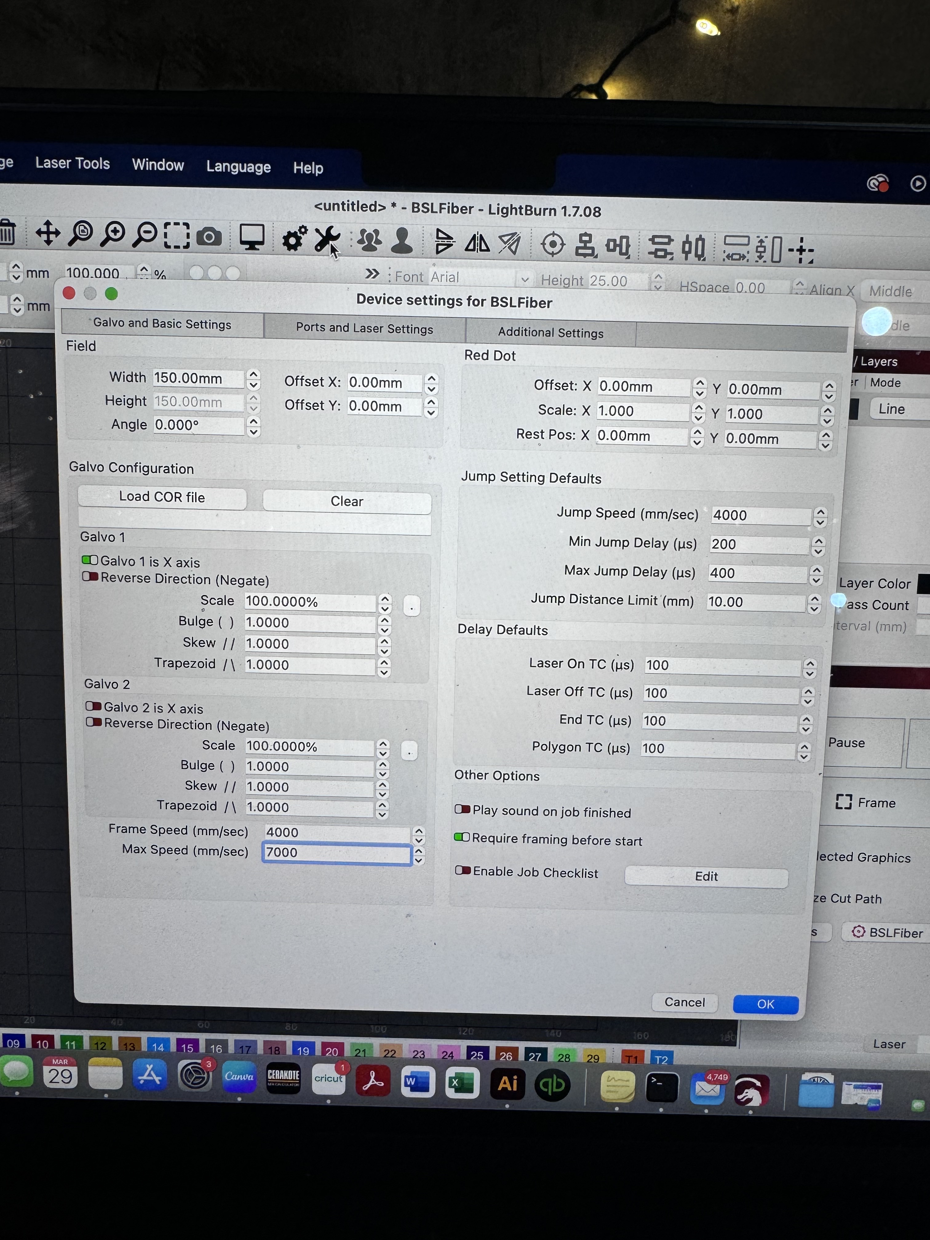

It does not seem like I’m getting a frame at all but what’s interesting is I can hear the laser framing (I hope that makes sense). So an audible difference in the laser head when I hit frame. But no image frame or laser. I only have the main red laser.
Post a screenshot of your settings screen (Wrench and screwdriver)
Try 9 point anyway, set scale to about 70% and run.

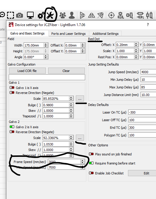

So maybe you should start at the begaining. Make a small square, maybe 10x10mm, assign some parameters like 20% power, 20KHz, 0.0254 Line Interval Fill mode Bi direction and Cross Hatch. Start with the head about 300mm above the black business card and start laser. You want to use the continuous Mode, make sure and reset count to zero. Frame and start.
Lower your galvo down until it starts making noise, then try to adjust up and down until you get the most noise. That is your focus point. Even if you have a focusing laser, measure this height, make a T-stick, dowel, or a mark on your clear ruler. If you don’t get any noise, turn your power up start again. .
Lower your framing speed to 3000, Then run the 9 point correction.
