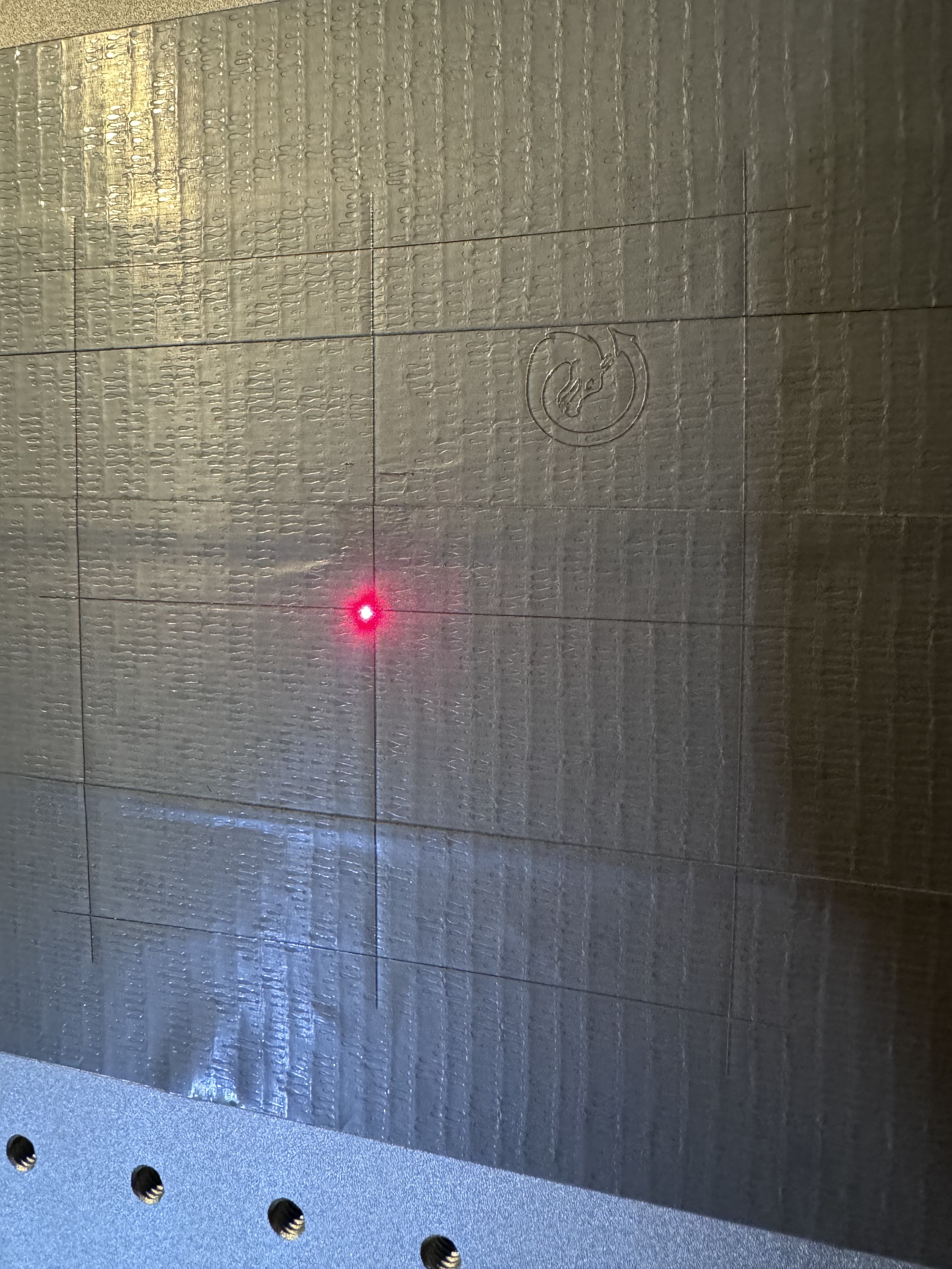

And I see your red light framing laser in the center?
Looks like you are making great progress (thankyou @Albroswift!)
Regarding the framing from have a look in the ‘Ports and Laser Settings’ tab, and try toggling on ‘Red Dot always on’.

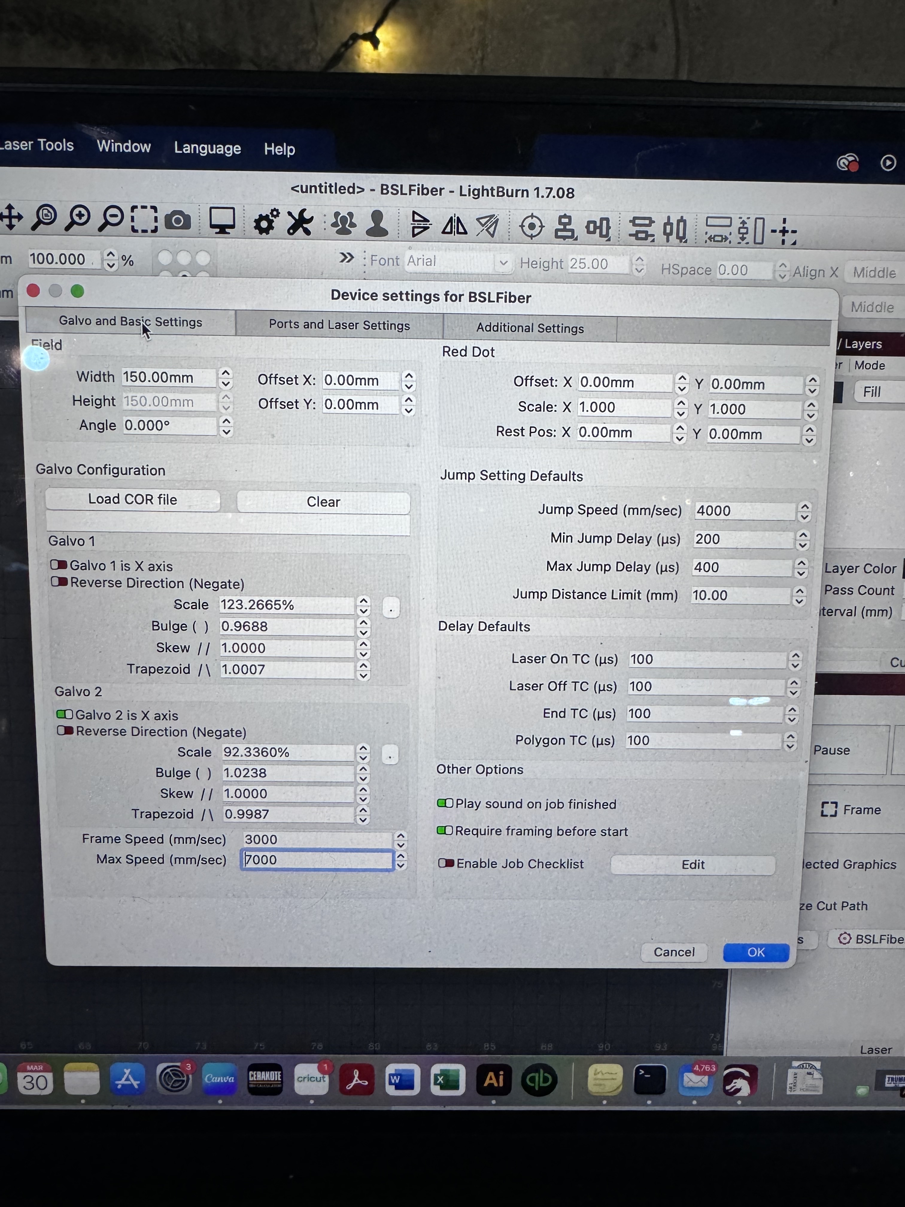

Thanks for all the input guys! I really appreciate all the help. Seems like I still can’t get it to frame out my project. I’m going to try to switch to a windows computer and ditch the Mac. Maybe that has something to do with it?
Sorry for the time delay, lightburn banned me for 9 hours after posting too many times lol
Just seeing this, I will double check this later tonight. Thank you!!
I’ve tried all these suggestions and still getting a buzzing noice in the laser head when I try to live frame with no actual live frame. I’m thinking I may have a faulty machine, which is unfortunate because I just bought it new last week! Will be trying a new computer and if that doesn’t work, I’ll be shipping it back. I appreciate everyone’s help here! I really do

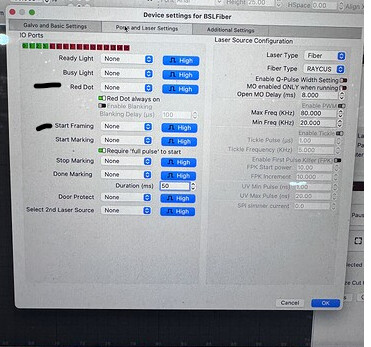

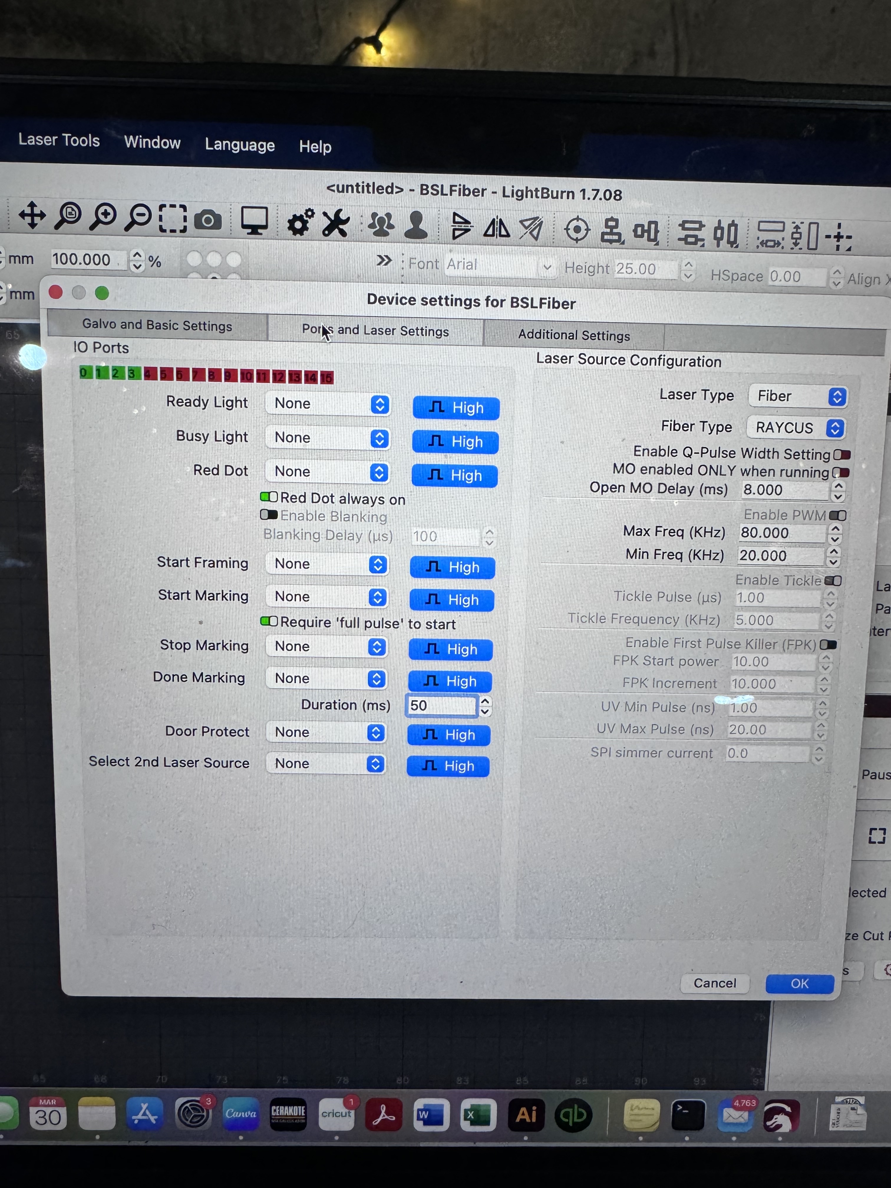

you have not selected an io for your red light, seems you have 4, just try one after the other
Can you dumb this down for me? Lol I’m not sure what you mean

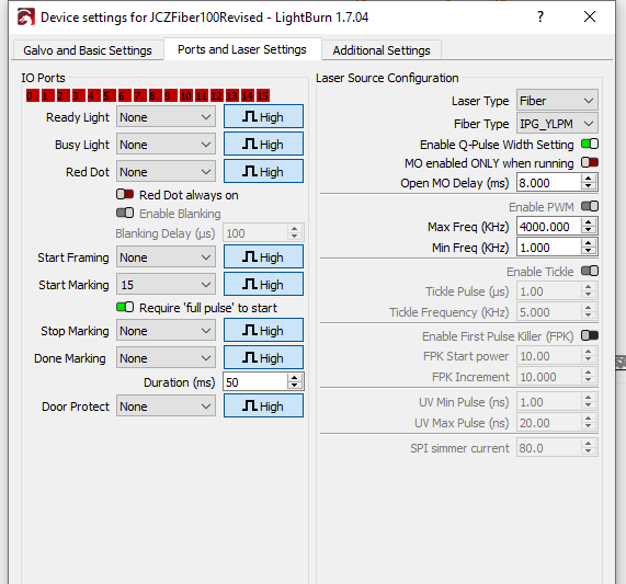

I think @Enno is talking about this.
Mine are all “None” except for “Start Marking” “15” as my foot switch is wired to pins related to general input 15. If I change 15 to “Start Framing” the foot switch will start the framing Laser.
I have messed with this a lot and don’t think it is the issue but I’ve been wrong before, wouldn’t hurt to try.
My ports screen:
Gotcha. I’ve tried the start framing option and it just starts firing the laser when I click frame, which is not what I’m looking for unfortunately
You put 15 in Start Framing and when you step on the footswitch it starts marking?
No I don’t use the foot switch. It just starts marking when I hit frame if I have “start framing” on (or anything other than the “none” option).
That is not a correct function. Sounds like it’s going to the maker. Do you have a foot switch?
I do have a foot switch!
In the name of science, put 15 in the start framing field, select some object, and press the footswitch.
If nothing happens use 14. Those are the 2 most typical. (With a BJJCZ board) not sure about seacad.
