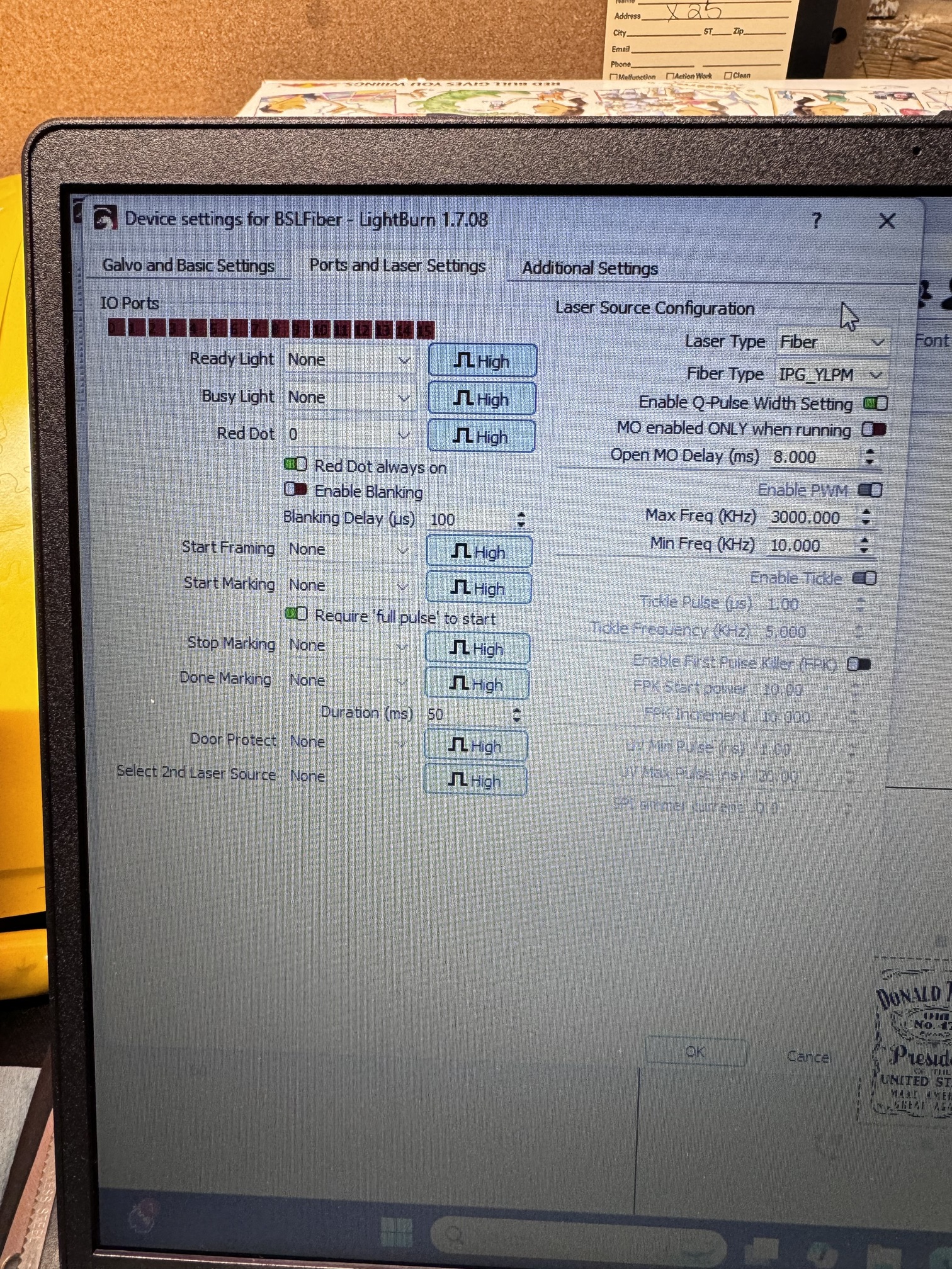

UPDATE:
I replaced the USB Data cable from my computer to the laser and have been messing with my settings. Everything is communicating correctly now AND I’m framing. Here are my settings.

I would be interested to know if the “Red light always on” was turned off if it still worked.
Good question. I think I’m too afraid to click anymore buttons :joy:
You think it was a bad cable all along?
That’s kind of what I’m thinking. I didn’t have the settings much different from before. I can’t think of anything else that changed

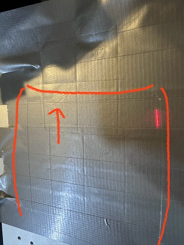

Also, it seems I do need to calibrate again. For some reason I can’t get a completely square box when I frame out the perimeter of my work space. The square is still concave on the top and bottom.
Maybe start over, run the 9 point correction, run the scale utility, check skew. Changing machines probably did it. Alex’s LMA video:

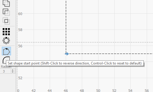

This video was made for ezcad, two things that change with LB, need to make 2 sub layers, one fill and one line to get a border and fill. . (Ezcad will do border and fill together) Second thing, to start in lower left and have your border go CCW like the video, need to select the lower left corner and set arrow.

Any idea on how to fix these curved lines? I was thinking it was going to be in that LMA video but it wasn’t. I have completed three 9 point lens calibrations with no luck. Still getting curved squares
Check your cable? (Just kidding)
You must be missing a step with the 9 point, it should fix that.
Make sure you are focused.
Make sure you are entering the correct lens size.
Make sure you are creating a new machine, name it something easy to recognize.
Make sure you go through all the steps.
Screen shot each step if you like and post.
Does the redlight laser frame a rough square when you get to that screen? With my 300 X 300 lens I need to go below the recommended %, with the 175x175 recommended fits on the table and frames properly.
