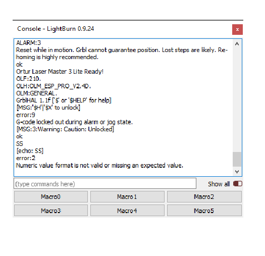

I just bought a new Ortur LM3 LE and have not been able to home it due to an error code in Lightburn. I spent all day yesterday communicating with Lightburn support.The homing issue has not been fixed.I provided all the requested info and followed the instructions and showed the result that the error code had changed and didn’t hear back. This morning I got an email from Lightburn support stating that the ticket has been closed.
Is there anyone in this group who can help solve this issue? Very frustrating to have a new machine and not be able to use it.
LightBurn is displaying the error message, but the problem occurs entirely within the laser, where the GRBL firmware in the controller detects and reports it.
The description of GRBL’s Alarm 3 may be informative:
Typically, this will occur due to a loose power supply connection / wire or a failing power supply (which is, we hope, unlikely in a new machine).
The Error:2 message at the bottom of the Console can happen after choosing an incorrect Device Type for the machine: LightBurn is generating G-Code instructions for a different machine, which the controller does not understand. IIRC, Ortur LM2 controllers use plain GRBL, so make sure you have selected that Device Type, rather than GRBL-LPC or something else.
With that verified, it is possible to get Error:2 from a USB communication problem. After you sort out the other problems, we can tackle that one …
Just above that Error 2 was what looked like SS. Was that supposed to be $$ instead?
In the email from support it said type in SS.I did and sent them the result but didn’t hear back.

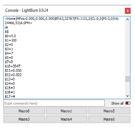

I just tried $$ and got a different
You were likely asked to enter $$ not SS - for the record. That list of $ numbers is what the support agent is looking for.
$$ is the correct entry for viewing the GRBL parameters.
You can copy and paste the entire list from the Console window (try right-click). A screen capture does not show all the parameters. Unfortunately the $22 parameter related to Homing is not visible in your image.

ALARM:3
Reset while in motion. Grbl cannot guarantee position. Lost steps are likely. Re-homing is highly recommended.
ok
Ortur Laser Master 3 Lite Ready!
OLF:210.
OLH:OLM_ESP_PRO_V2.4D.
OLM:GENERAL.
GrblHAL 1.1f [‘$’ or ‘$HELP’ for help]
[MSG:‘$H’|‘$X’ to unlock]
error:9
G-code locked out during alarm or jog state.
[MSG:3:Warning: Caution: Unlocked]
ok
SS
[echo: SS]
error:2
Numeric value format is not valid or missing an expected value.

Waiting for connection…
SS
[MSG:25:Info: USB SERIAL STREAM CONNECTED]
OLF:210.
OLM:GENERAL.
[MSG:13:Warning: Homing cycle required]
<Home|MPos:0.000,0.000,0.000|Bf:63,32767|FS:0,0|CL:0,0|PS:2,0|VA:24452,53|Ov:100,100,100|A:SFM>
[MSG:69:Info: WIFI AP READY]
<Home|MPos:0.000,0.000,0.000|Bf:63,32767|FS:1131,0|CL:0,0|PS:2,0|VA:24452,54|A:SFM>
[MSG:76:Info: WIFI STA DISCONNECTED]
[MSG:75:Info: WIFI STA KEEP TRYING CONNECT …]
ok
ok
ok
ok
ok
ok
ok
ok
ok
ok
ok
[ORIGIN:China]
[PRODUCER:ORTUR]
[AUTHOR:LEADIFFER]
[MODEL:Ortur Laser Master 3 Lite]
[OLF:210]
[OLH:OLM_ESP_PRO_V2.4D]
[OLM:GENERAL]
[DATE:20230321]
[SN:737CC407318E83F053066309A8B912BF]
[VER:1.1f.20220325:]
[OPT:VNZHS+,63,32767,3,0]
Target buffer size found
[NEWOPT:ENUMS,RT+,HOME,NOPROBE,TC,SED,UD,CLU,WIFI,FTP,TMC=3,SD,ITG,GT,YRR]
[FIRMWARE:grblHAL]
[NVS STORAGE:*FLASH]
[DRIVER:ESP32-S2]
[DRIVER VERSION:220327]
[DRIVER OPTIONS:GIT-NOTFOUND]
[BOARD:Ortur Laser Master 3 Lite]
[TYPE:OLM3LE]
[CLUSTER:16]
[WIFI MAC:58:CF:79:A7:2B:FE]
[IP:192.168.5.1]
[PLUGIN:Power Detecter v1.0]
[PLUGIN:Power Control v1.0]
[PLUGIN:gyroscope sensor v1.0]
[PLUGIN:Trinamic v0.09]
[PLUGIN:SDCARD v1.05]
[PLUGIN:ITG STREAM v1.00]
[PLUGIN:ESP32 WebUI v0.03]
[PLUGIN:GADGET v1.00]
[PLUGIN:YRR v1.00]
ok

$0=5.0
$1=100
$2=0
$3=1
$4=7
$5=0
$7=0
$10=2047
$11=0.050
$12=0.002
$13=0
$14=0
$15=3
$16=1
$17=4
$18=0
$20=1
$21=0
$22=1
$23=7
$24=600.0
$25=800.0
$26=100
$27=1.000
$28=0.100
$29=0.0
$30=1000.000
$31=0.000
$32=1
$33=2000.0
$34=0.0
$35=0.0
$36=100.0
$37=0
$39=1
$40=1
$41=0
$42=1
$43=1
$44=3
$45=0
$46=0
$56=1.0
$57=1800.0
$58=395.0
$59=6000.0
$60=0
$61=1
$62=0
$63=3
$64=0
$70=31
$73=3
$74=cjcs
$75=********
$76=OLM3LE_AP_2BFE
$77=12345678
$100=100.000
$101=100.000
$102=100.000
$110=15060.000
$111=15060.000
$112=600.000
$120=2000.000
$121=1800.000
$122=200.000
$130=400.000
$131=400.000
$132=100.000
$140=600
$141=1000
$142=800
$150=16
$151=16
$152=16
$160=0.000
$161=0.000
$162=0.000
$180=15060.000
$181=10542.000
$182=600.000
$200=65.0
$201=50.0
$202=60.0
$210=100
$211=100
$212=100
$220=50.0
$221=60.0
$222=60.0
$270=115200
$271=115200
$272=115200
$300=OLM3LE_STA_2BFE
$301=1
$302=192.168.5.1
$303=192.168.5.1
$304=255.255.255.0
$305=23
$306=80
$307=81
$308=21
$310=OLM3LE_AP_2BFE
$312=192.168.5.1
$313=192.168.5.1
$314=255.255.255.0
$330=admin
$331=user
$332=255
$339=3
$341=0
$342=30.0
$343=30.0
$344=180.0
$345=200.0
$384=0
$392=5.0
$393=3.0
$600=0
$601=5
$602=0
$603=5.0
$604=6.0
$605=1
$606=1
$607=0
$608=1
$609=10.000
$610=0
$611=0
$612=1
$613=342
$614=0
$615=api.ortur.cn
$616=0
$617=0
$622=111
ok
<Home|MPos:0.000,0.000,0.000|Bf:63,32767|FS:0,0|CL:0,0|PS:2,0|VA:24494,57|H:1,7>
<Home|MPos:0.000,0.000,0.000|Bf:63,32767|FS:1131,0|CL:0,0|PS:2,0|VA:24466,50|A:SFM>
ok

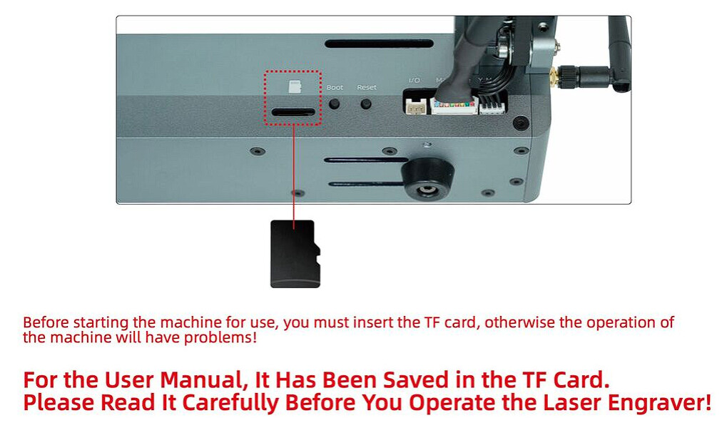

You do have the TF card inserted?
I don’t know what that is but everything in the assembly instructions are done.I can burn a rectangle but a photo it just stops
