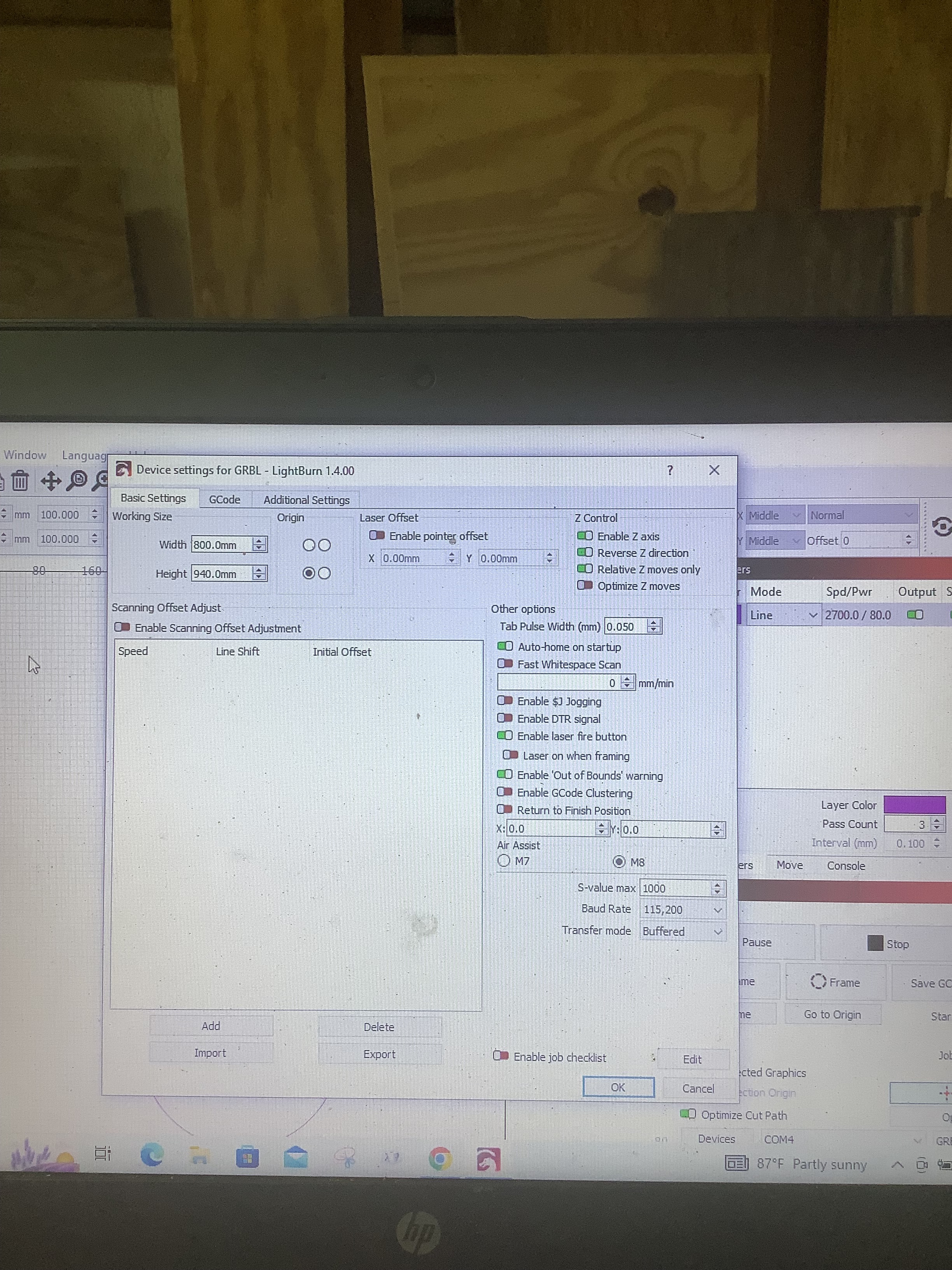

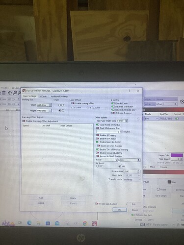

In the Edit - Device settings window lower right is Return to Finish Position. Right below that is a couple of boxes that hold the âends atâ position. Adjust those or turn off the Return. Curious⌠what happens if you donât stop it.

I unchecked the return to finish box and weâll see what happens now. Itâs an awesome feeling!!! Thanks so much

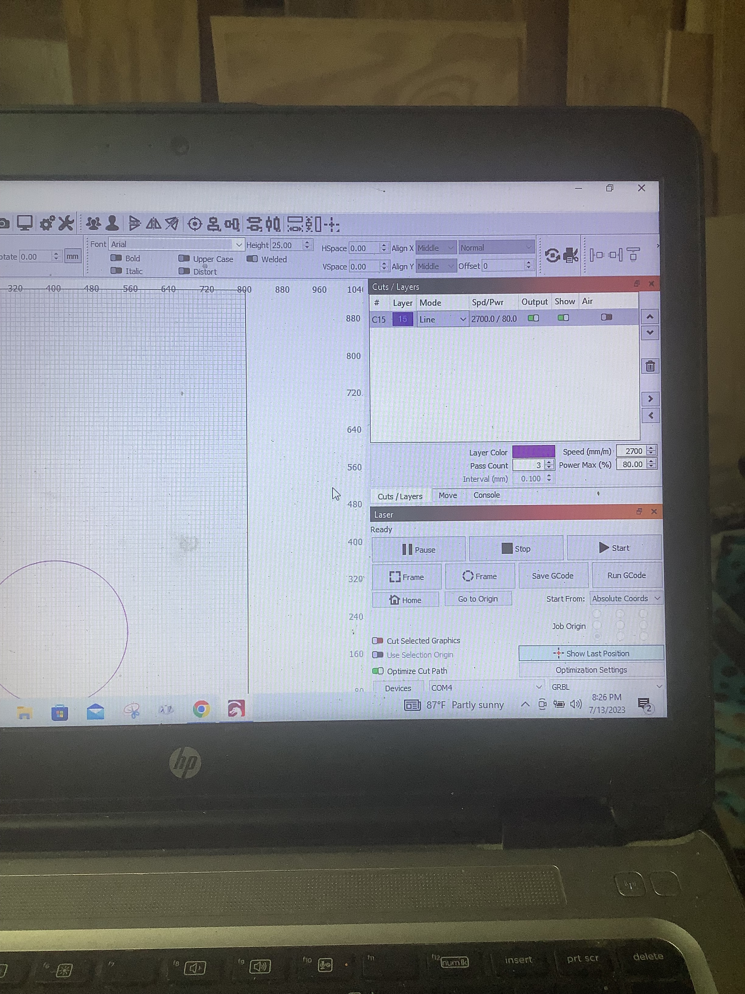

Yâall helped so much before I need help again. I went to cut a circle and my laser did not make the circle. It made an oval or an elliptical shape.

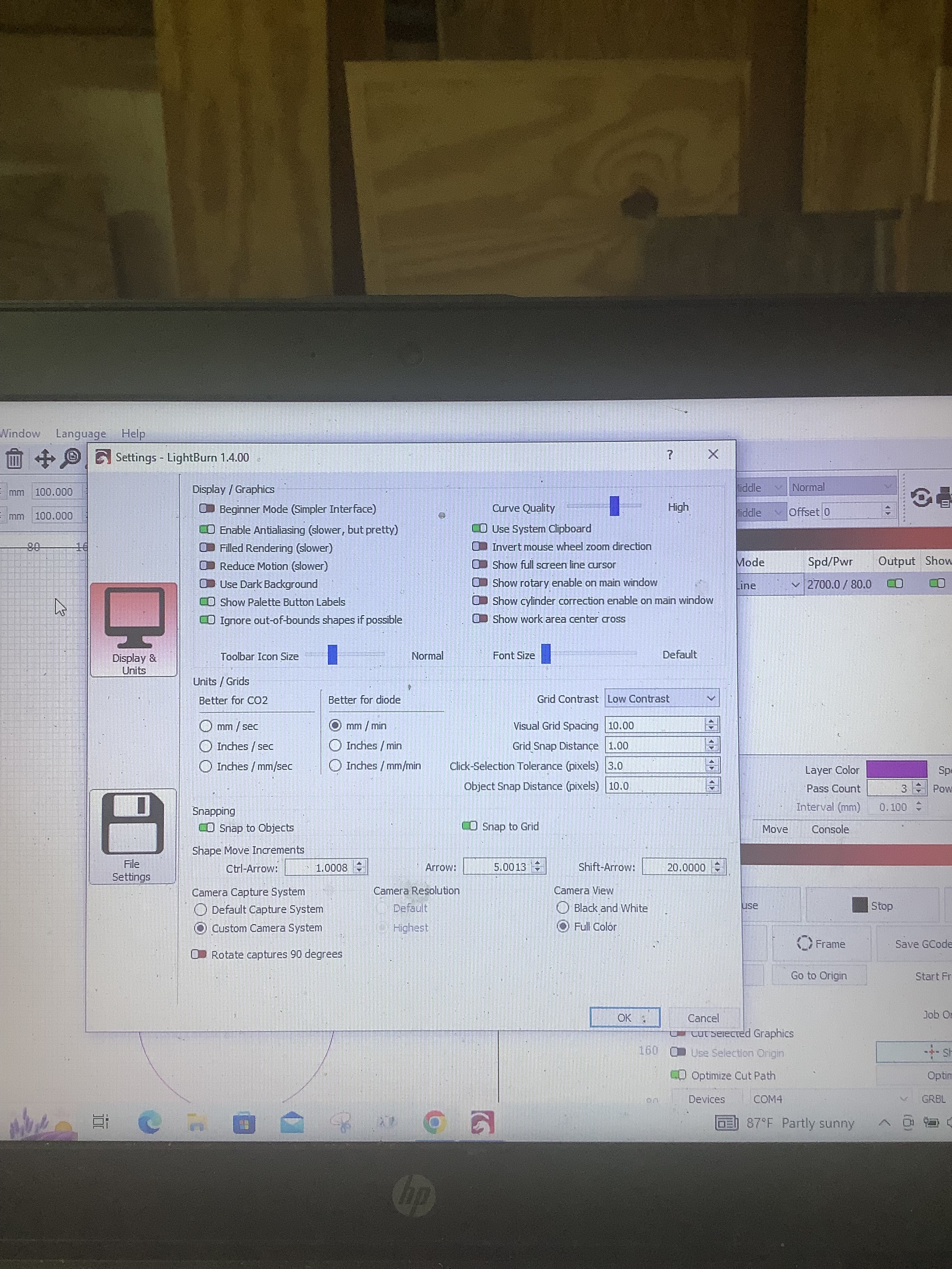

Make sure that rotary is not enabled.
Edit, Settings, in upper right, Show rotary enable in main window. This will make it visible in the Laser window. If it is Enabled, you found your culprit.

I can tell from the available screenshots that rotary is not enabled.
Are you also aware that a good portion of the bottom of the application is not showing for you? This may be due to limited vertical screen real estate. I would suggest collapsing the two right window panes into a single pane. That should free-up enough vertical resolution to show the entirety of the application.
Also, has this issue with circles coming out as ovals always been there or is this a new issue?

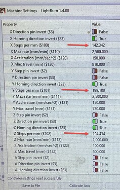

Are you using the same steps per mm values that you were in post #73 20 days ago?
You likely had the correct settings before the axis calibration attempts:
You may wish to revert your $100, $101, $102 settings back to what they were on May 27 before attempts were made at axis calibration.
$100=199.100
$101=199.100
$102=199.100
$110=4000.000
$111=4000.000
$112=4000.000
$120=700.000
$121=700.000
$122=700.000
$130=810.000
$131=730.000
$132=90.000

That worked I got a perfect circle! Yaâll are awesome!, Thanks so much
