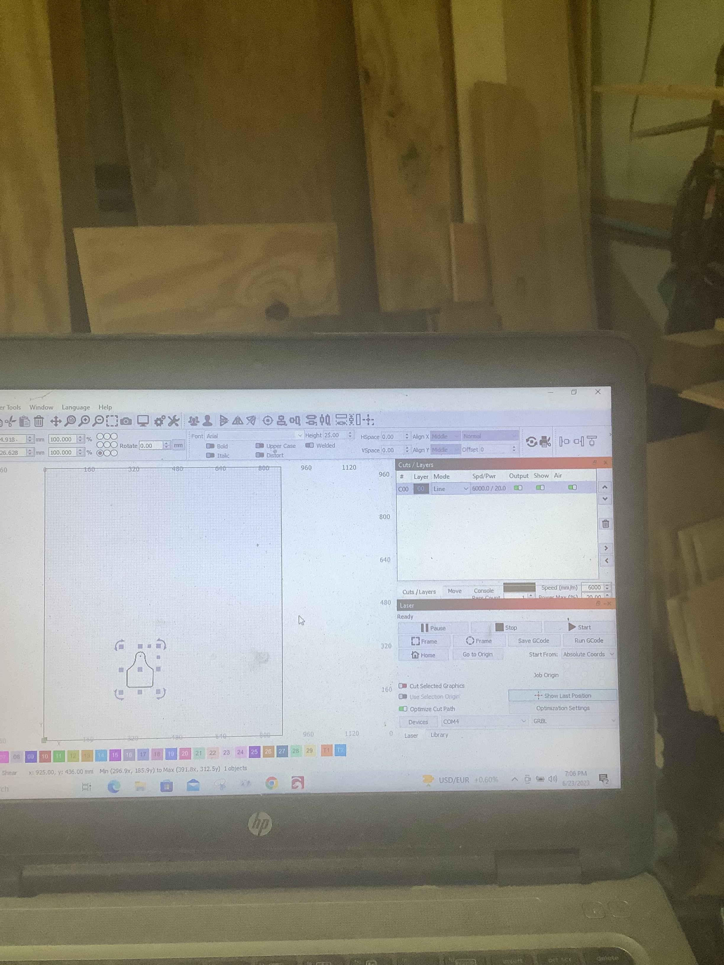

Ok I still don’t have something just right. So my design was close to the front of my workspace and in between the left corner and the middle. So I wanted to just frame it to see if my material was in the right area and my laser went all the way to the back right corner and I had to stop it. I do not have limit switches at the back
I had the same problem, G54 as an initialization (one time only needed) string fixed it…
This Doc should help you set it. Basically, your machine is working in an all-negative quadrant, G54 moves it to the all-positive quadrant, which matches Lightburn. The X and Y values are the max travel values, I think with the sign flipped.

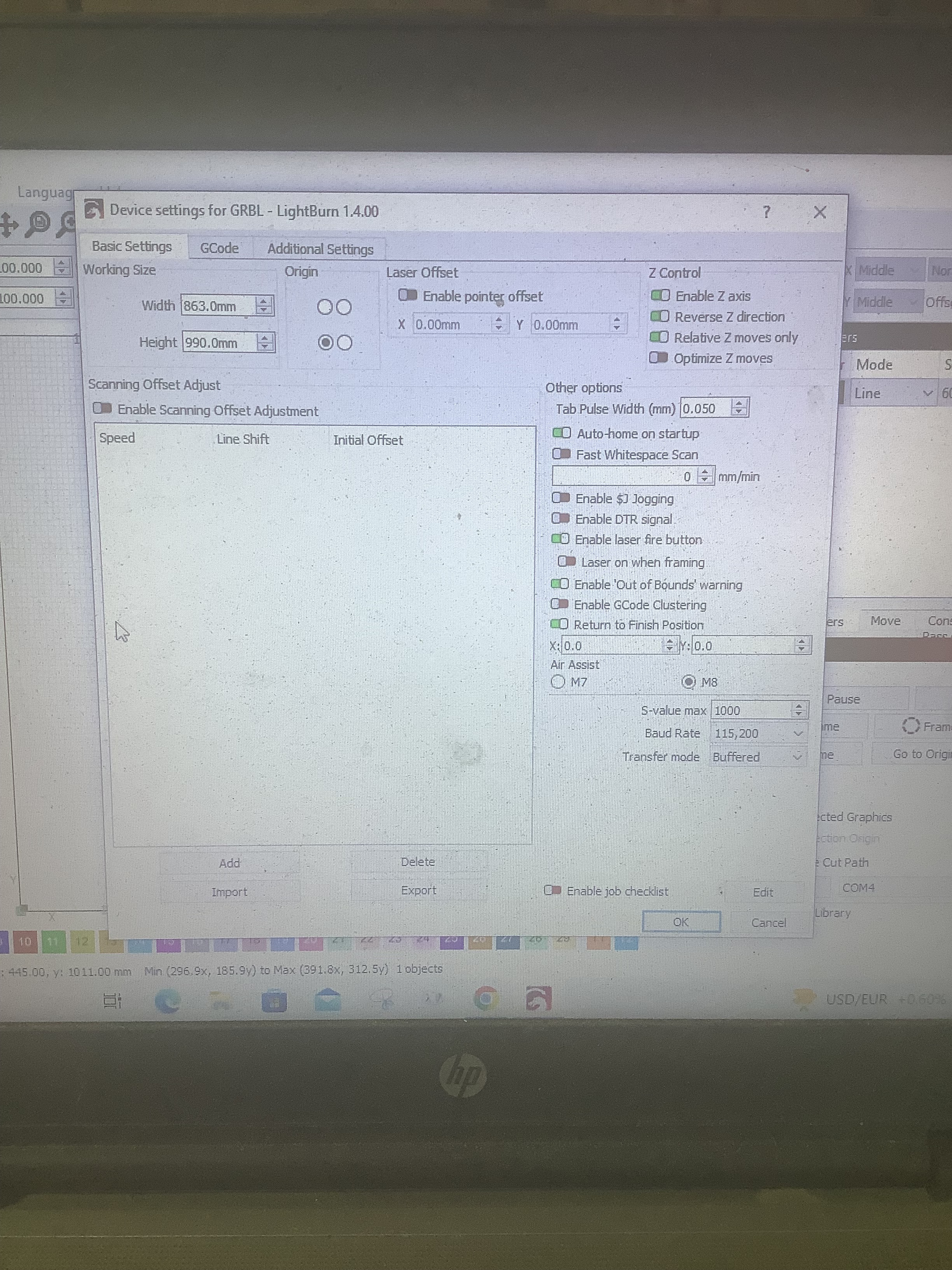

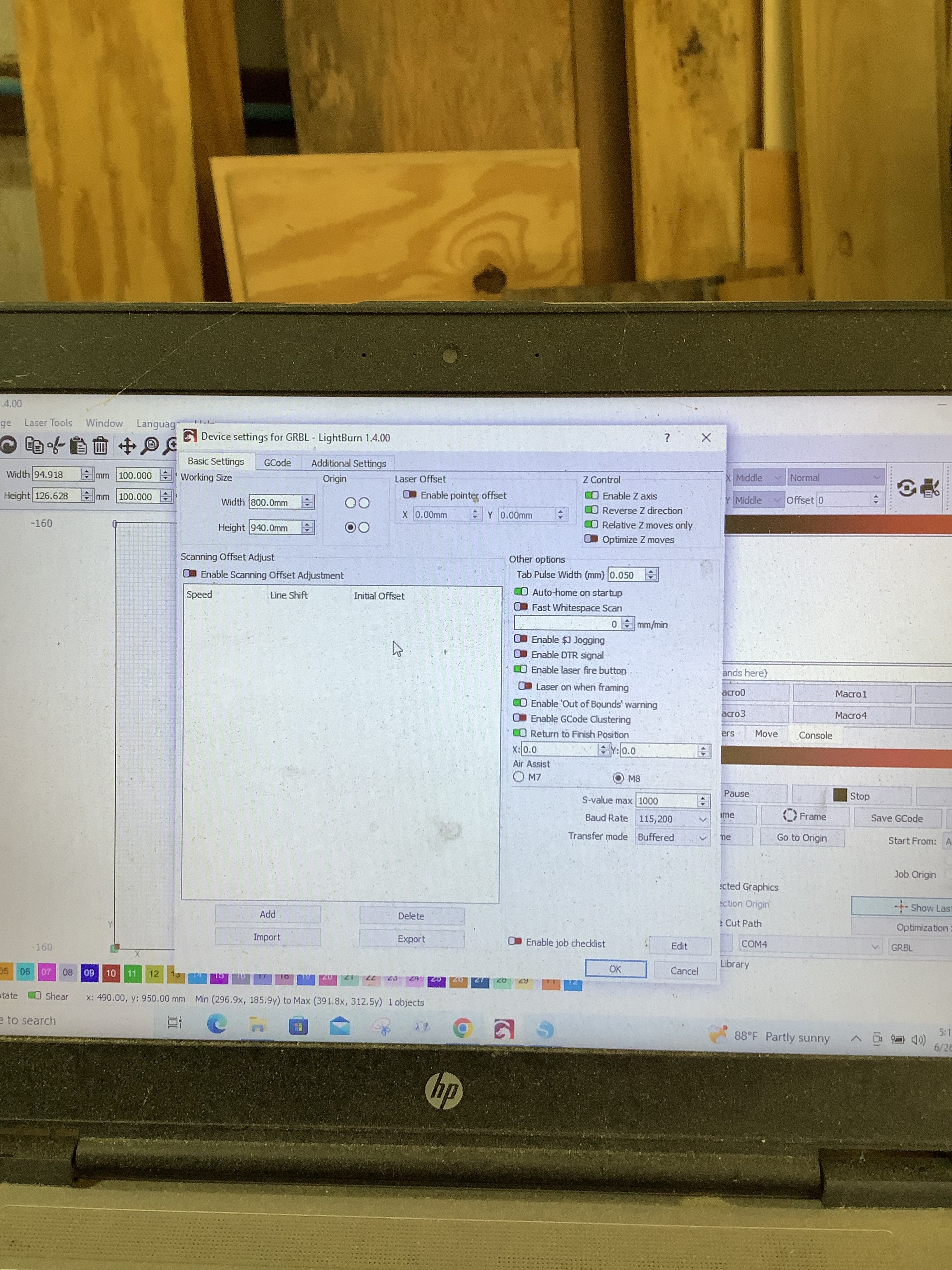

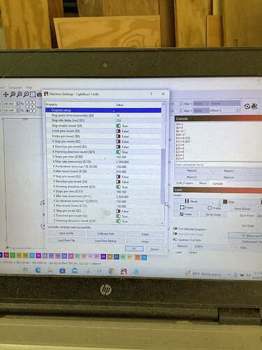

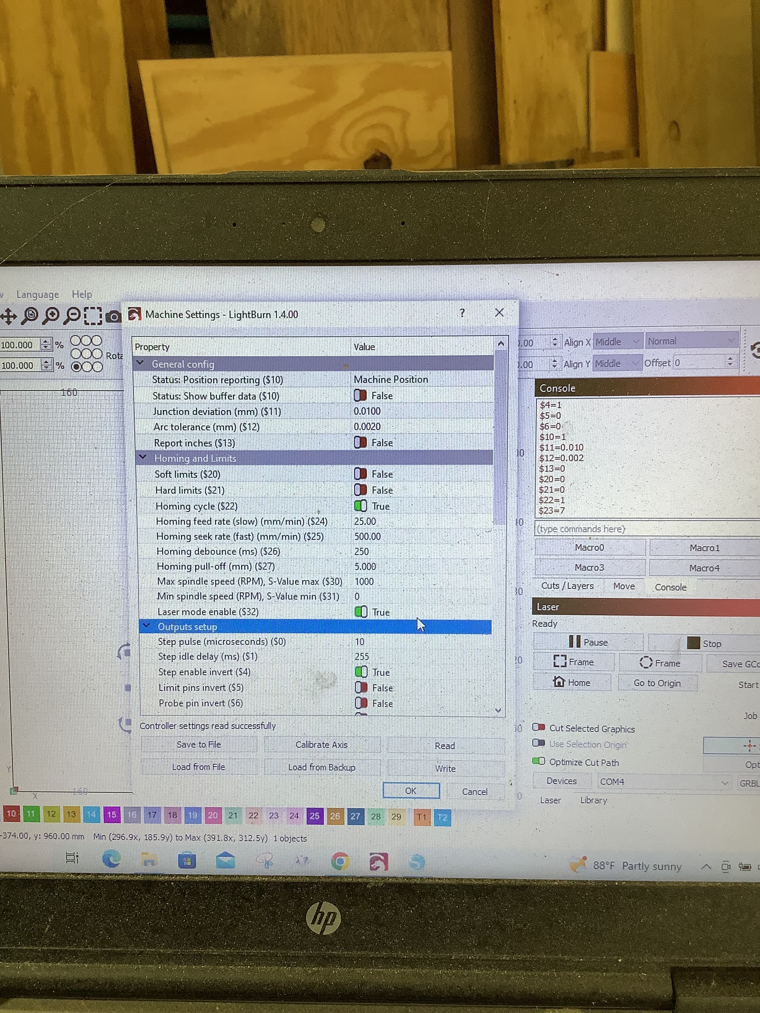

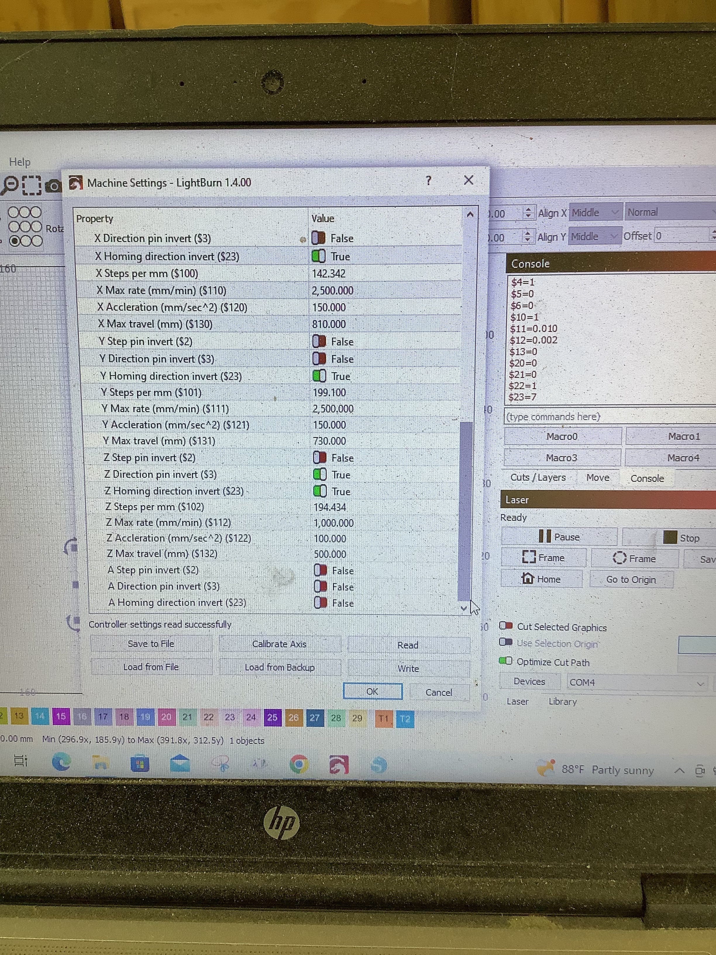

Ok so it didn’t go to the back right corner,but I am get a little noise when it moves so I am guessing it may be my speed of the x axis. And the z axis doesn’t move down. I included pictures of my settings and the video of it moving won’t load
Good info, enuff to keep me busy. While I am reviewing your settings, can you please answer/do these two things?
  1. When you home the machine, where does it go now (after the new G10 setting)?
  2. Can you upload the Lightburn file that is giving you grief?

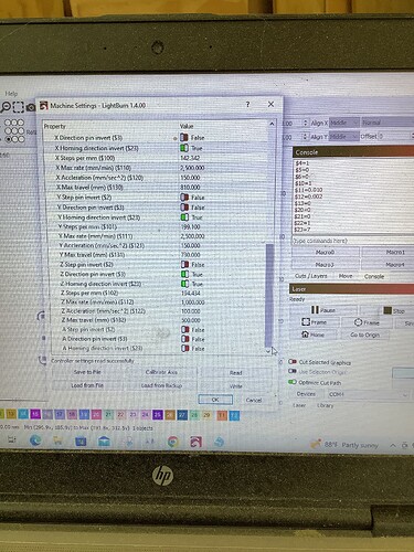

Your X max $130 is 810 and Y max $131 is 730. That is what should go into the G10 command. G10 L2 P1 X-810 Y-730 I omitted Z because I do not know if your home switch is at the top or bottom. Just remember when you HOME, you have to be off all the switches.
Noise? You did not say whether accelerating or moving. Accel is $120, $121, $122. Move max rate is $110, $111, $112. I do not know your machine, but my numbers are a lot less and it is a lot smaller (les mass).

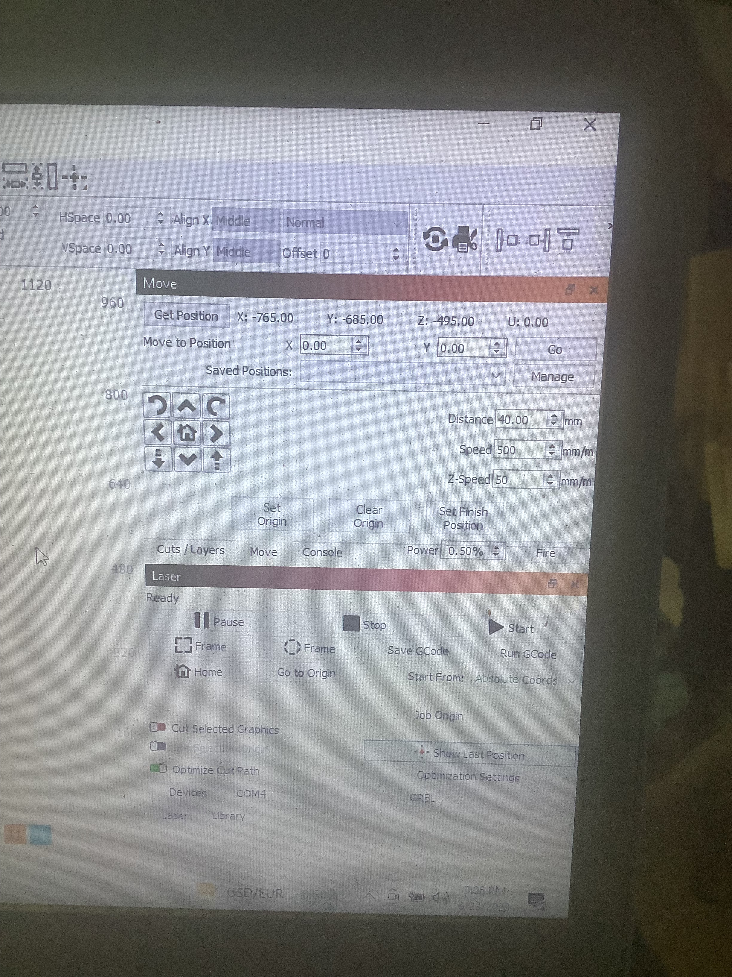

It still homes front left
Ok it still homes front left. I will put the new G10 in tomorrow
