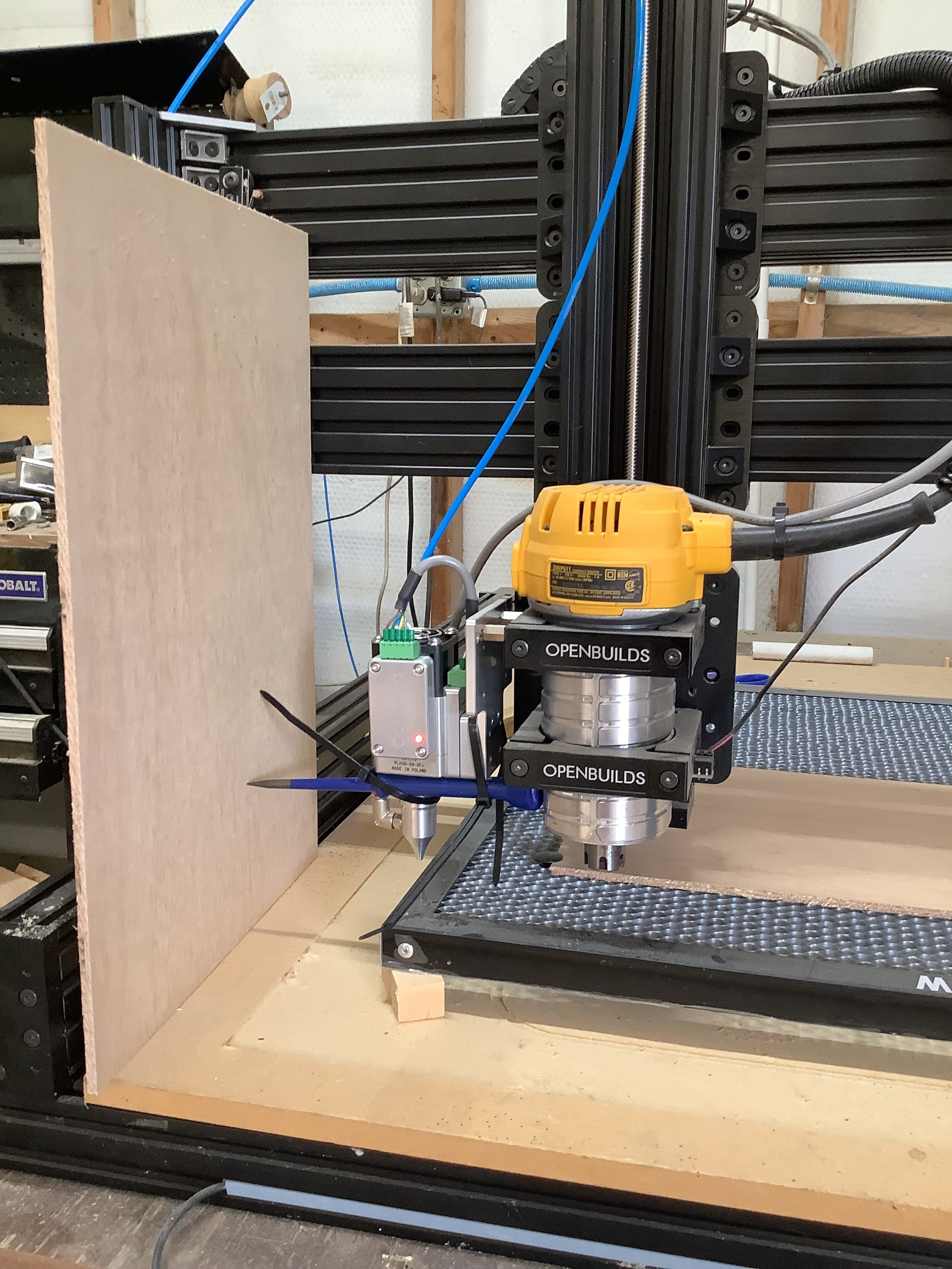

Ok I couldn’t get the awl to make a mark on the can so I did it this way and come up with these first two measurements if this isn’t right please let me know
Under calibrate axis I entered 100mm for requested and 102.40 for actual and jogged the 100mm again from the start of the second measurement and got 98.4mm.
. So what is my next step?

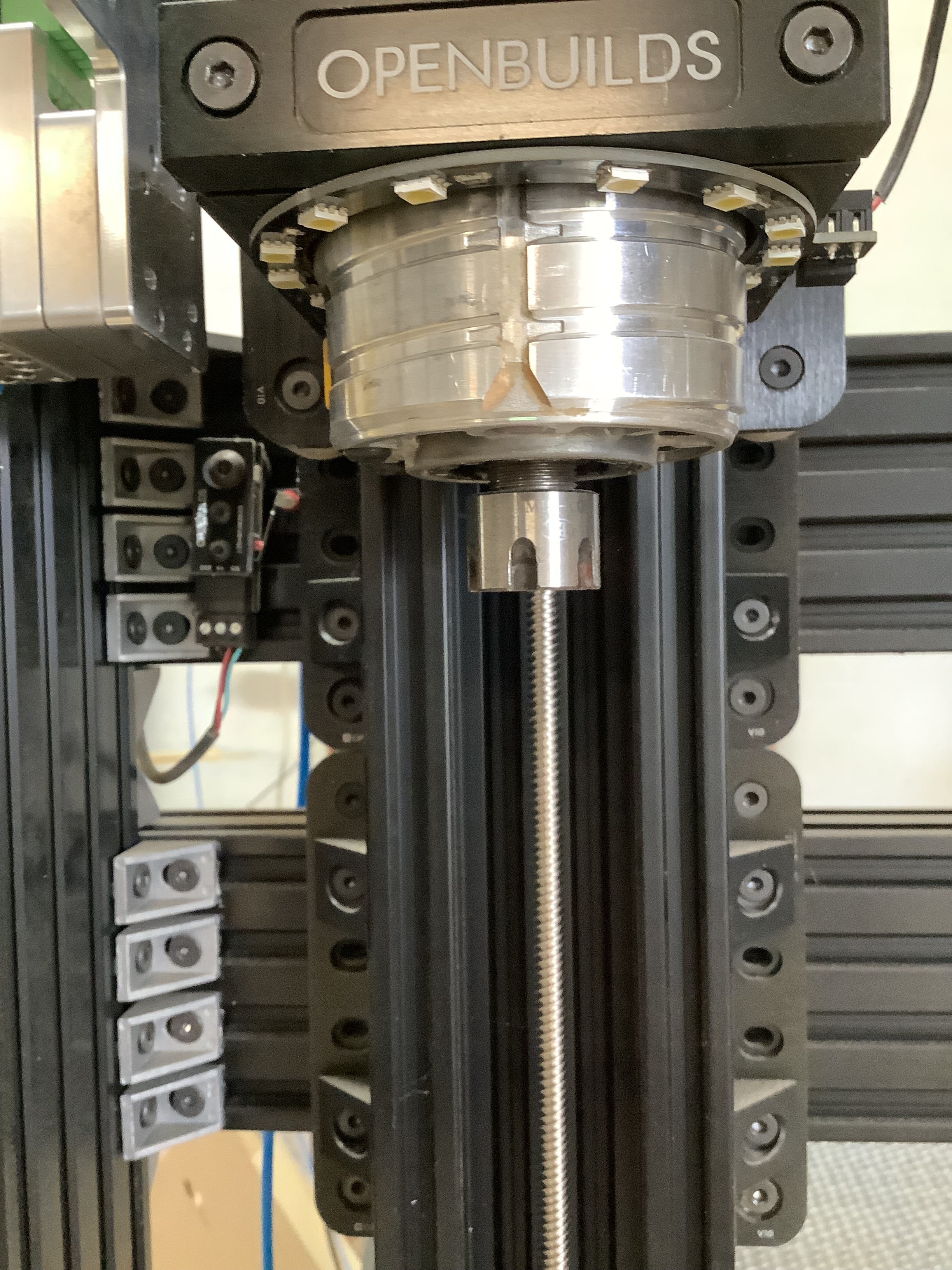

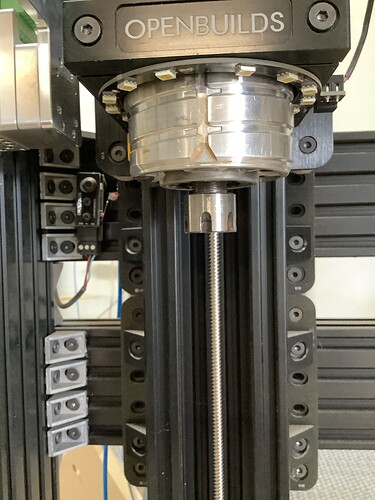

These are super-close. Does this engraver use a lead-screw for each axis?
You may be fighting a small amount (~1 mm) of backlash on the z axis if you changed direction. The way to defeat this is to jog beyond your intended ā€˜start’ point, then jog to the start point so the calibration jog is in the same direction as the previous jog.
I’m guessing that it’s this because your lower number is close to the Z limit, and that backlash could have consumed 1.1mm.
If there is backlash available, it will present as a small loss of commanded motion when the direction changes.
It’s also possible your pencil shifted by less than 2mm and caused the calibration error. Each calibration should ā€˜get closer’ to the commanded distance.
After 2-3 consistent axis calibrations the axis will be accurate and repeatable.

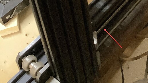

I believe my x and y axis are belt driven here’s a picture.
I did have to reverse the direction of the z axis.

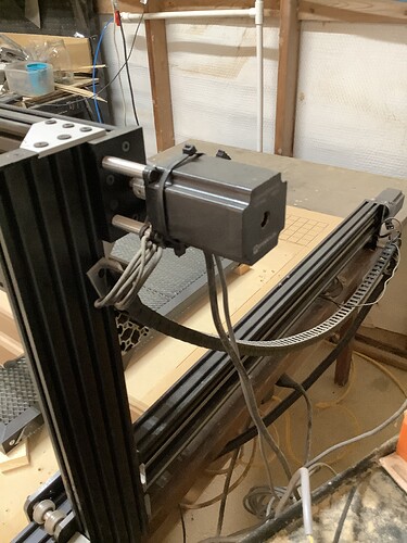

That’s a serious looking stepper motor. It looks a lot like the same kind of lead-screw that moves the Z-axis, but I can’t tell for certain at this end.
This end looks a lot like a lead screw.
Are the stepper motors all the same?

I checked today and X and Y axis are lead screw
With similar motors, drivers and lead-screws the axis calibrations (steps per mm) should all be quite similar. This is great to know and it removes a lot of guesswork.

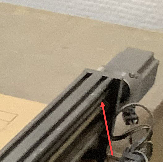

I think I will try again tomorrow it homed fine. The Z axis moves first then the X and Y together. The X axis comes off the switch but is barely touching it.
Homed again today and it did fine.I think it bounces off the switch it just stays right there on it
The engraver is set to pull-off 5mm in in each direction because $27=5.
if you’re not seeing a solid 5mm reaction the mechanism may be stiff or binding. There could be a loose screw on the motor coupler or it could be absorbed by the anti-backlash nut. Look on the x-axis screw drive - not at the driving end, but at the part that is driven (or being pushed). I would think that it’s a 3 piece component with a spring in it. If the rails are binding close to the origin the spring in that component might compress and release instead of travelling there-and-back as anticipated. The engrave head, with no spindle/engraving load on it shouldn’t be loading the spring.
It’s ok if the engravers rest on the deactivated switches. The pull-off behavior should be identical on each axis.
