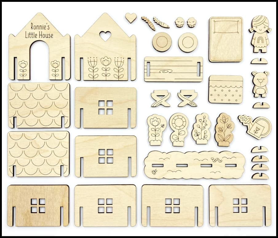

I’ve been unable to determine how people are designing cut projects. Sure, I can do it entirely manually, but surely there is a more sophisticated approach?
I own Rhino (no idea how to use it yet), Aspire and Lightburn. I have Inkscape, which is free (Also, no idea how to use it).
Anyway, I assumed that there is some software or plug in that figures out the tabs and slots, aligning and spacing them. No?

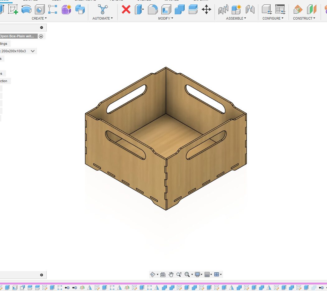

If you’re talking about boxes and other items that use finger/tab joints then there are a number of websites that allow you to plug in the various parameters and it will spit out a 2D vector file. I tend to use https://boxes.hackerspace-bamberg.de or use Autodesk Fusion.
I have also tried this in FreeCAD and although I didn’t find it as user-friendly as Fusion it is certainly capable and is totally free.

Yeah, I buy A LOT of vectors, but I’m actually talking about designing projects that interlock.

You mentioned earlier that you have several different programs, but you don’t know how to use them. The picture you referenced is an SVG file found on Etsy
In order to design something like the picture from scratch, you need to develop some design skills.
