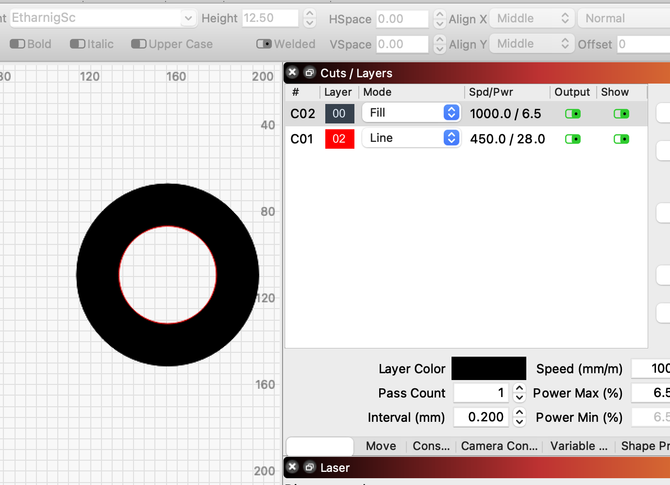

I am trying to create a circle within a circle. The outside circle is to be engraved (or shaded) and the circle within this shaded shape is to be unengraved or unshaded. Any hepl would be appreciated.
You can make a small offset of your inner circle and assign this ring a new layer. The outermost is fill the innermost line type.
Try turning the individual layers on and off to see the effect, if that’s not what you mean you just come again.
Ian1.lbrn (59.9 KB)
Make it red. All shapes on a single fill layer define what gets filled by that layer. No other layers are used when deciding what happens to this layer - they’re completely independent of each other, so what Bernd suggests is good - if you hide all other layers, you’ll see what the current layer will do.
