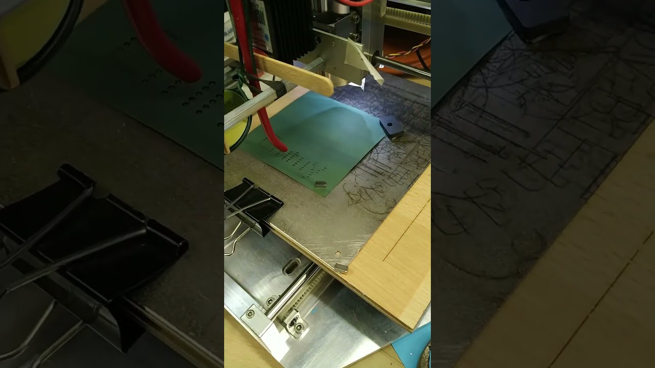

Maybe you can check out if you can misuse the new function of grbl plotter :slight_smile:
Thanks but it looks like this technique can only do the same sized dots unfortunately
