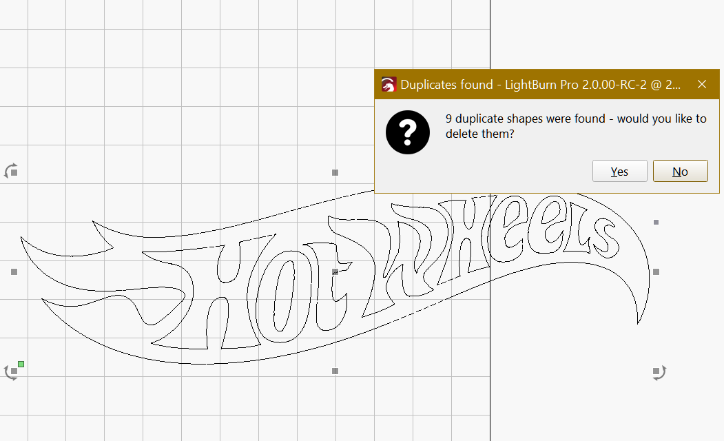

There are duplicates:
That (duplicate shapes) will cause problems, for sure!
My LightBurn didn’t find any duplicates. I also ungrouped everything and moved the letters around, there were no duplicates.
But I might have checked with 1.7 instead of 2.0. Could have been a glitch.
Edit: just checked. My 1.7 and 2.0 do not detect any duplicates. But it looks like you are using the Linux version? I have to test with that one as well.

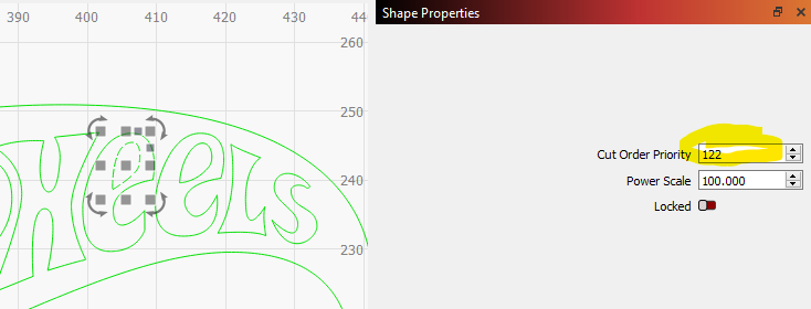

The problem with your file is that you have the following optimization enabled:
  • Order by Priority
AND your shapes all have a unique priority value applied. There are no duplicates, but you have told LightBurn explicitly to process every shape in the original file one-by-one.
How did you get this file into LightBurn, and did you set these priority values yourself?
If you open the Shape Properties window, select everything in your design, and type “0” into the Cut Order Priority value, it’s fixed.
