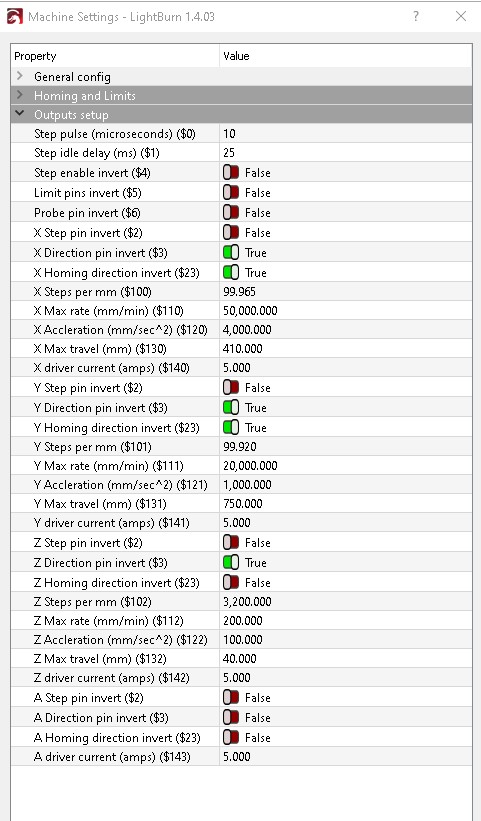

Some of my settings:

Here are my current Machine Settings:
Screenshot 2023-10-30 132434
