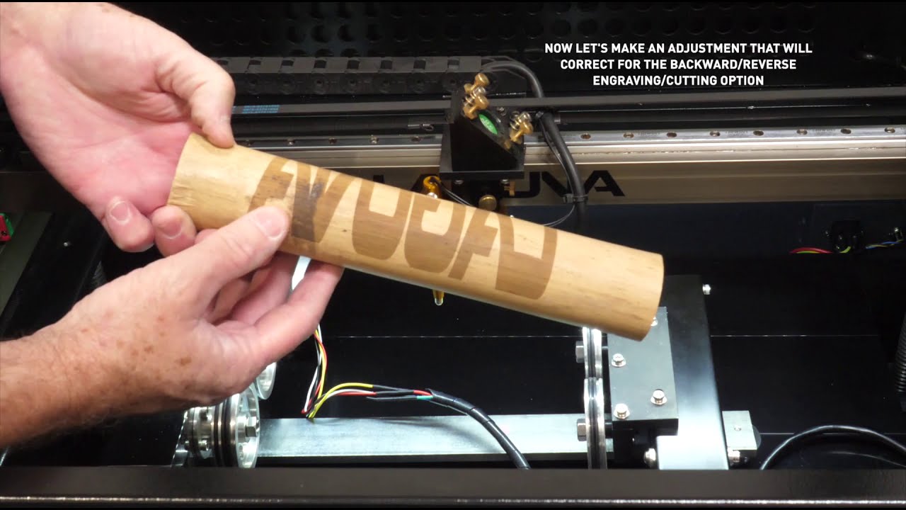

Also, this is a Laguna Tools video, yet for a different system than yours. I include as many of the steps are going to be the same, so also worth review.
