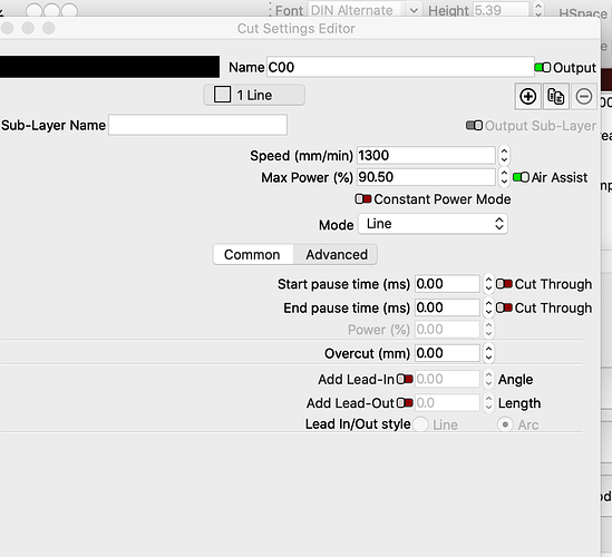

also note in the “common” settings tab the speed and power adjustment.

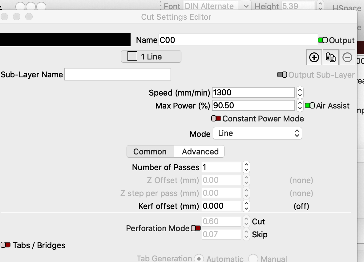

Open the Layer settings and one of the options is scan angle.
Try setting it at something besides zero and it will affect where the engrave starts at.
You can see in the preview window what the results of your change is.
Set that so the engrave starts at the same corner that the origin is and it wont have to jump to begin.

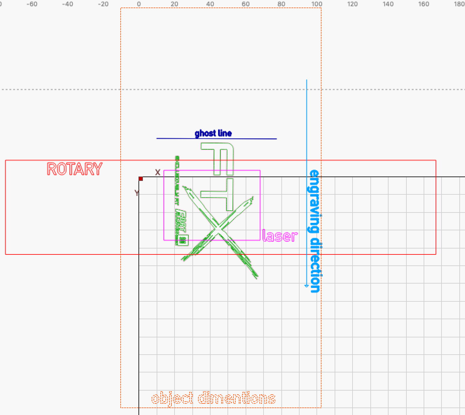

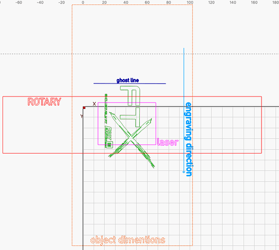

here is what i do for most of my rotary engravings just to be safe. i use a ghost line near the start of the scan direction and parallel. gets the laser head closer to the starting point. run this ghost line at low power like 0,01% and slow ish. also check the cut priority to make sure this line gets done first. you can right click on the line and click shape properties and change the priority to 1 or have it sitting first in the cut layers, double check by playing preview.
i really hope this helps @Thelaserjacks

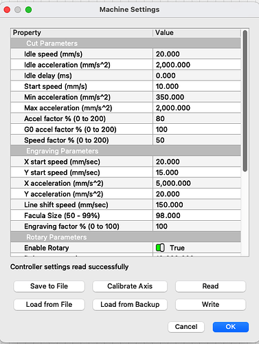

You will have to go into the Ruida and slow down the axes.
I noticed your start speeds are pretty fast. I don’t have the machine up, so can’t look… Start speeds work with min/max power values…
On mine the jump off speed is down to a single digit… lower acceleration. I have reduce all the Y axes speeds when using the rotary.
Make sure you save the current configuration and after you modify it, save it for re-loading later for the rotary…
I switch configurations when I use the rotary.
Lower the idle speed, I think it is… one of the first items in the cut menu on the Ruida. This should slow the seek speed at the start of the job…

No, I use the machine settings…
For every rotary device I have, I have a different machine settings file.
A vector operation on the rotary has substantially different values than an engraving where the item isn’t spinning around back and forth…
A chuck and wheeled rotary, both have different machine settings… the wheeled rotary is more sensitive to acceleration and speeds.
I get them to work, then save them as a machine setting file, named some way so I know what they are. I can read/write to the controller for any of the rotaries I have… Don’t forget to have a normal file, you can reload when going back to normal operations…
When I change operation to a rotary I load then write it to the controller…
You can change any of these, but I usually don’t recommend changing some types of values that are inherently hardware settings…
