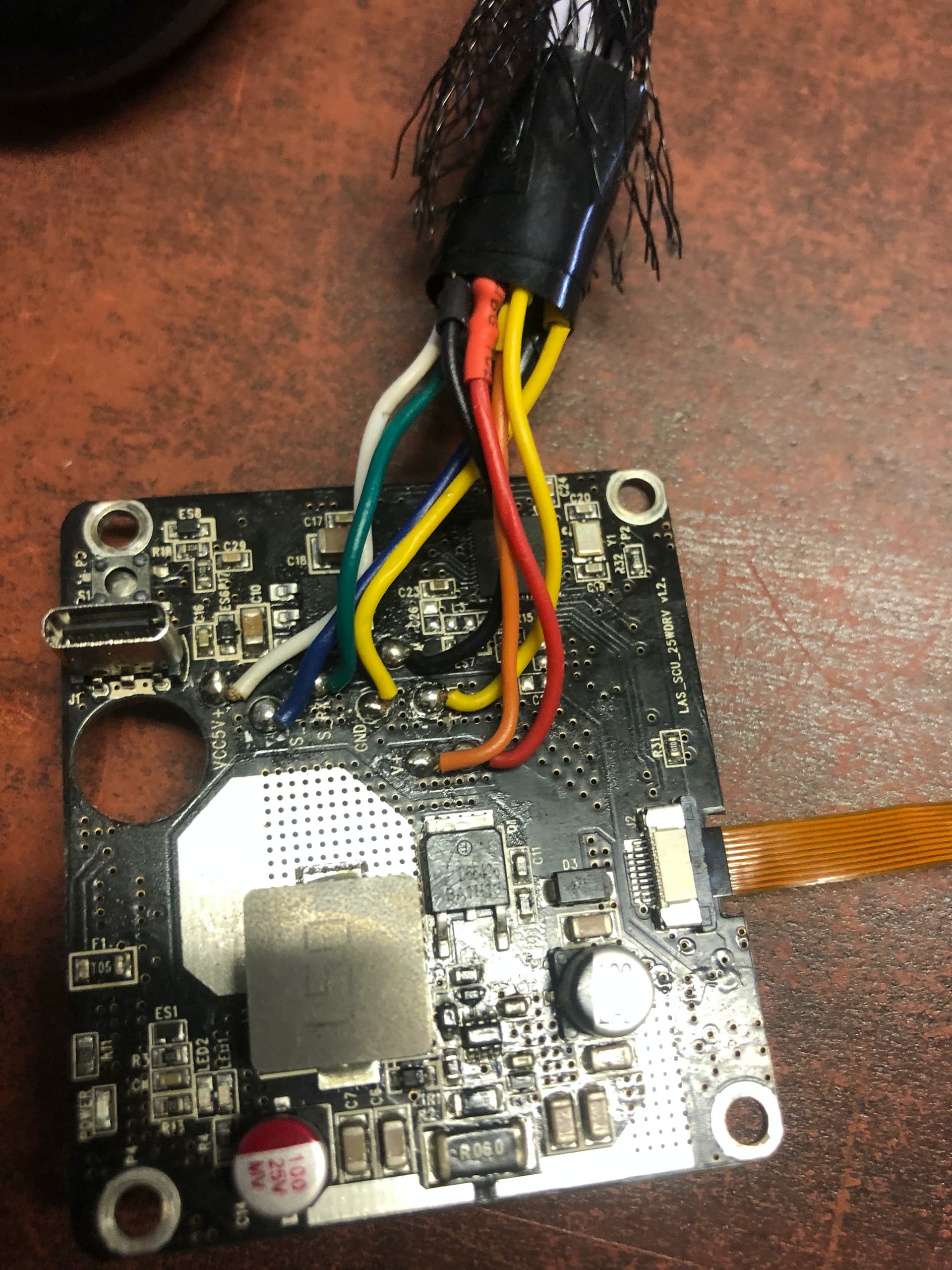

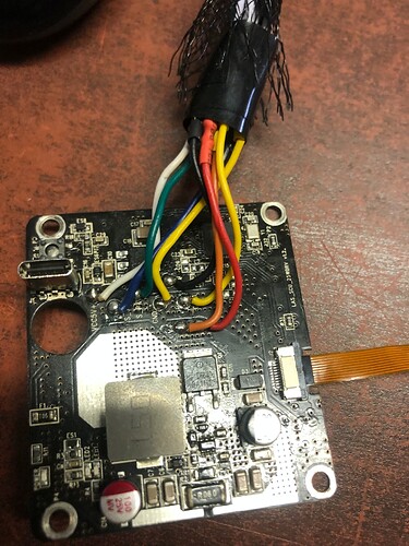

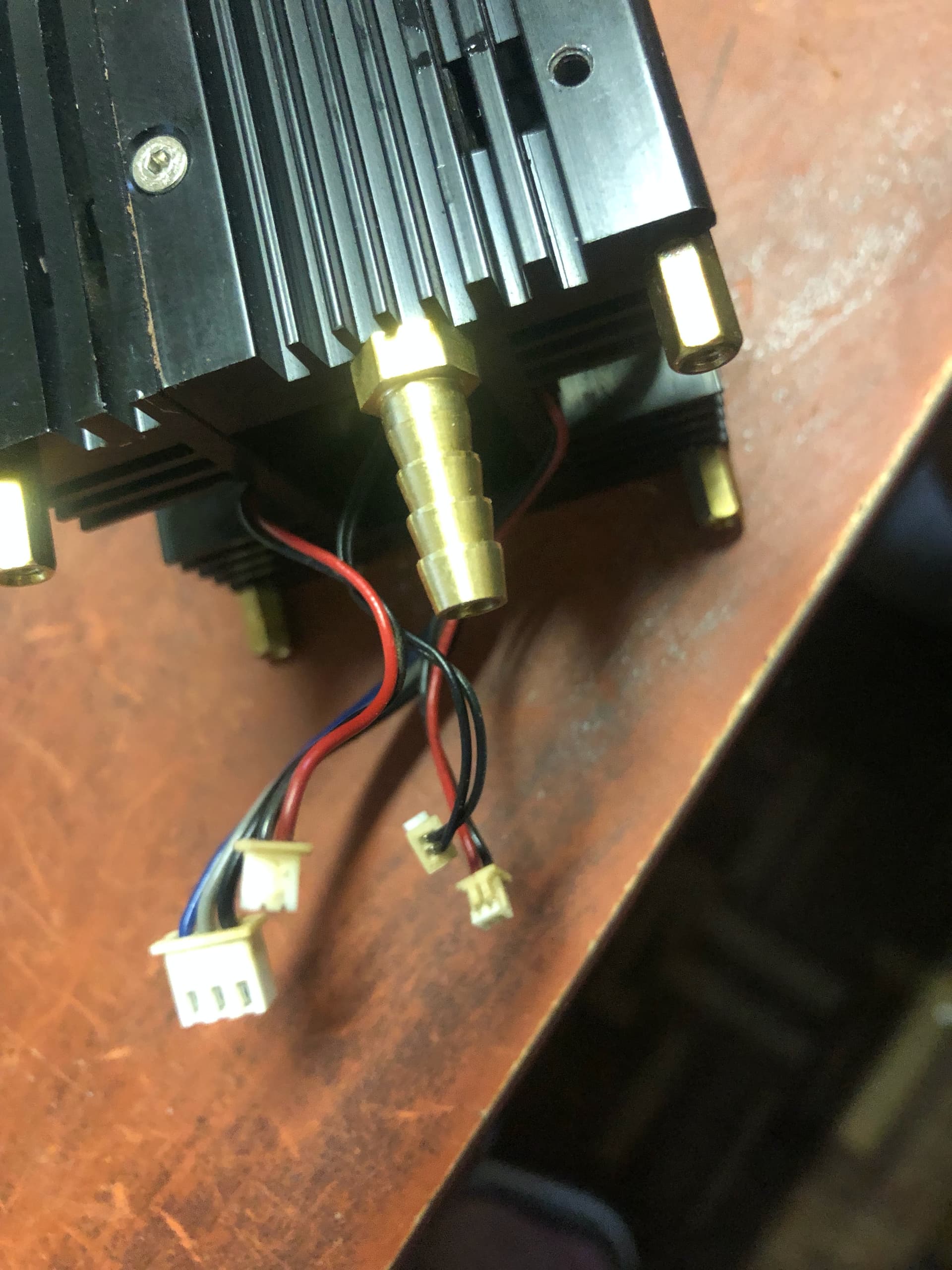

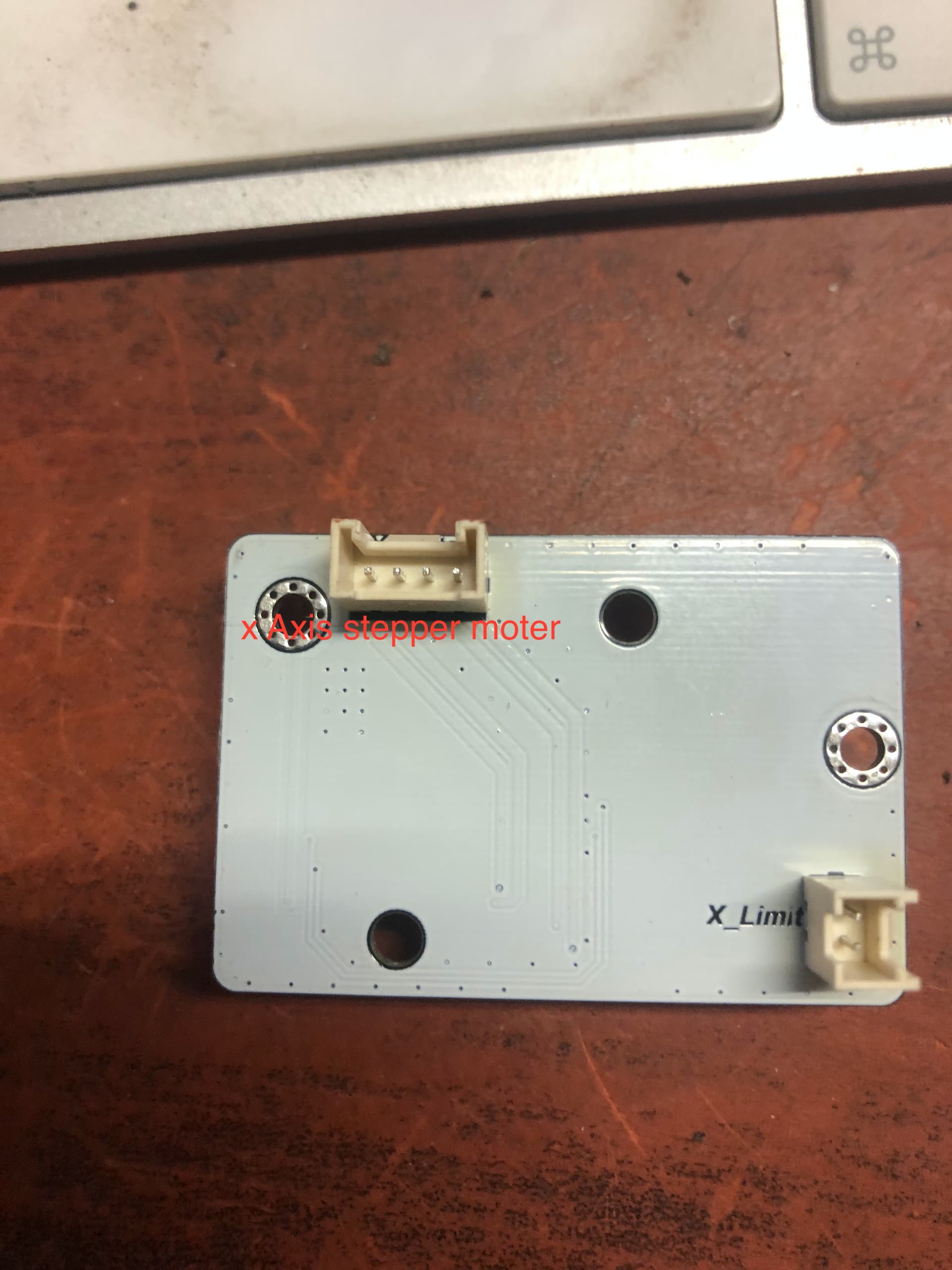

Jack is right the laser module had a cardboard fire and it burnt main cables to controller board, so what i was thinking is taking a 2 point approach test the laser module first so see if there is power and the diodes come to life then work through all the sensors and the fans are working so that’s a good think,
so i see that the 3pin connector connect to the main laser module board
have attached more pics, just need to work out which wires up where on the laster pins

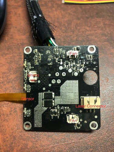

Here is the top of the board :grinning:

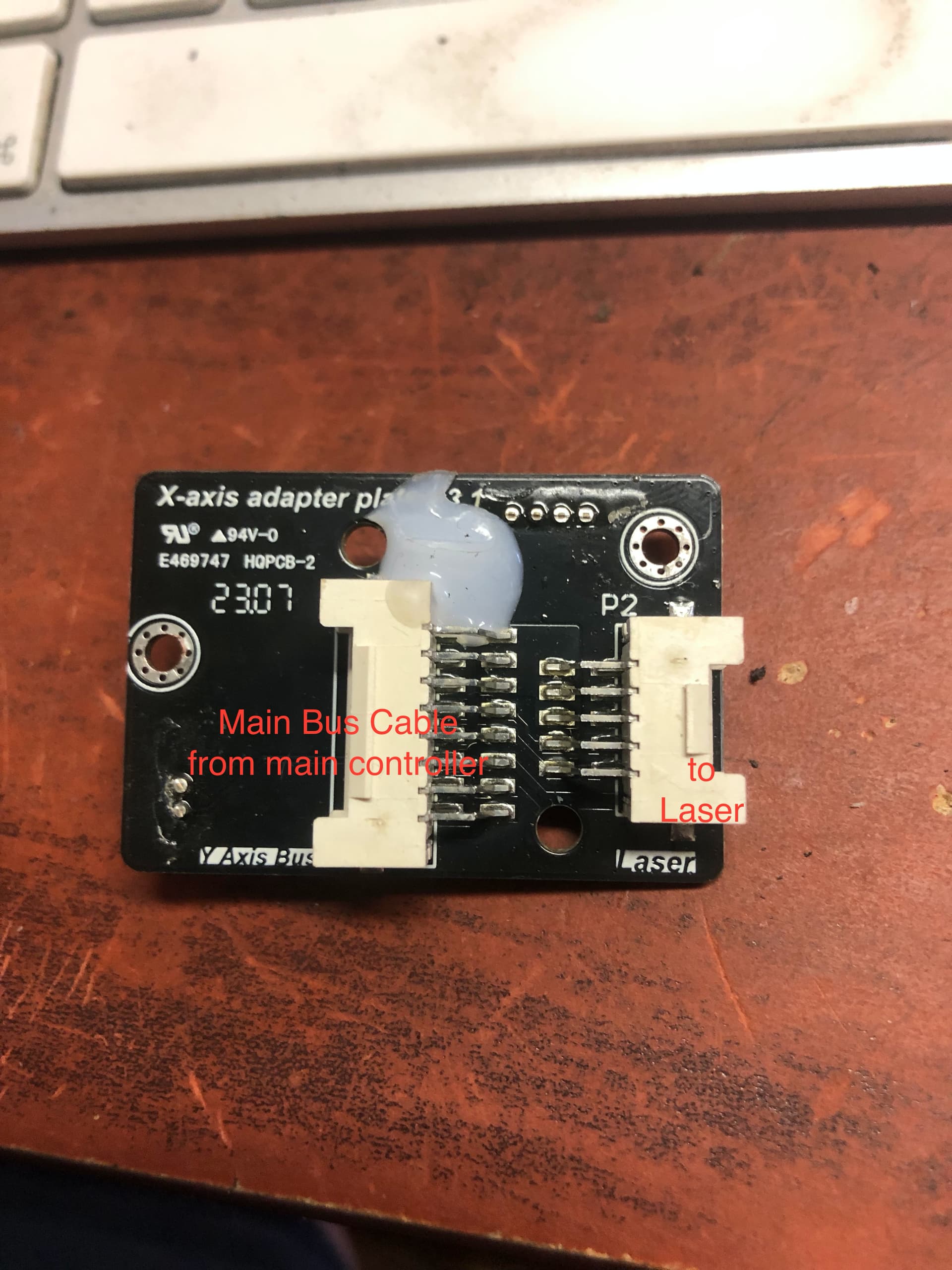

So the 8wire cable that from from the above controller connect to this module attach below, so what best way to test power i am sure i need to find a 24v output i assume

The problem, is you are inside a produced module with nothing to tell you how it works and what it does with it’s own electronics…
The adapter in the last photos looks like the group of signals go to that board and the X stepper, limit switch and laser are broken out separately.
Without any documentation… my only suggestion.

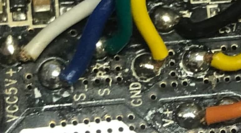

The wires on this pcb are marked on the board itself, they have some signal names such as 5V but most I can’t read. That might give you a clue to what’s ground and what’s a certain voltage.

So what i have been able to ascertain is that the wires onto the board are as follows
White - vcc5v+
Blue - S tx
Green - S rx
Yellow - GND
Yellow/Green - GND 1 still trying to confirm will bring out stronger magnifying glass
Black - M not sure what this is
Orange - V+
Red - V+ too i think look will confirm through magnifying glass
@Creality_Rachel hope you are able to provide other isn’t if you are able too please
It appears to me as part of it is a serial buss for tx and rx signals.
It could be as simple as a buss for the temperature sensor to communicate with the cpu, or it could be multiple devices on the same buss… doing who knows what.
The only signal that is left is the unknown black wire, but from the real lack of any kind of controlling signal for the laser, I wonder if you’re going down the right path.
Even with a scope, you don’t know how or what they are communicating…
Might just have to put it back together and hope it works.
Was thinking just to test the laser head use my 10w Creality falcon, power cables for source power ground and vcc5+ but unsure
If it’s put back together that should work… if it’s going to work.
I know of no way to test each board or just the laser part of the module.
