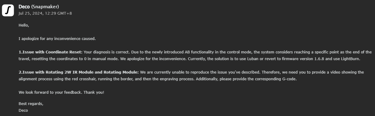

  1. With every move of the head in Lightburn the console says the position and coordinates are being reset because “disabling motor” expressed as:
    [I][PLAT]reset sys pos and WCO because disabling motor
    [I][PLAT]reset coordoffset
    So with the offset required to work with the ray (I’m talking about having to enter “G10 L2 P1 X0 Y-400” into the console in Lightburn) my home and start position is X0, Y400. If I set the move steps to 100mm and move Y-100 when it gets there it resets back to X0, Y400. Lightburn will show X0, Y300.
    Now if I move along Y the same direction it will show X0, Y300. If I move the opposite direction it will say X0, Y500. If I move along X it will say X100, Y400. If I move it back along X it will say X-100, Y400. No matter where I am in the bed, if I hit Get Position it will tell me X0, Y400.

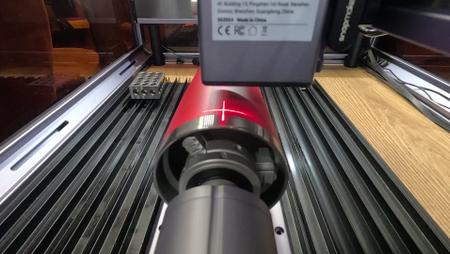

  2. When using the rotary with the IR module (which requires using the crosshair) it’s not aligning with the start position. When I set the crosshair exactly where I need it to be and start the burn the gantry doesn’t move at all to account for the crosshair offset. What’s more strange is once the burn is done the gantry moves back as if accounting for the crosshair offset. This means when I start a burn it starts burning on the edge tapering off the side of, let’s say, a cup rather than the gantry moving up and over to put the laser where the crosshair was located. Then when it finishes burn the edge of the cylinder the gantry moves the head’s crosshair to the location where it was incorrectly engraving.

In the #2 item about the rotary, I knew something was wrong but I did not know why. It finally soaked in. Are you saying the gantry moves in the Yaxis when the Rotary is enabled? This implies Lightburn is a 3D software, which it is not. I would not expect predictable results using Lightburn if this is what your machine is actually doing. Please tell me I got this wrong.
In my video we are looking down the X axis. It should move along the Y to align where the crosshair was but it’s not doing that. The crosshair will frame the area correctly but then when it starts the crosshair offset is completely ignored and burns off to the side.
Then once it finishes the crosshair moves even further outside the area even past the incorrect burn location (although this is kind of expected since Snapmaker said this was a known issue). I can deal with the strange move at the end but I absolutely need the laser to align with where the crosshair is on start. This is the IR not the blue diode. I cannot turn the crosshair offset off and make alignments with the laser only. I will engrave the surface at 1% power.

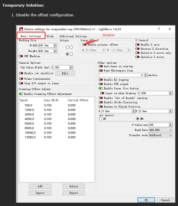

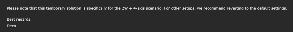

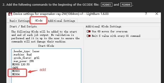

Snapmaker Support has provided a solution (I haven’t tried yet due to being at work). I will confirm this works later this afternoon.
