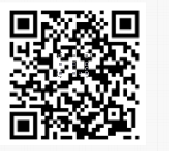

Your open shape is a stray line hidden in the Instagram QR Code.
When you get the warning, click “show me” and it will highlight the open shape(s), then you can delete or handle however is necessary. Here is the preview after deleting the stray line.
You have a spurious line behind the Instagram QR code. If you delete this it previews without error.
