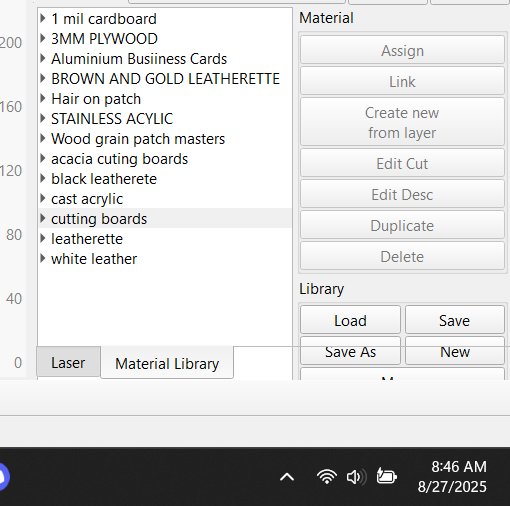

as you can see in the screenshot i cant figure out how to fix the overlay of the library, and i cannot access the bottoom button

Make sure the LB window is maximized.
ednisley
(Ed Nisley)
3
Set the Windows Task bar to Auto Hide to reclaim some space.
Reduce the number of small windows stacked up vertically; smaller screens may have only enough pixels to display a single window.
For high-resolution screens, do the High-DPI adjustment:
If none of those help, a screenshot of the full LightBurn window will help track down the problem.
