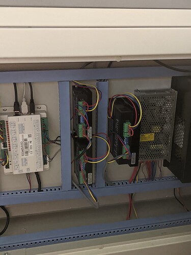

Look in the electronics cabinet and locate the controller… It should look similar to mine… Mine is a 6442g model… If LED 9 is not lit, it’s not active… If you have water flow, it should be red… if not the issue is before the Ruida, switch or wiring… If it’s active it may be a controller issue… This only take and instant to detect, so it might just be flaky.

Thank you very much for your reply. My issue right now is that the laser partially turns on. The only red light on is 15 and a blinking 14. The red beam on the head is on and the controller says SYSTEM RESETTING and than that goes away.

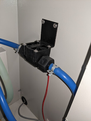

Do you have a CW5000 chiller? They look like the one in the link below. If you do, chances are that the flow switch that others have mentioned has failed. This in a fairly inexpensive part that is available from several on-line vendors and looks like this:
It is a little complicated to replace if you are not mechanically/electrically inclined but is doable by a competent handyman. Where do you live, in general? Perhaps someone hear is nearby and could help.
If the WP led (9) is not illuminated you have a protection issue… It’s the switch, the wiring or something, but it’s not getting to the Ruida… That will produce that error… How do you know the chiller is working properly… what kind of chiller…?

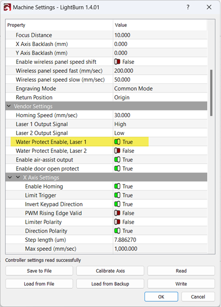

If you think the chiller sensor is faulty, and you know that the chiller is still working and you can still see the water is flowing through the tube, you can temporarily disable the water protection alarm at the Ruida, so you can continue to work while you wait until the new sensor is fitted:
Unplug the sensor cable at the back of the chiller.
With the laser on and connected.
In LightBurn, go to Edit > Machine Settings > click on the ‘Read’ button.
If the controller settings are read successfully, then ‘Save to File’, a backup of your settings.
Then toggle off ‘Water Protect Enable, Laser 1’, and click on ‘Write’ to upload this change to the Ruida.
Click on ‘Read’ again to check the update was successful.
Push the Reset button on your controller to restart it.
That should allow to to continue to use the machine, remember to re-enable this setting as soon as you can!
Temporarily disabling and disconnecting the sensor will also help troubleshoot your issue with the controller randomly resetting itself, which does not normally happen.
Note, the Water protection sensor may also be connected to the power supply for the laser tube, if that is the case then you still wont get any laser output and you should just re-enable the setting and put the sensor cable back to how it was - but before you do that try running a job anyway and although the laser won’t fire it will still be very interesting to see if the job goes through all the motions without the controller resetting.

Ok – I found the part in the side cabinet.
Is the part in the thread going to work? It looks a little different.

Can you post a link to the purchased item? It looks ok, it should have two wires… flow meters have three.

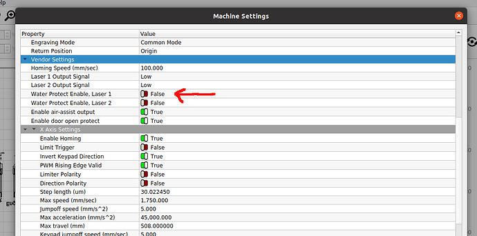

If you are completely 100% satisfied that the coolant is flowing, through the tube, you can disable this as @NicholasL mentioned to see if it will run…
Anytime you disable a safety feature, you are the responsible one…
These are in edit → machine settings
I marked it in red… Mine is disabled because the input failed and I moved it to the door protection, which I have always had disabled…
You can at least ensure the machine will operate if this is the issue… It should run with this set to false.

UPDATE – I think my laser is toast. Replaced the sensor. Was still getting water error message so we switched and hooked red wire to red and black to blue. The control finally came back to normal and I saw the last job I ran. But no cabinet light and no laser head moving. In the mean time we had the electrical cabinet open and only number 15 was lit and a blinking one next to it. It started smelling like “electrical”. And all of sudden pop the controller and the metallic box next to the black laser box blew out and smelled fried. both were very hot to the touch.

It might simply be the low voltage supply that has gone…
Can you post a couple of photos?

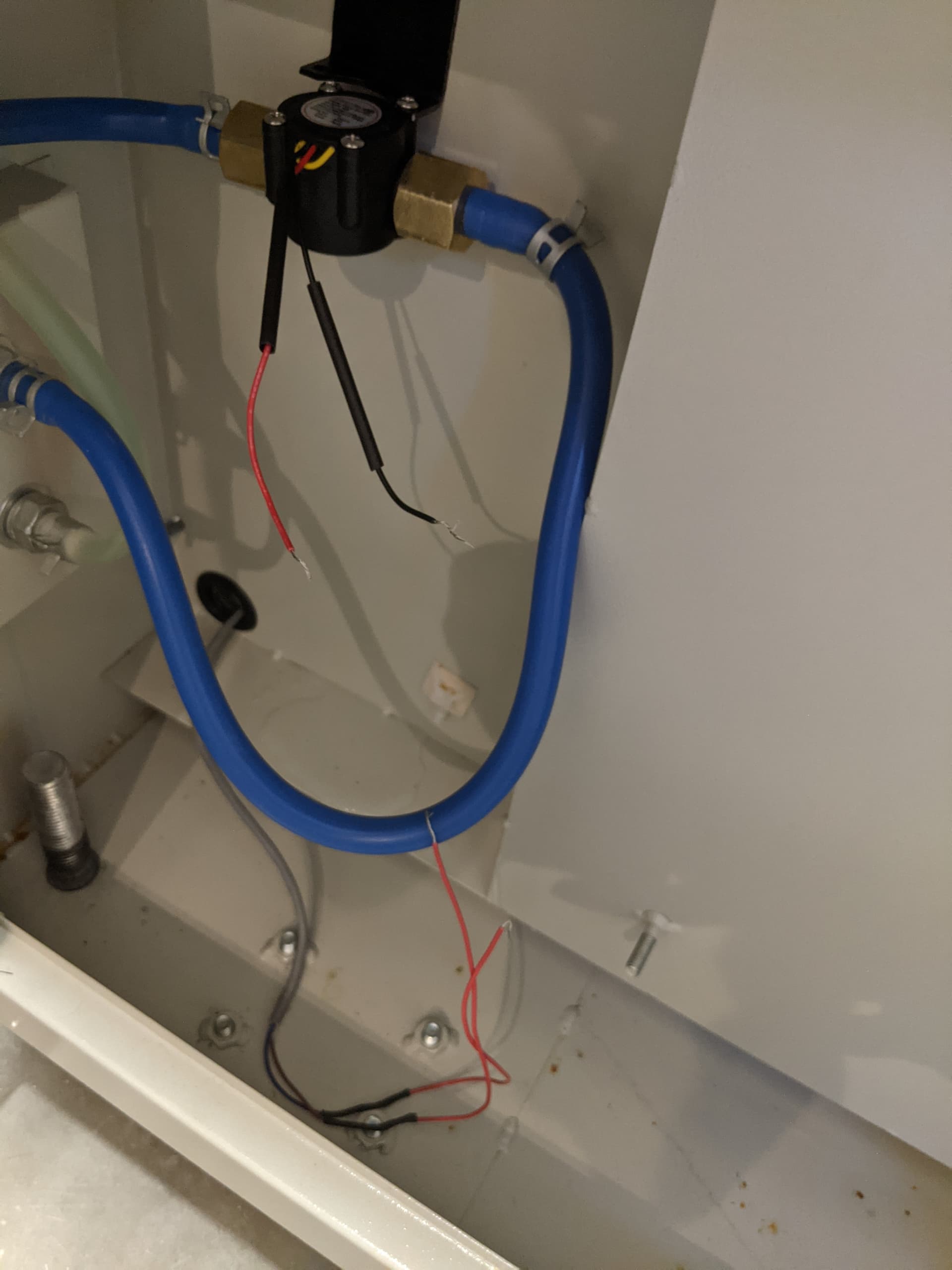

My guy didn’t want to solder the ends until we knew they were good. It wasn’t easy to figure out which wire was which coming out of the cabinet. So this show them now disconnected.
The other is my cabinet. The left and right box each had a light on until the smell and pop.
