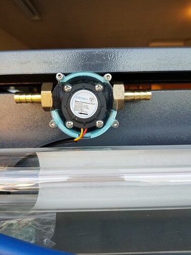

It appears to have three wires… Like my flow meter does. It does have a Black (hard to see), Red and Yellow connector. The black and red are for power…yellow for signal, pulses/liter.
This does not work as a coolant switch will only give you flow rate if you wire it up to a computer to read/compute the pulses.
The coolant switch just closes to ground, so unless something else is happening it should have no effect on the machine, other than not work.
Please send a link… of the switch you purchased.

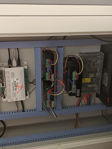

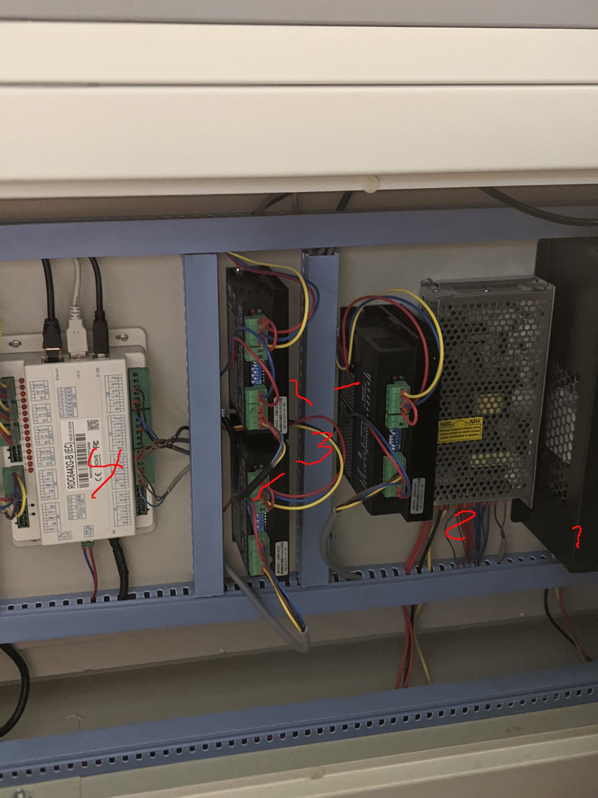

1 is the lps (laser power supply)
2 is the 5V/24V psu (power supply)
3 is the set of 3 motor drivers
4 is the Ruida controller…
Was it the psu that smoked?
Here’s the link to what was purchased:
https://www.amazon.com/dp/B00VKATCRQ?ref=ppx_yo2ov_dt_b_product_details&th=1

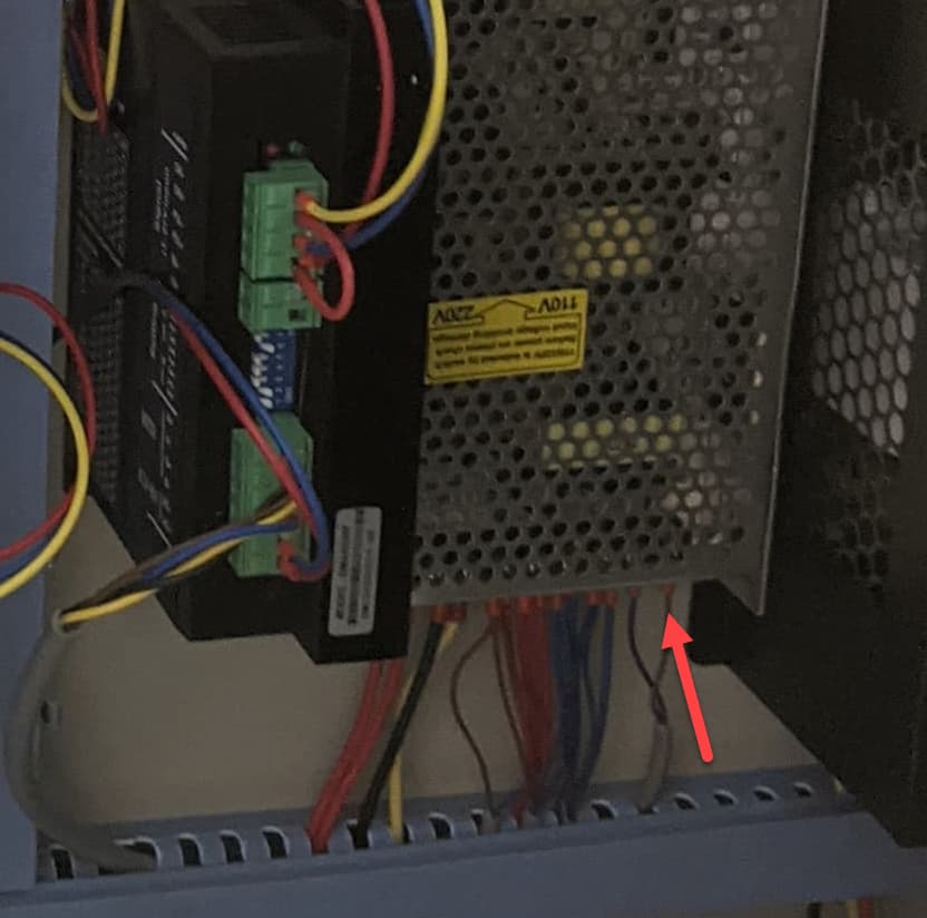

It happened very quickly. It wasn’t smoke — it was more the smell that got noticed. As I was looking at the cabinet to see where it was coming from - there was a popping sound (like when something shorts out) and the controller panel went out as well as the only lights that were on down there (1 green in #2 and 1 red on #4). But #4 and #2 were very hot to the touch.after it popped.

The link is to a flow meter not a pressure switch.
This is the video from OMTech… They do not sell this sensor. I hunted around on the Internet for a similar looking one, but came up empty.

One is the Ruida, 4, and the other is the 24V supply, 2…
You have to look at what kind of voltage and current that supply is and purchase one with the same or greater voltage/current rating. Look at amazon or ebay… Don’t go cheap, some of these Chinese power supplies have a floating ground… meaning it can make the chassis hot.
You can also unplug the Ruida from all connections and check the power supply for the proper output voltage.
I’d assume the Ruida is OK and the power supply is faulty… mainly because the supply is low cost and the Ruida is a few hundred dollars.

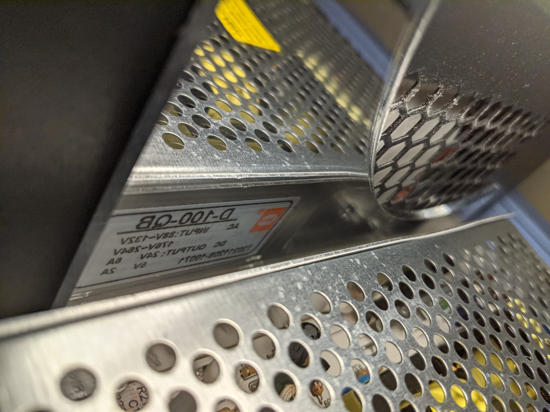

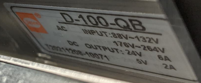

I don’t have a tech guy that’s why I’m putting out the SOS for any tech guy to help. If you mean the guy yesterday – he is a friend who is handy but just knows very very basic electronics (if that). I would pay for your time and mileage to see if you could help me. I’m waiting for China to text me tonight with their idea of what to do from here. In the meantime I slid a mirror in and was able to get a photo of he power supply sticker. I can’t make out the mfg. but is this enough to find an equal part. Any suggestions where? I came across Jameco. But getting this PS – will my laser turn on? This looks scary to me and I would not attempt this at all.
I guess you need
a 24V at 6A that can also can provide 5V at 2A…

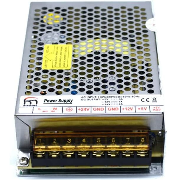

Took ten or twenty minutes to find this one on Amazon, but it’s power output isn’t what we need. It provides plenty of 5V current, but is an amp shy with the 24V output… these are labeled above the GND terminals…
Sounds like I may have to get it from Monport? Unless they can find one here in the states.I have asked richfaraone who is in this forum if he could help with a source. Not sure if he’ll answer but praying.

I’d try and ask them if you need 6A at 24V… They probably have a boatload of these and they put the same basic supply in all of them… A lot lower cost than separate supplies for the various machines. If their biggest machine only used 6A, maybe the smaller ones can get along with less…?
The only real way to tell is add up all the things that use 24V for a total.

This is a different question. In your laser do you have a power supply (in a metallic cage with holes)? I’m trying to find this power supply which is difficult because it’s 6A and everything is 5A. Thank you

China answered and they said it is that power supply but seem to be having trouble finding which gives me a great feeling UGH. They said it must be 6A. But no one has told me what would cause that to heat up (as well as the controller) and “pop” The water was installed, laser turned on, controller still said SYSTEM RESETTING" which went away after a minute and my last job appeared. But no lights in the cabinet and the laser was dead - no motors driving the belt and homing. As we kept turning off and on it seemed to have built up heat and popped. The only lights on in the cabinet was the controller #15 and the green light in the 6A PS. My laser PS is fine. I fear putting in a new PS and it will overheat and pop again unless we know what caused it and make sure that is corrected before installing.MAybe I should get 2 PSupplys?
Most of the time when a light bulb fails, you have no warning… so it might have just bit the dust.
Worst case, you can put two supplies in there… might be easier… I couldn’t find a replacement either… I’d continue to pressure them for a resolution…
It looks to me like there is only one thing plugged into the 5V output of that power supply?
I would just replace this with a readily available single-output unit like this (24V, 6.5A):
