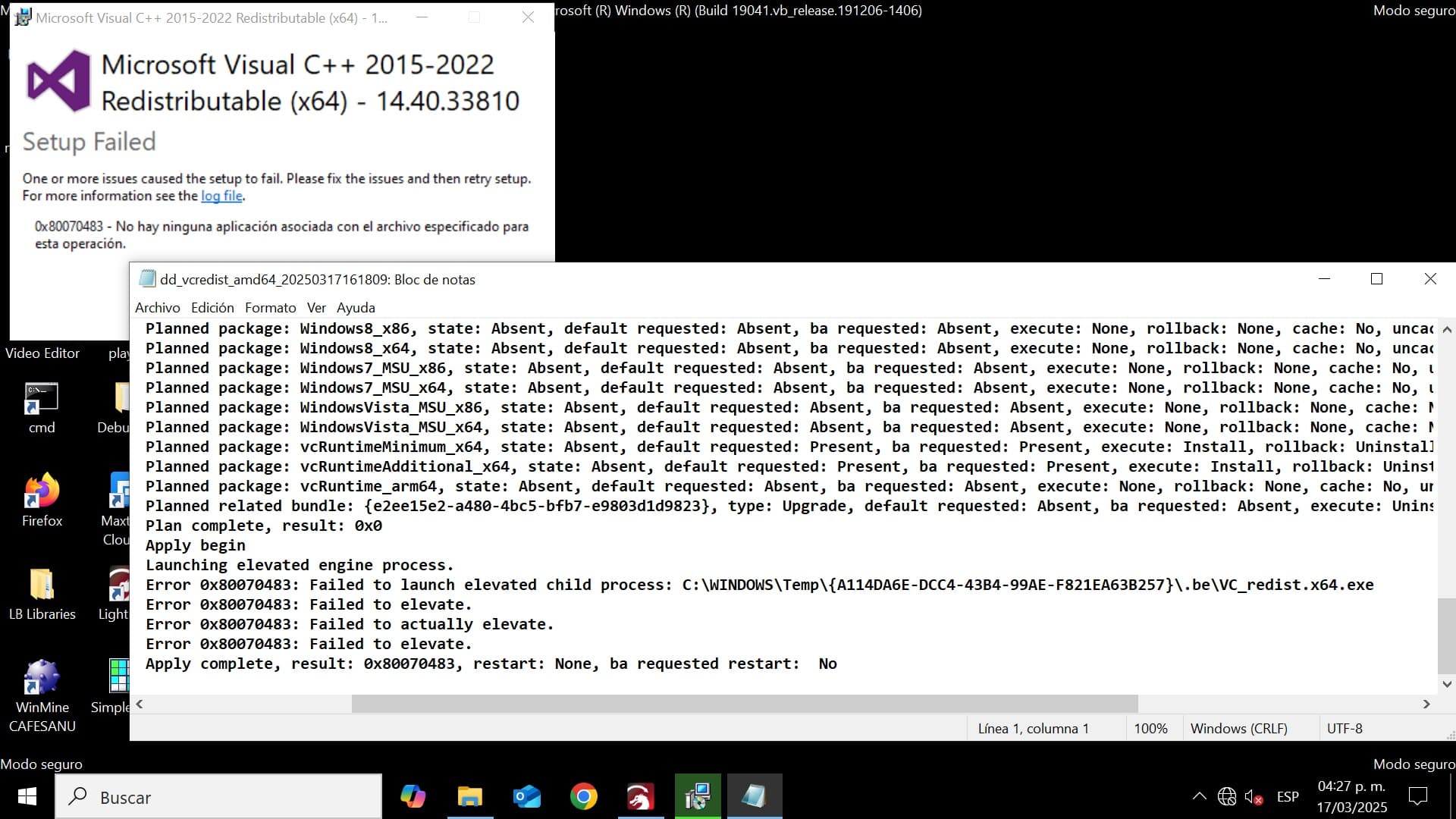

If you installed the program in safe mode and then cannot open it, then it is likely you need to uninstall the program and resinstall logged in as a user or admin.
If the program did not install at first then you should try the C++ runtime fix first. Then resinstall LightBurn.
Please install the two files below and then try again.
https://aka.ms/vs/17/release/vc_redist.x64.exe
https://aka.ms/vs/17/release/vc_redist.x86.exe
I tried installing those files, but keeps sending me this message:
