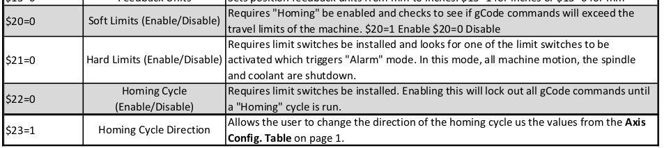

This error occurs when the home command is sent to the device, but the configuration of the device says it doesn’t exist…
The configuration is the $

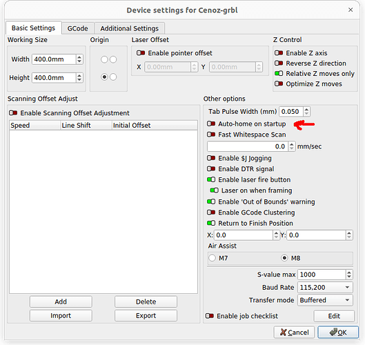

Do you have home switches?
Try changing this in the device settings… to disabled, like mine. Lightburn will send a home command when it connects if this is selected.
These variables tell the controller how to do certain things and what’s available.
These are probably already setup for your machine and shouldn’t be modified.

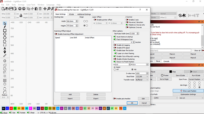

hi mate thanks for reply
i turned it on and the message Homing cycle is not enabled in your Grbl settings. came up prior to this i have not done nothing i assumed everything would be fine the only settings i changed were ones trying to get it back working i had my settings perfect to how everything is set up i dont know much about these machines so really wouldn’t change anything unless im told to by LB
the only thing i have noticed that’s changed since i have last used it is my subscription has expired
i have just started machine up again and now getting this message

If you would have disabled homing in Lightburn, it probably would have worked. Never change configuration data, unless you know exactly what you are doing…

Looks like it homes… turn on the homing with $22=1
Let me know…
still nothing :weary:
$22=1
ok
ALARM:9
Homing fail. Could not find limit switch within search distance. Defined as 1.5 * max_travel on search and 5 * pulloff on locate phases.
ok

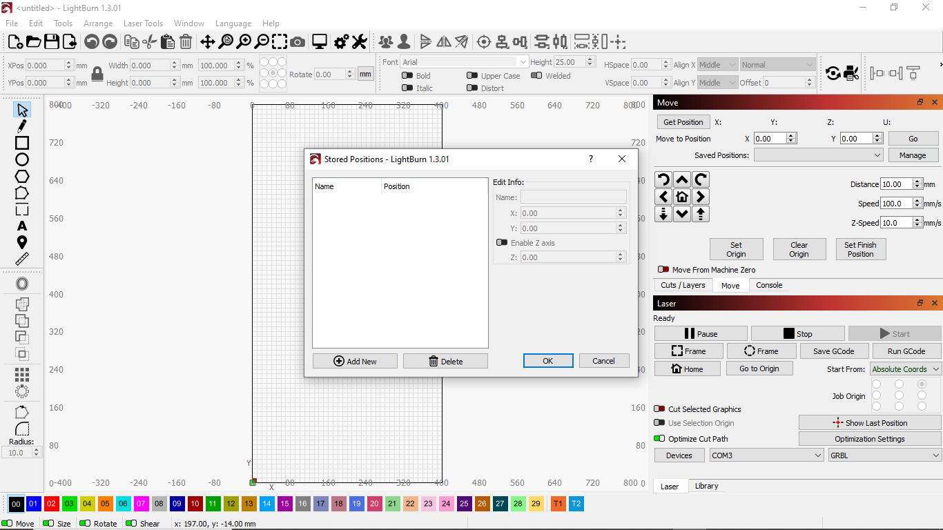

not sure if this makes any odds but i can no longer see my library and my saved positions they seem to be empty ?
i really appreciate it really dont know how it has changed i have tried loading up the LBDEV file that i used before that has all my settings on but still says the same thing
One of the problems you might have
in fact 2 fold
a) you have extension but you probably didnt extend your GRBL
inconsole type $131=800
perss enter
b) tighten your belts on Y a bit further
can you reshot the homing cycle shooting OVER the Y axis swithc?
