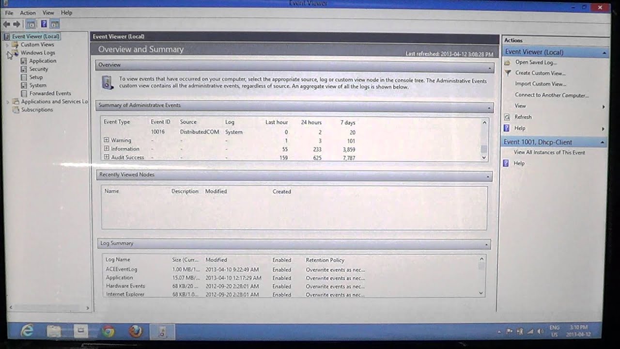

There may be a Windows Event Log that explains the program closing.
Which version of Windows is running on your Dell Laptop?
8.1 I think
Please follow this link and see if the event log can be retrieved.
Ok… I have it open… What am I looking for? Please… :slight_smile:
Ideally, there’s a Windows event that mentions LightBurn Halting.
I’ve barely touched Windows 8 so you may need to mess around with it to find the file.
This is a pretty good overview.

Not trying to hijack the post, but mine is a similar problem. I am also on 1.4.00. Only difference is, LB just randomly shuts down for me. This event shows up three times since my update in May. I followed your reply and pulled up the event viewer to find this message below:
Blockquote
Faulting application name: LightBurn.exe, version: 0.0.0.0, time stamp: 0x644947dc
Faulting module name: KERNELBASE.dll, version: 10.0.22621.1778, time stamp: 0x63f72683
Exception code: 0xe06d7363
Fault offset: 0x000000000006536c
Faulting process id: 0x0x2044
Faulting application start time: 0x0x1D9B064950CD4C3
Faulting application path: C:\Program Files\LightBurn\LightBurn.exe
Faulting module path: C:\WINDOWS\System32\KERNELBASE.dll
Report Id: c58ee327-9df0-4e29-8ee5-134ddac18982

This is really interesting. I’m not certain it’s identical. Thank you for reporting this.
It’s possible that you’re both sharing Load / Save dialog concerns.
LightBurn makes backups to recover lost work and saves preferences out whenever hardware settings are changed.
Please test this setting. If this does not resolve the crash we’ll take another approach.
