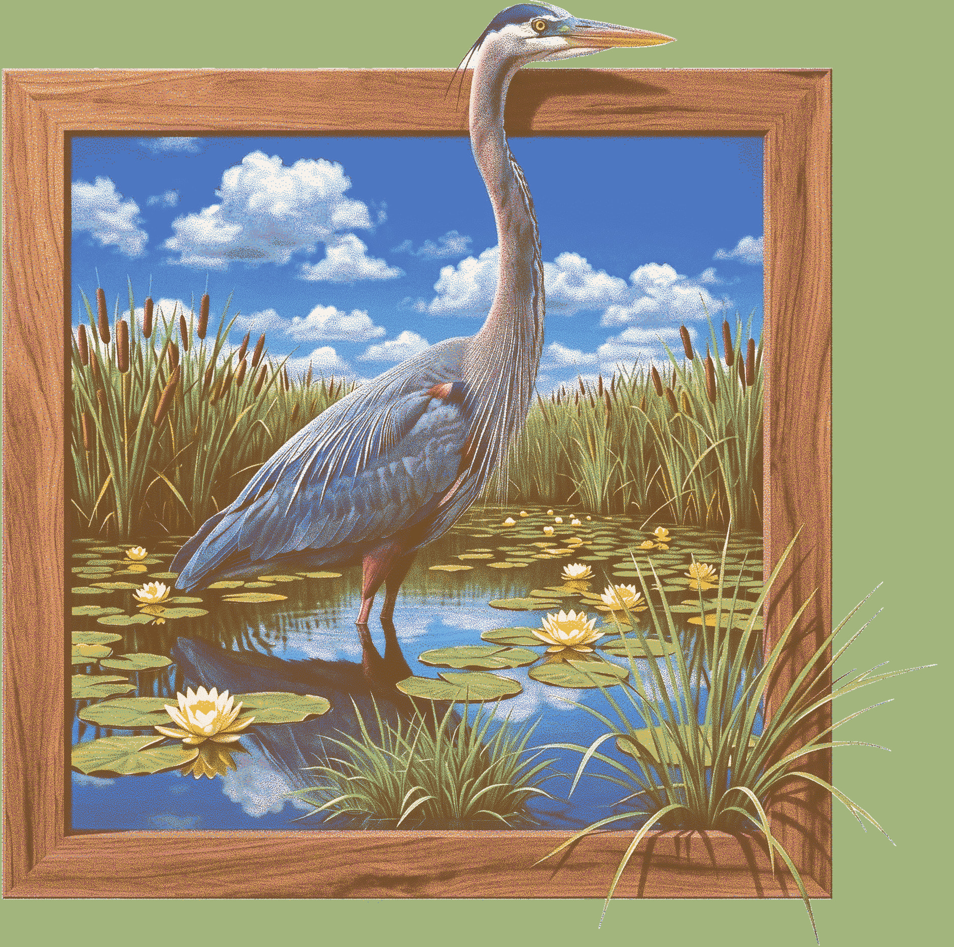

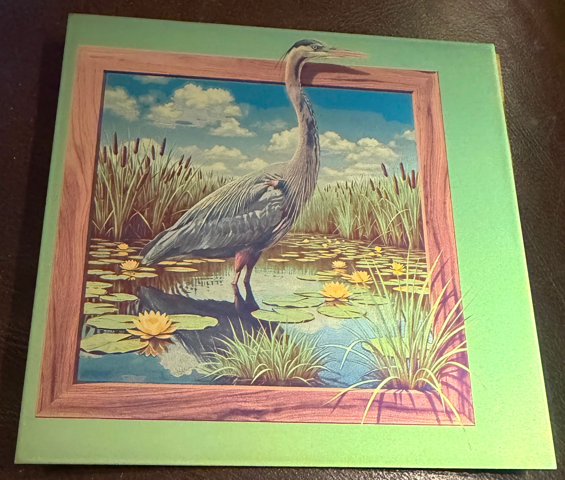

Inspired by this post, I decided to try making a 3d effect myself. It’s a great blue heron. It’s not nearly as cool as the other one (AI, not a photo, and I don’t think the 3d is nearly as compelling in mine), but I’m mostly pleased with how the metal recreated the source. I made the image using Nano Banana 2.
The biggest defect I see is banding in the sky (way too abrupt transition from lighter blue to darker blue where there should be a smooth gradient). I’ve seen this before but not as clear cut, and I think this one will be a good test case for me to try to address this banding challenge. I think there is some of the same effect on the bird’s neck and body, and I’ll look into why there is a light band just under the bottom edge of the frame on top.
Here are: the source, the metal prediction proof my separator script produced, and a photo of the result. I did cheat a little and hand-edited the silver and cyan layers a tiny bit to restore the green the little patch the “remove the background” feature of the separator missed.

My “manual adjustments” involved tweaking parameters in the separator script. I have been tempted to do local adjustments, but I am trying to avoid labor-intensive special cases. I’m investigating the possible causes of the banding now. So far, I’ve had pretty good success finding global principles that at least mostly address the local issues.
One possible theory about the banding is that I have the wrong hues in the palette for cyan and blue, so the colorimetric engine is not dithering correctly across the boundary. But I was surprised the boundary looks so abrupt. Trying to look at it with my phone on high magnification and macro, I think I see some dithering, but the two shades are close, so it’s hard to see individual dots.

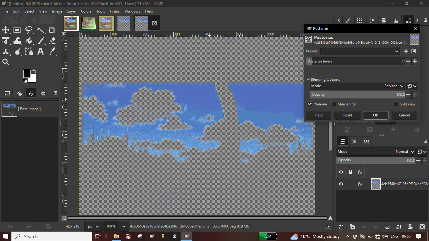

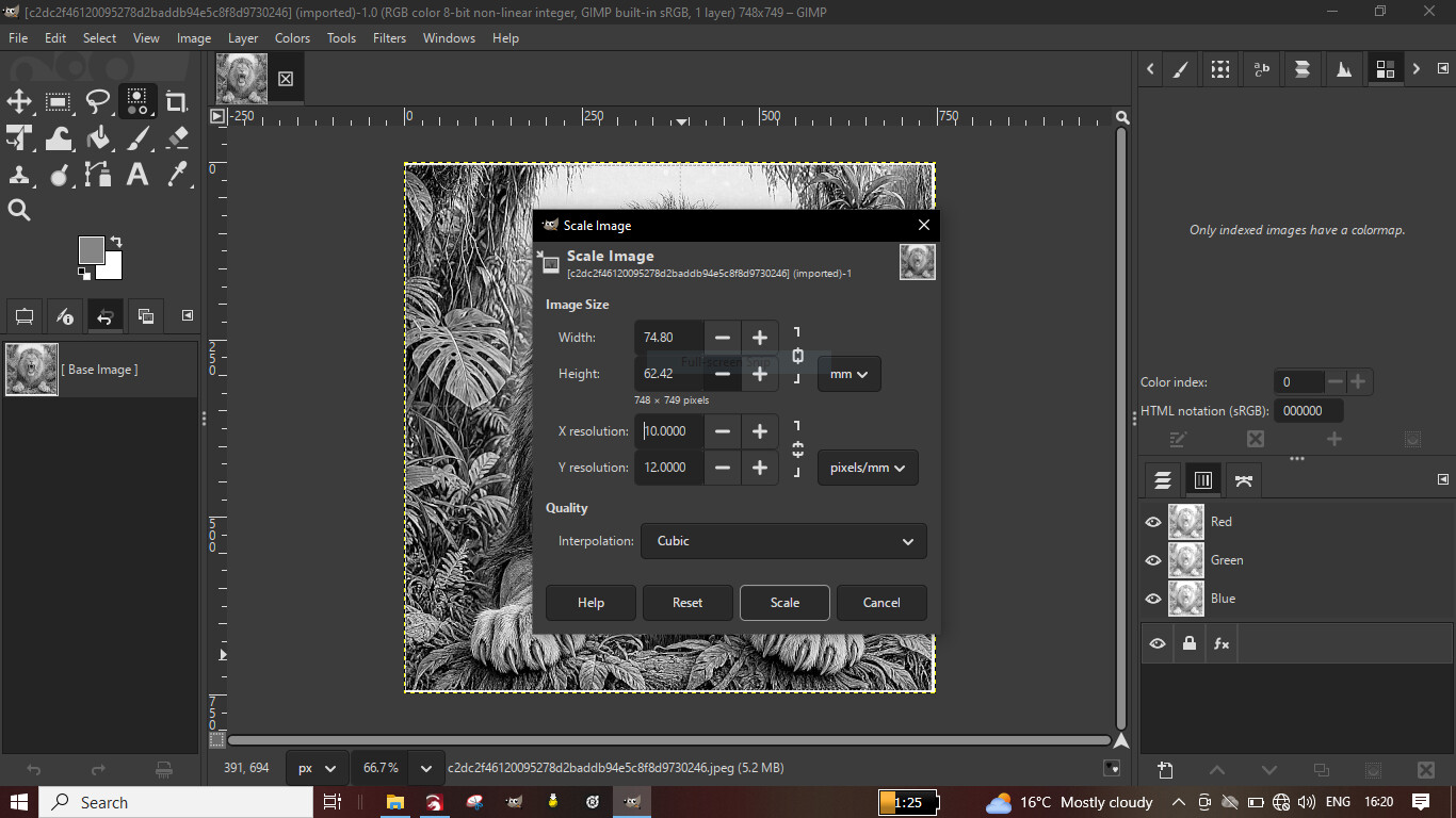

I took the crane image into gimp and applied levels. The banding in that specific area shows up at various level up to 57 levels. Here’s one I screen captured but I’m not sure how well it matches exactly.
Also a pixel dimm’s adjustment..from 0.1 to 0.12 on the x axis.
That’s a cool way to analyze the image! Thank you! I’ve never used or even seen gimp before, although I’m aware of people using it at Thayer School.
Which version of the crane image is this? I see you have the source, the photo of metal, and the proof in gimp.
The shape of the band in the sky on metal is different from this. In fact it correlates very closely with where the cyan layer ends. I went down a rabbit hole for the past couple of days investigating this and running tests. I think it has to do with over-ablating cyan so it actually produces enough heat oxide to affect the final voltage anodizing color. The sneaky part was the effect actually caused anodizing blue where cyan had been ablated to match the normal cyan color again. So it looked like those areas of blue weren’t ablating. Go figure!

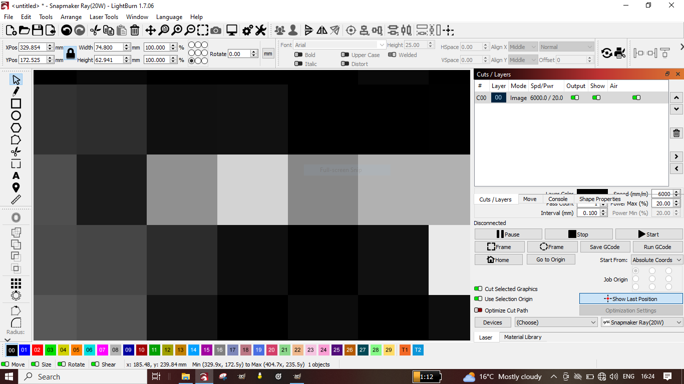

I’m making a sheet to test a bunch of ablation settings for the lower voltage layers (silver and cyan), and I already have a new feature in the separator script to segregate dots in cyan and blue layers that happen to be over silver and cyan so I can run them using lower ablation settings. We’ll see if it works, and once I have this resolved I’ll report back.

I went down a rabbit hole for a couple of weeks investigating the bands in the heron’s sky, exploring dead ends, trying things that didn’t work (many calibration test sheets), and otherwise having many adventures. Part way through, I realized that the lighter blue tracked exactly where there was originally cyan where the layers called for ablating blue (would have seen this sooner, but I was mistakenly looking at the PNGs that report where dots are supposed to end up in the end, not the PNGs that specify where to ablate). This led to the conclusion that the “blue anodizing to cyan instead of blue” effect had something to do with the fact that those areas had been cyan previously. I had noticed that there was a slight brownish tinge in those areas, and that suddenly seemed much more relevant.
I thought that perhaps I was using too much energy to ablate which was causing residue. Lowering power (shorter duration and/or lower power) didn’t fix it, and many settings didn’t ablate at all because there’s a pronounced threshold effect.
So then I thought maybe I was using too little power. Higher power didn’t help either.
After extensive test sheets, I am mostly convinced that there is no sweet spot that properly ablates cyan in preparation for anodizing blue, and this seems to also be true for ablating silver in preparation for anodizing blue. My working theory is:
  • The silver and cyan layers have oxide’s strong effect of having a "hreshold below which no ablation happens.
  • They are thin so they absorb less energy once the threshold is exceeded.
  • Absorbing less energy from the ablation and having enough energy exceed the threshold results in the metal heating enough to react with the air which leaves the brownish tinge.
I assumed the layer was oxide produced by the heat. I was puzzled how having a start on the oxide layer could end up making a different color than bare metal. I’ve learned that hysteresis effects happen from just about anything, but the impact of the brownish tinge was pretty extreme (the equivalent of 29 volts instead of 23 volts). Why didn’t the oxide stop forming roughly when the new layer grew on top of the brownish oxide so the two were at the blue thickness would would have the resistance needed to counter the 23 volts that anodizes blue? It instead went to the depth caused by 29 volts that produces cyan.
I experimented with directly coloring titanium both titanium and 304 stainless with the F1 (was surprised how well that worked on my first attempt doing small squares which I now realize are the easiest shape to color). I was surprised that the best colors resulted from using the blue laser. I’m intrigued by that approach and may see what kinds of images I can produce with direct laser heating (like Povilas has done so well). I might even try anodizing a relatively thin layer (probably blue) and seeing if I can increase the oxide depth by heating the anodized layer in selected areas. I would love to be able to develop a technique people could use to make color images using my separator by directly heating the metal instead of having to set up the anodizing stuff just to get their first image. But there are many possible ways this could have challenges. One I’m sure will arise is that temperature on the metal will be affected by the density of the dots which dithering inevitable varies. And 100mm width means the metal will have time to cool before the laser gets back to any given area. This could be another fun puzzle but for now at least I want to make some more actual images.
I had lots more brainstorming conversations with both Gemini and Claude, and eventually one of them suggested that the brownish tinge might be something other than oxide. It informed me that if the metal gets hot enough in air, nitrogen can also react. It said that if nitrogen was reacting, it was probably forming titanium oxy nitride. It might also be titanium nitride (which makes some drill bits yellow), but that requires higher temperatures and the oxygen present in the air would most likely also react). Importantly, it told me that I could determine if nitrogen was involved by measuring the layer’s resistance. Titanium oxide has high resistance, oxy nitride or nitride have low resistance. So I got out my multimeter and carefully measured resistances (gently because I didn’t want to get low resistance because I scratched through the layer). I consistently got low resistance in the brownish areas and high resistance in the oxide layers.
At that point, I realized that the low resistance areas would anodize the full thickness brown voltage oxide on top of them. Both AIs agreed that this thicker combination would likely have similar optical properties to a pure oxide layer of the same thickness. If the oxy nitride layer’s thickness was roughly the difference in thickness between blue and cyan oxide layers, that would explain the mysterious “anodizing blue makes cyan” behavior I observed.

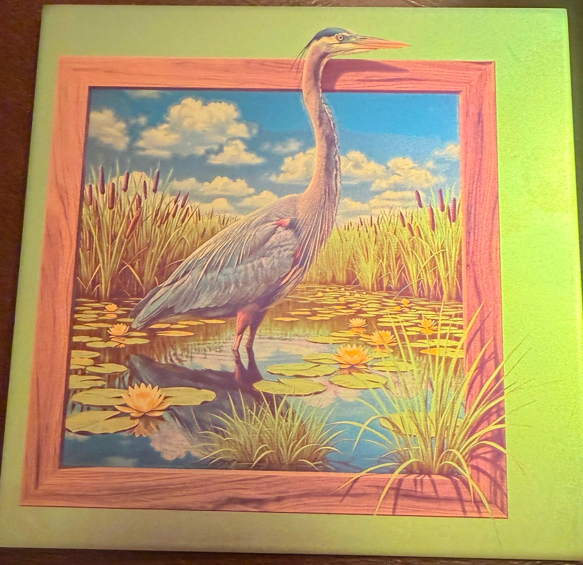

I had already made a feature for the separator that segregates the “blue over cyan” dots into a separate PNG so I could try ablating them with different settings. I realized I could ablate the two regimes of blue (areas not over cyan and areas over cyan) separately and anodize them separately at different voltages. I would anodize the not over cyan region at the normal voltage and then anodize the over cyan region at a lower voltage to grow the oxide just enough to make the combination match the blue thickness. I tried this, starting at a deliberately too low voltage (got brown at first) and increasing voltage until the boundary between the blue and blue on cyan was minimized. I think I overshot the voltage a little, and the presence of the brown seems to have affected the hue a little, but the result was a big improvement.
Here’s the result:
This investigation took a lot of time away from actually making new art, but it was a fun puzzle, I learned a lot, and I’m feeling good about eventually being able to make a prediction and see it work.

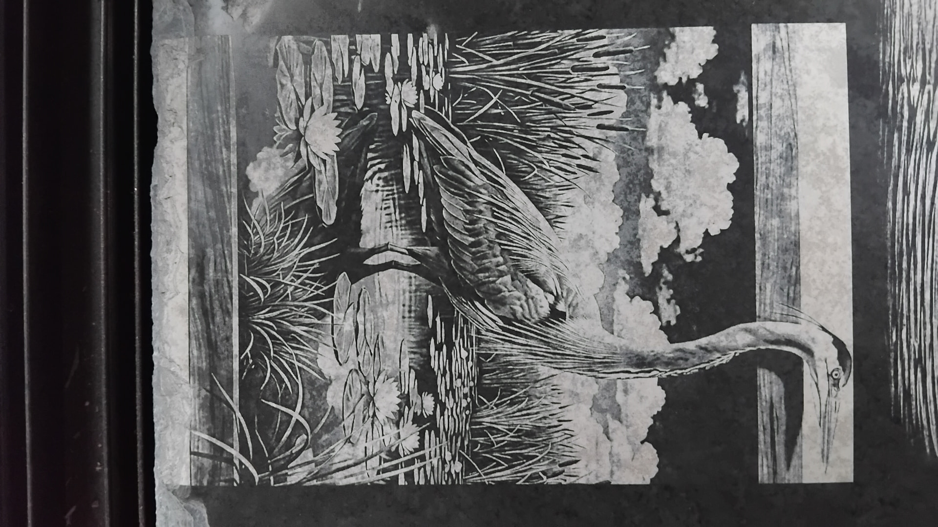

Nearly forgot, did a quick job on slate 120mm/Height yesterday…Two burns 50% power on second burn as the first was too contrasty. Needs work but on a larger scale it would be pleasing enough I’d say.
Now that blue and cyan are actually two different colors, the dithering worked in the area below the pure blue area. That’s probably why it looks bigger. I think the halo you’re seeing is probably the border where the cyan ended. Since I overshot the voltage a little, it’s still lighter in the “previously cyan” area.
I think the simple way to address this is to avoid expanses of blue sky and/or not have gradient in the sky. I like the idea of adding more clouds/trees, etc. Then if banding occurs, it will be camoflauged in the other stuff like it is in the clouds to the left. And your suggestion could work too. Maybe tell the separator something like “if you notice a large expanse of nearly the same blue, just pick the color that is closest and use it solid across that whole area”.

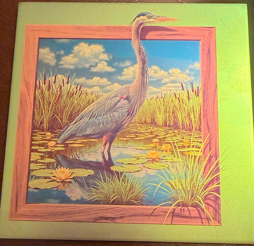

I tried ablating through argon to see if it would make the “blue over cyan” areas actually anodize to blue. It didn’t work. Those areas where the blue layer ablated cyan anodized differently than areas right next to them where blue ablated green. The “blue over green” areas anodized to blue while the “blue over cyan” areas anodized to cyan in the same dunk. The effect was just the same as when I anodized in air. I’m actually mildly relieved because working with the argon was a pain and was going to require some pretty involved engineering to get right.
I’m now confident that the residue left from the cyan ablation isn’t nitride or oxy nitride. The argon displaced the air, so there was no nitrogen available to react with the hot metal. This understanding is progress even though using argon didn’t become a solution.
My current theory is that the leftover heat after ablating the cyan is annealing the titanium surface. If the annealed surface is smoother than the not-annealed surface where the thicker green layer absorbed enough energy to avoid heating to the annealing point, this would explain why it behaves differently to the same anodizing voltage dunk. I’ve experimented with sanding the titanium to 400p grit before anodizing, and I noticed that this dramatically lowers the voltages required to achieve colors. For example, a 91v dunk that normally makes green produces a weak pink that I normally don’t see until 110v or 115v when the surface has my normal “roughen the 400p surface with the laser” treatment. So maybe the metal isn’t getting hot enough to make significant oxide but is getting hot enough to anneal a bit.
After three weeks down this rabbit hole, I’m going to leave it for a while. I have workarounds:
  1. Ablate the “blue over cyan” areas separately and after the regular blue dunk so I can dunk at a lower than blue voltage and gradually increase the voltage until the “blue over cyan” is as close to blue as possible, and
  2. Avoid having large regions with cyan to blue smooth gradient.
And I’m working to buy a MOPA laser which may give me ablation settings option that can ablate cyan without leaving that “anodizes to cyan” effect on blue.
