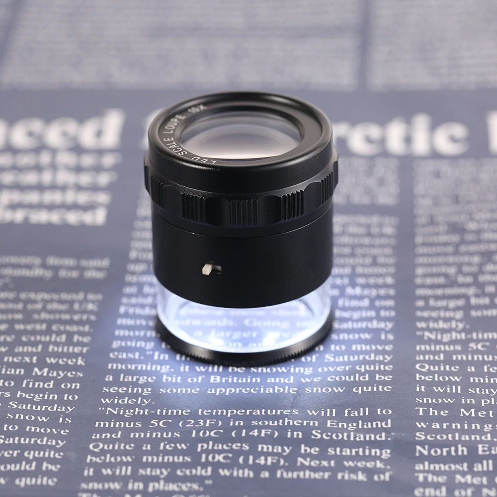

I don’t know if you follow Russ (Sarbar) on YouTube, but he has some great videos specifically talking about dot size for photo engraving. He is always using a little magnifier to look at his dots and says that they don’t look nearly as clear under a USB microscope as they do under his magnifier. Now, I don’t know what magnifier he’s using but I decided to order something for myself so I could look at my dots. What I got was better than I expected because of the reticle that is built in. It has a grid with lines marked at .1 mm, a .1, .2 and .3 mm spot size, and lines that are .05 and .025 thick. Really makes evaluating dots much easier. Did my best to try to get some photos. Zoom in on these and you’ll see it looks like I’m getting dots that are about .03mm?

Loupe
My only complaints are that it’s a wee bit hard to focus my eyes as you get away from the center of the viewing area which is where the .1mm circle is. I wish there were some circles on the reticle closer to the center of the viewing area. The pictures on Amazon do a better job of showing what the full reticle looks like. I’ll also say that when I ordered mine it took about 3 weeks to arrive. Amazon now shows these as available next day for Prime.

I was intrigued by that in the videos as well, and ended up getting a microscope calibration slide so I could put it on the object and take a picture.

Very curious what everyone else who ordered thinks of it once they get a chance to try it. @thx that slide looks interesting as well. The 10x magnification on this loupe seems to be just about the right amount of magnification for my purpose.

Pictures of the view don’t do the loupe justice, but here’s what I was able to provide.
What do you think of it?
Received mine today, very well made, very interesting to look at the differences in the burns- not sure I know what I’m seeing enough to make a difference but pretty cool!
