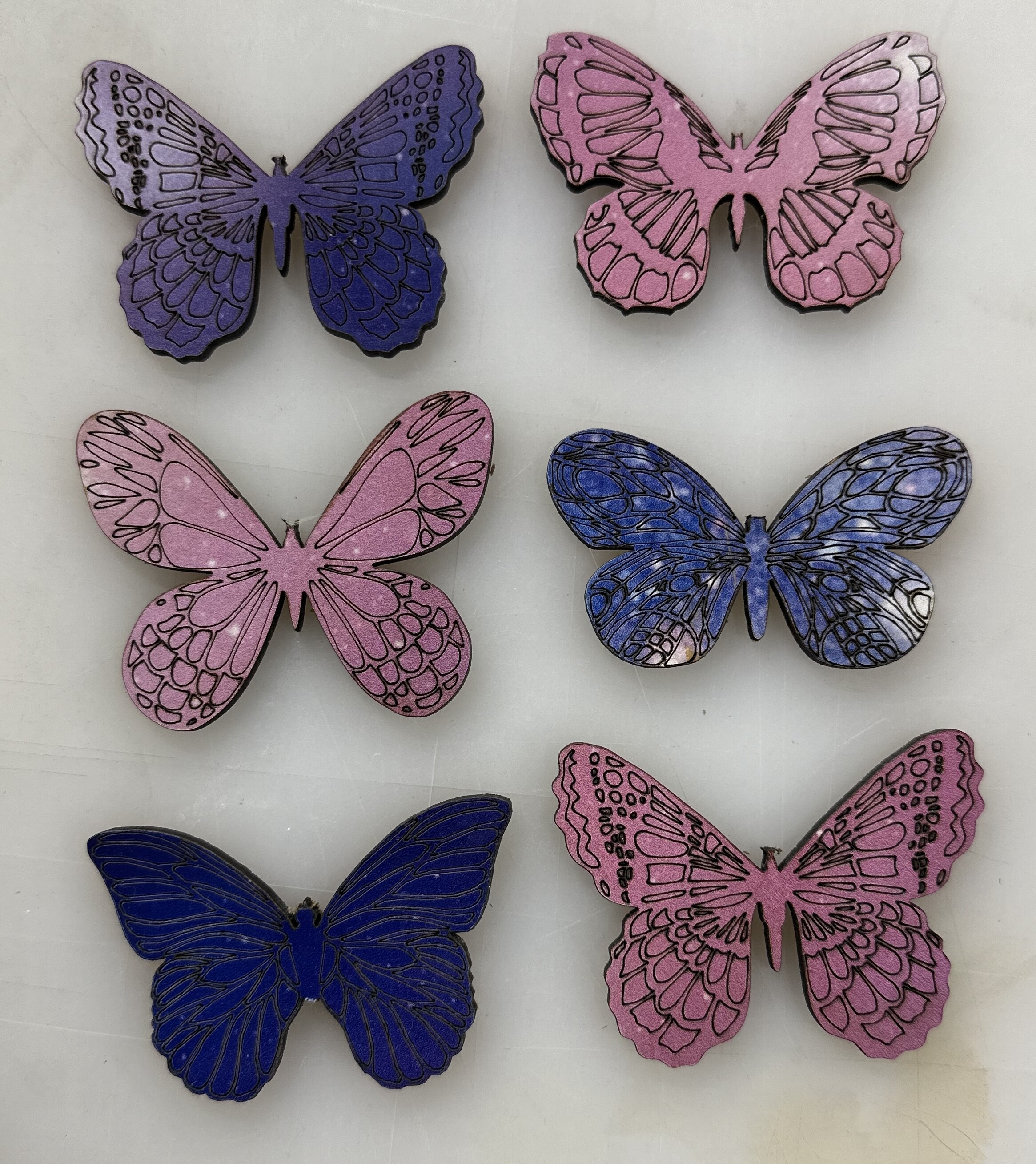

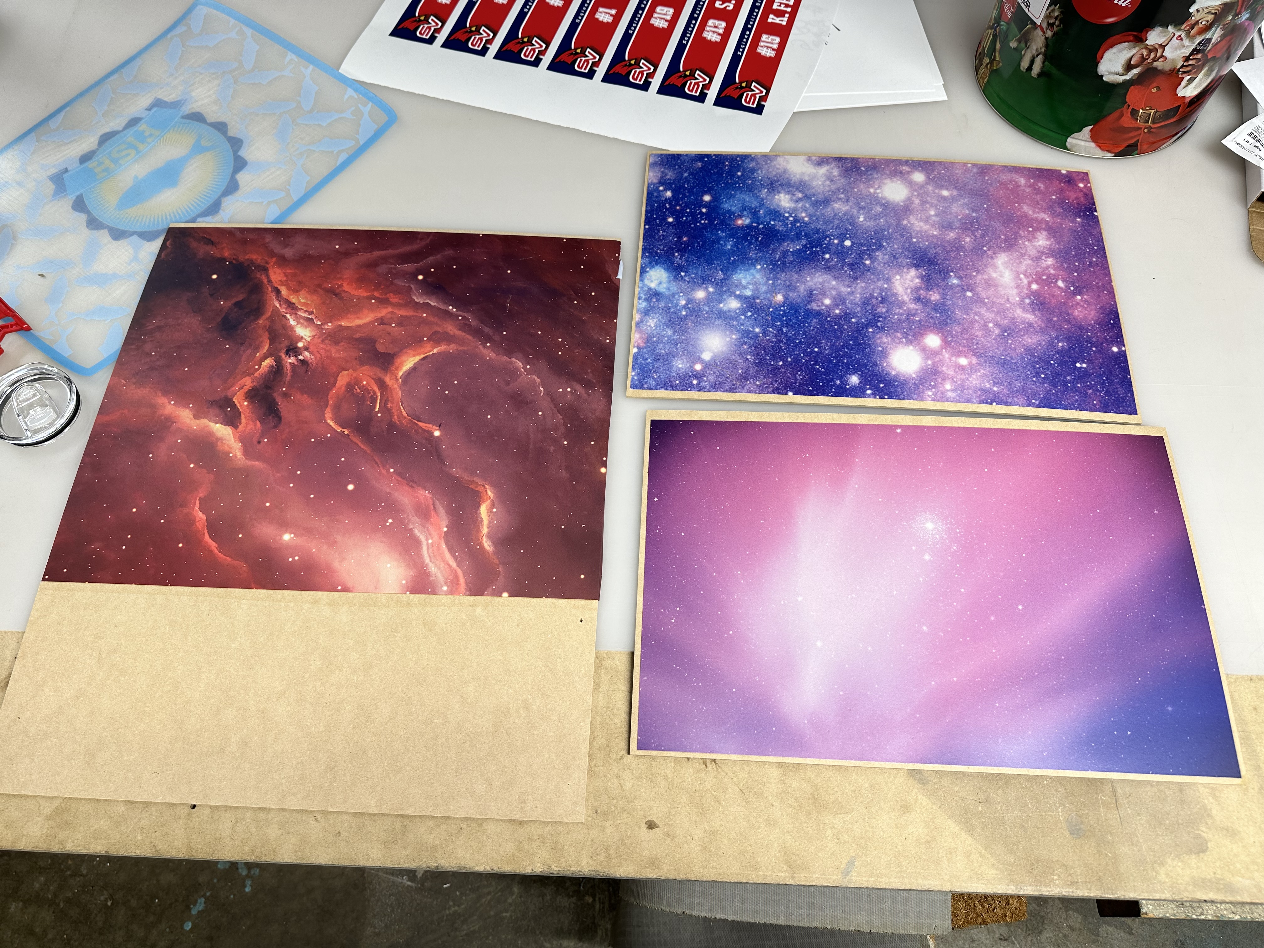

So I made some butterflies for one of my customers. She had bought some of those precuts ones that you paint, the ones she did looked horrible. I have a garment transfer printer and printed a few different pictures, applied them to the MDF, cut them out, and finally did a light clean. They turned out great. You could do something like that; paint it first and then cut it. I would think that would be the easiest way.
