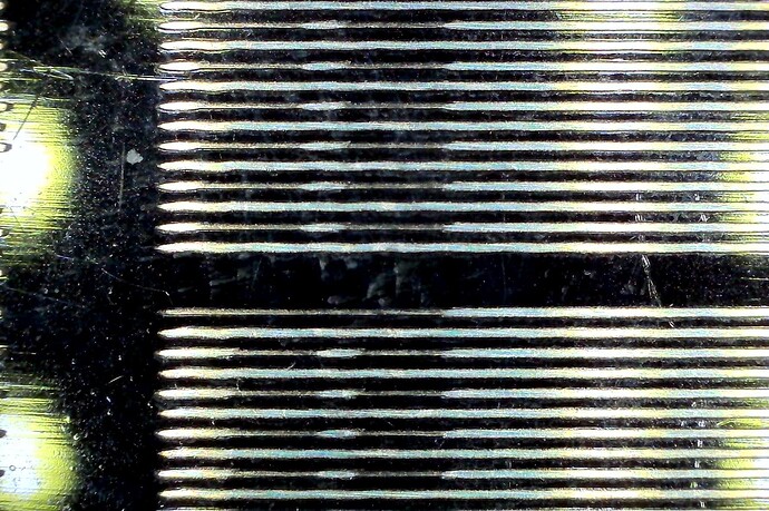

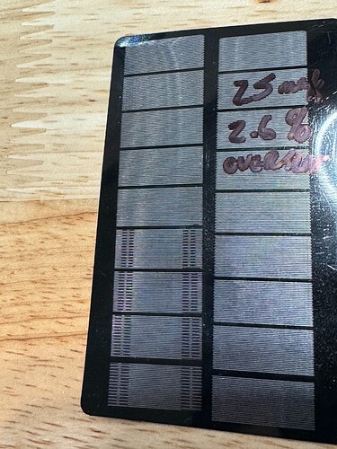

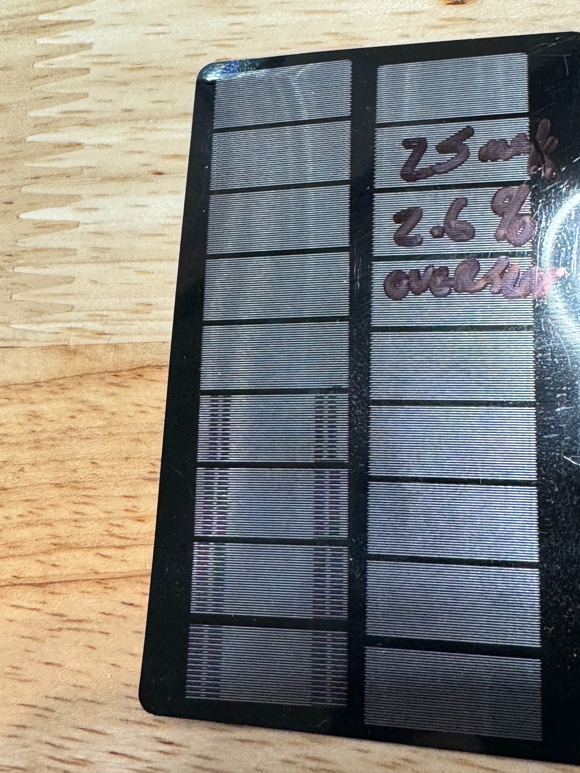

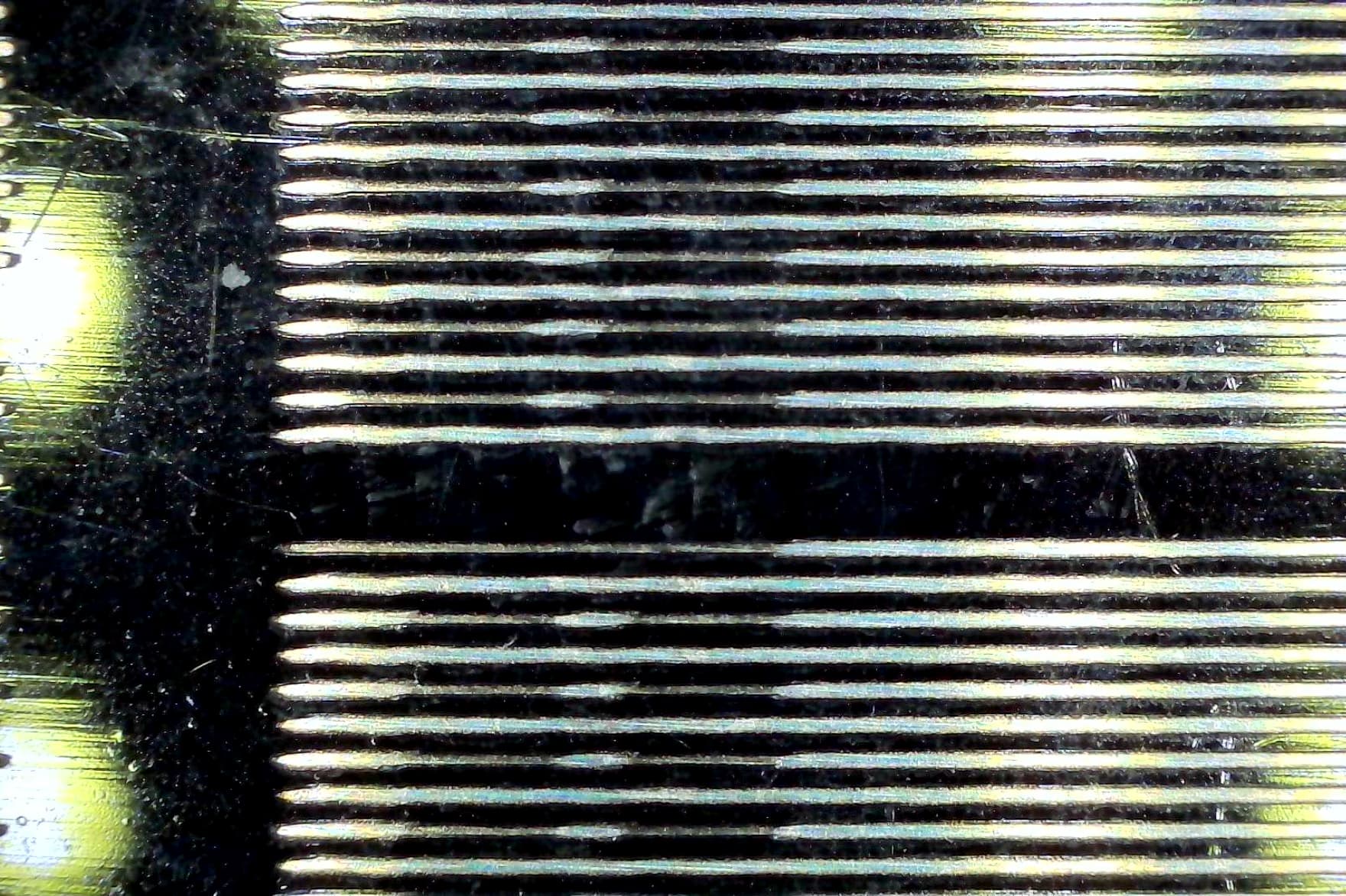

I’m trying to tune in a new Ikier 24watt unit and am going through similar steps that I have performed on my Falcon2 in the past, but finding this reacting very differently with this hardware. At the moment the above has me perplexed. If I fire a card full of test squares at 25mm/sec and the same power setting but vary the overscan from none to 8%, I get these wierd areas at the start and end of each line where the laser is visibly adding power and burning hotter leaving dark marks. At 25mm/sec its almost clean at 2.6% overscan, but trying to find the same at other speeds is not working; at 100 mm/sec any overscan causes these “hot ends” and leaves a fill area with a stripe in the center thats a different shade. Overscan off leaves very poor pointy laser lines that are unacceptable. Thoughts?
I have the same machine and it exhibits similar behavior. Especially at higher speeds and lower powers. I resigned myself to avoid using that machine at powers below about 20%, but that obviously restricts its engraving uses. I can’t figure it out either. Kind of suspecting it’s a cheap/slow driver or something in the firmware. I’ll be watching and hoping somebody has some ideas.

Thanks parsec, that was actually the phase of tuning I was in - but I removed all adjustment settings to confirm that the behaviour was being caused by only the Overscan setting itself. When Overscan is off on the layer I get smooth power delivery but horrible, horrible pointy starts/stops (far worse than anything my Falcon ever did). When on its like something is causing it to double dap the power at each line start. The enclosure is nice, thats the only positive I have for Ikier at the moment.

I’m not sure I’m following the conclusion you are drawing fully? At least relative to the issue I’m seeing. In the above images, one card is 25mm/sec and the other is 100/sec, but on those cards all test squares are the same speed and power. (25speed/15power and 100speed/40power). From top to bottom they only vary by the percentage of overscan input in LB, from off to 8% (a huge value in my opinion). So I’m not sure what the controller is interpreting and commanding the power to do as the head should be well at speed before the fire commands no?

How big is each square? If they are little you will have a larger relative overscan, since the ends are an issue, it’s likely it’s not reaching speed.

Sorry, slow today. Stock head, stock machine, “standard mode”, though I tried both stock settings for acceleration as well as a reduced value at 1500 for $143. Yes these are just tuning squares on a card, and with LB telling the machine to use 8% overscan (lower left test square on each card) I can visibly see that the machine is going well beyond the engraving start as expected/commanded; so room for accelleration is plenty. Just for some reason when the laser fires, it pulses these hot spots of differing lengths. I’ll chalk it up to a poor purchase for the use I intended, but I am a bit miffed at some of the reviews of so called reviewers of machines who raised it up decently without clearly looking at the poor beam and execution details.
Appreciate the input Jack and I think Chris provided the info to you you asked about. I will say though, with all the squares at the same power and speed as you can see the situation gets worse and changes as differing levels of Overscan are added in LB. Based on your hypothesis, the top squares should be the worst with none and then little added Overscan, and I’m seeing the opposite.
