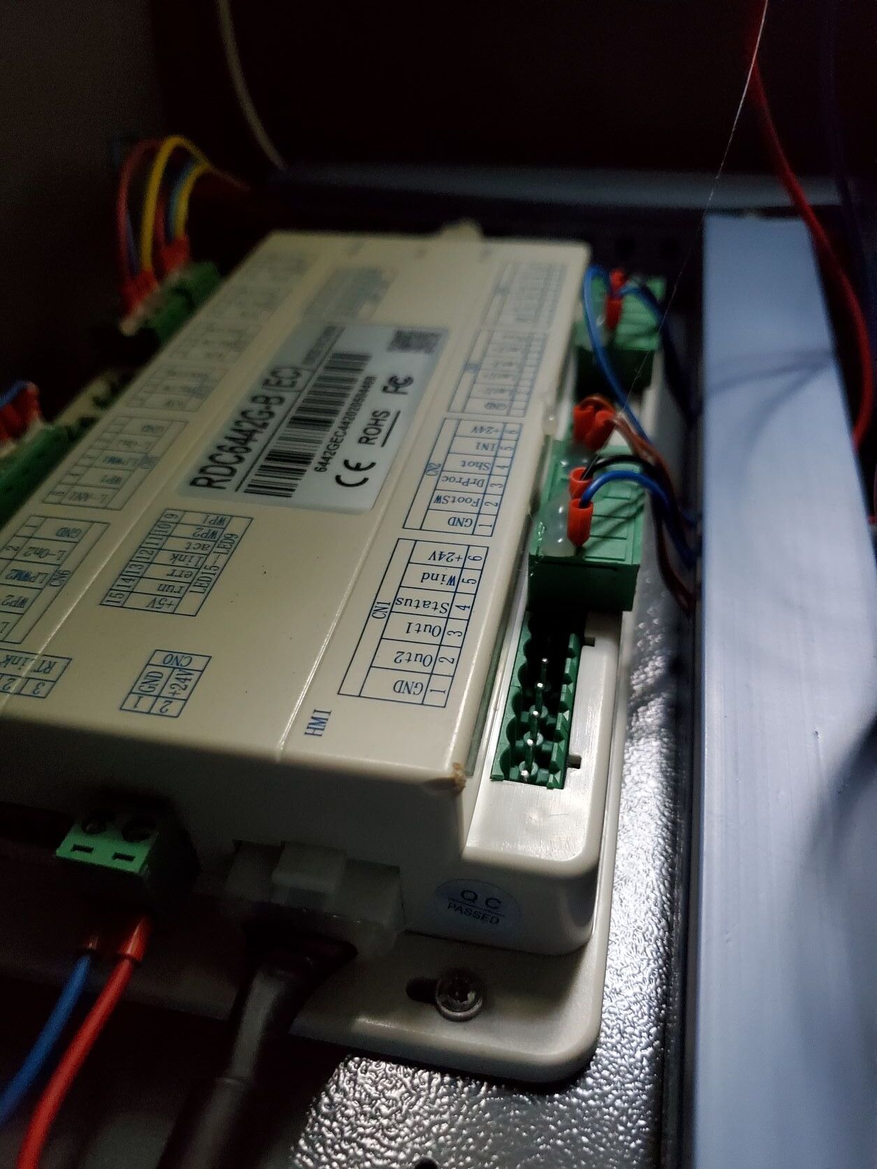

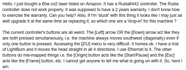

I'm new to lasers. I still cannot get it to work like it was advertised. I need help
Hello (again),
I think figured out how to embed pics, so , sorry if I’m too profuse, here is what I’ve got. The console_top pic looks like most Ruida6442 consoles. No surprises there. The console_underside pic shows the lacking cable plug, but otherwise looks straightforward enough although I had to hold my cellphone camera to see it (I’m 70 and my body doesn’t work very well). The right_side_cab pic is just that. I did not remove any of those grey trough covers. Finally, the Ruida_HMI_plug pic (which also only my cam could see)(although I could feel it with my fingers) is well plugged in. I even was able to ‘wiggle it a tad’. In doing so nothing changed at the console.
I suppose that IF the seller will send me anything under warranty THEN I may get into it all. I am knowledgeable enough to swap out components, it’s just that I seem to have a stubborn streak about buying a brand new machine and having so much trouble with it right off the bat (hence my interest in the warranty issue). If nothing else, this whole episode shows both my ignorance of buying these kinds of machines and/or of the seller or source. And that was AFTER I did a mountain of what I thought was due diligence in studying various forums and videos and online sellers (I live in a remote area with no nearby sellers, not even OMTech dealers).
Alas I am very frustrated, perhaps I’m ranting, or at least raving. I’m certainly aware that forum members have been trying to help me. Perhaps I overestimated having a hobby in my retirement. I haven’t even had a chance to get into some of those more technical issues that many laser users are having. I guess I wrongly though it would be more straight forward.
I’ll wait and see what the seller has to say, especially as to the warranty. I sent them a link to a video of what is happening (either arrow button sending the head SW {not straight left or down} and other buttons mismapped. Perhaps I’m supposed to wait on a slow boat from… …meanwhile… …tic,tic,tic…

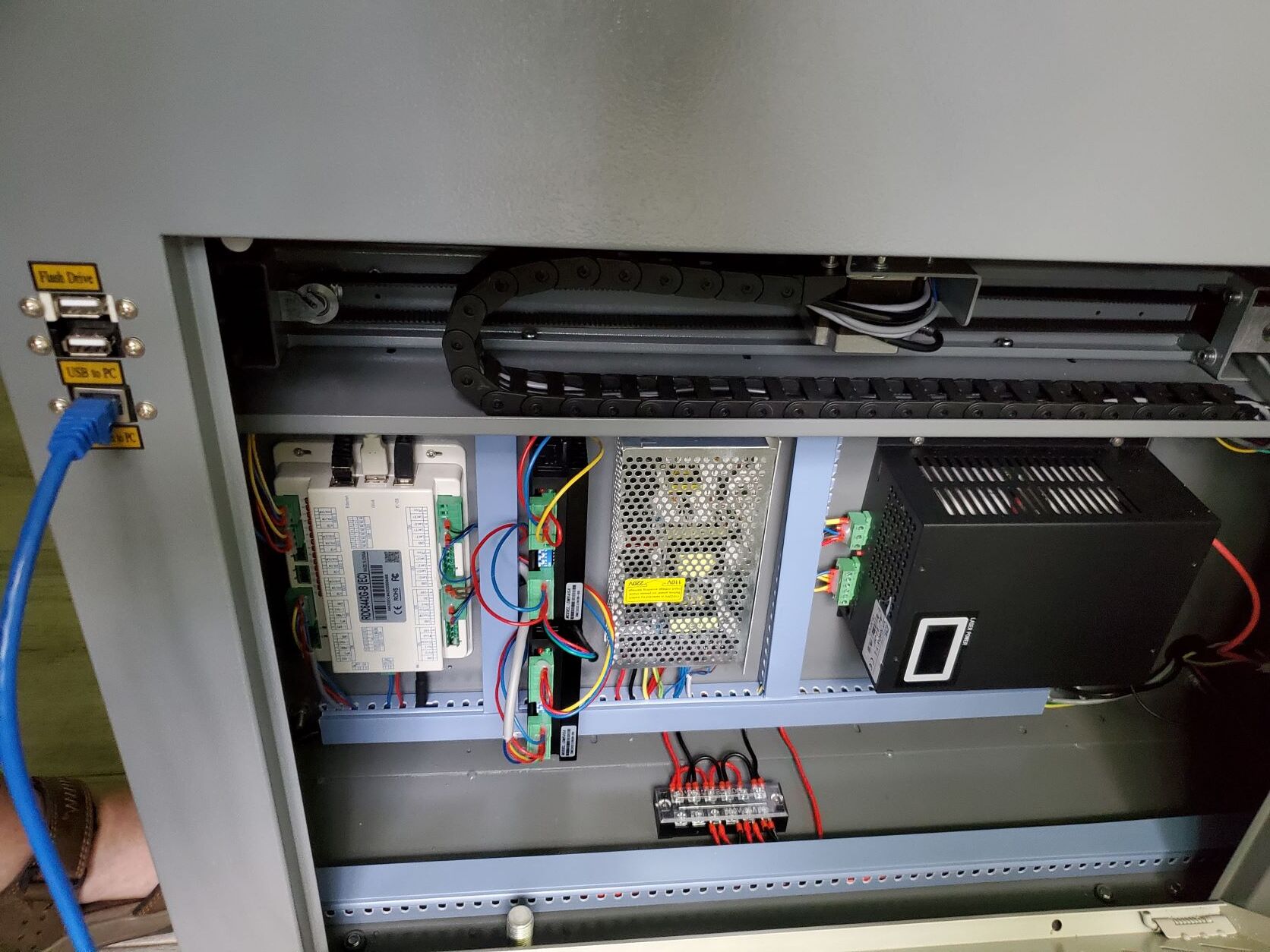

I have the laser machine tied to the Ethernet system in my house. That all seems to be working fine. I can use LightBurn to send files, read the machine settings, do positioning, etc. It’s just that the console is not working correctly. I wish my Ruida would work as flawlessly as your has. My machine is new and my Ruida has failed and it’s only been here for a few weeks (mostly just sitting here waiting on that slow boat…). Perhaps that’s just my luck.

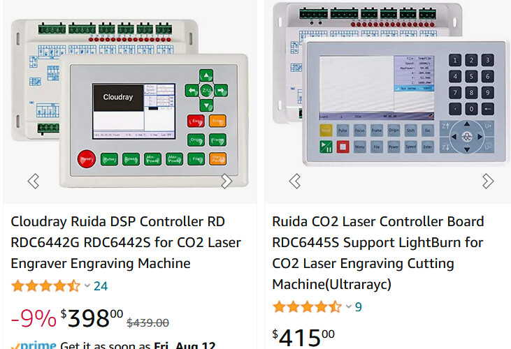

BTW which Ruida controllers will work in place of a 6442, assuming that IF I get this junk working then if I have to buy a new controller I may as well put an upgrade in there ? I.e. will any other consoles work with this main-board or is everything mated according to the model ? Like, will a 6445 console work with a 6442 main-board ? (or other combos)
Each controller has it’s ideal uses. The 6344 is about $900, 6445 is about $550, 6442 about $400 and a 6432 about $300. Most of these have the 6442 or 6445 types. The 5 has more resolution on the console and has some other tricks it can do. That is the difference between them… some are more specific for other things.
Things that vary are item like, how the extra axes can be controlled. There was one I assisted with that would allow the Z only to move between layers… turns out this one was actually designed for a system where, after the job, it slid the material a certain distance then would repeat. You couldn’t do any changes during the operation. Some machines needs to be able to manipulate the axes in specific ‘controlled and timed’ movements or sequences.
Here’s a search on Amazon for’em
Any of the controllers for a laser should be applicable. If you want other axes, it may be worth changing controllers.
If you want to move to gcode, maybe there are some American built controllers… IMHO, that is a step backwards.
The lps only needs two signals, the laser enable and the power level to operate. So anything that does the proper signalling and will signal the motor drivers will probably work… How much effort to configure the controller may be another matter.
So is there any rhyme or reason to the Ruida part numbers ? You said *

This thread appears to be aiming toward replacing the entire controller. I thought that since the controller is able to accept commands from LightBurn and that the problem is based on the laser moving in a manner contradictory to the key presses on the display unit that the focus would be on the key pad. Considering the price difference, wouldn’t it be a less expensive gamble to toss a twenty at the key pad/display just in case that solved the problem/
Hi Fred, well yes and no.
I’m still on the fence about what to do. Like I said before IF I decide to fix it then I’m still not sure where the problem is.
I do know that I do not want to toss a twenty at the keypad/display if that’s not the problem. So really, it could it be the membrane switch sheet, the processor in the ‘panel’ (which I’ve heard referred to also as a ‘console’), is the firmware messed up in it. It could be worse and the panel is sending ‘good’ commands to the ‘main-board’ and the main-board is messing them up. Are commands parsed from the Ethernet port (the UDP from LightBurn) differently than similar commands from the panel (I am now assuming that those are on an RS485-style cable, from the photo on Amazon showing TX1,TX2,RX1,RX2 which is some sort of differential comms (perhaps balanced or 42x-style). It kinda depends on the architecture of the firmware on those components.
But really, I just simply don’t want to be spending a bunch of time fiddling with it. Perhaps it has a susceptable E2PROM or Flash chip. I’d sooner replace the entire mess with the idea that the former issue could be anywhere (in the Ruida panel or main-board).
So, you are right, it would be less expensive. I’m just not that interested in tinkering any more. I’ve done that all my life and I just wanted a hobby machine that worked out of the box.

As for the panel/controller situation. I’d suggest disconnecting the panel and checking for damage at the connectors on panel and controller and along the full length of the cable. It’s possible there’s damage that’s causing a short and easy to diagnose. And besides, you’re going to have to go through this with a replacement so might as well discover what’s going on now if possible.

I am clueless how the numbering system works. There’s threads on here that say the 6442 version doesn’t handle the rotary on Z/U axes and you need a 6445. Never tried to use my machine that way, so again I’m clueless.
Believe me I’ve looked for some simple explanation. It also varies from a 6442s and a 6442g, so I’m not the wizard on these.
At this point I’d advise you to pitch it into the round can. It matters not what many of us have advised you, you seem perceptually irritated about sale. Most of us have some kind of issue using these, just like any other machine. I would hope that if someone sold you a milling machine and a purchased tool broke, motor died early or whatever you wouldn’t want to toss the machine … but maybe you would?
IF the vendor doesn’t make it right, a c-note would get you a new console and probably fix it and you could move on with a happy hobby.
