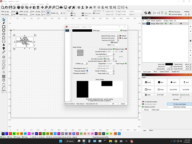

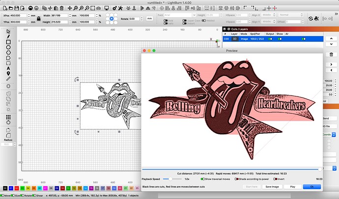

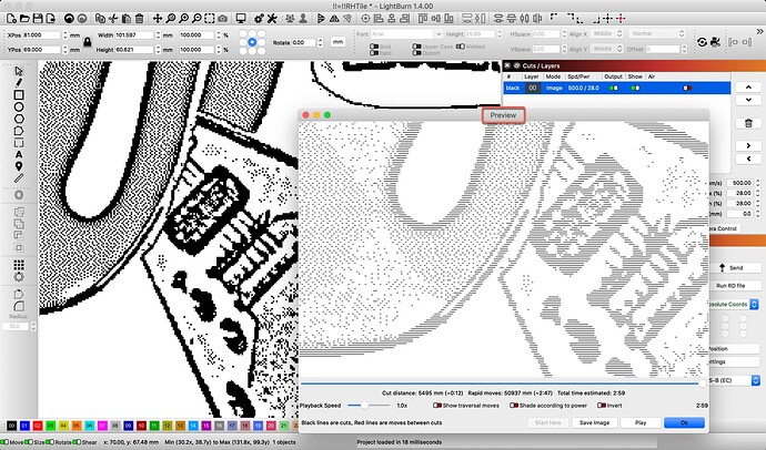

I’m going crazy. Images in pass-through have no option to toggle cross-hatch on and off. It’s always on. I want it off. How?? Software is version 1.4.00. Playing the job in preview shows it doing cross-hatch as well. Here’s a picture of the layer settings.
That seems odd. Can you upload the .lbrn file for review?

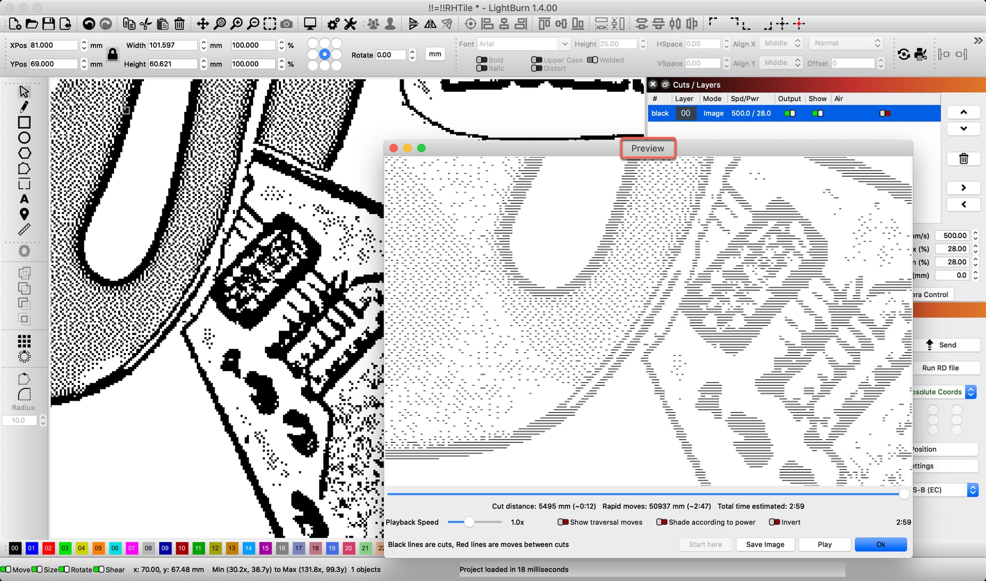

Thank you. As you gather, showing us a ‘Preview’ along with your test output would help too. :slight_smile:
Here’s the lightburn project file.
RHTile.lbrn2 (123.8 KB)

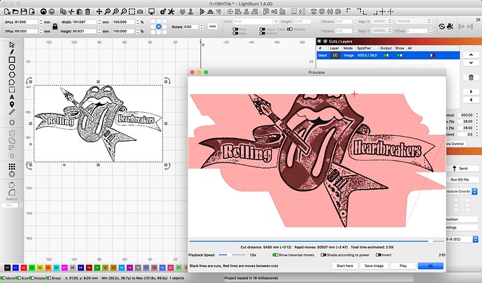

As for the preview, when I play it, the image scans fully horizontally and then again vertically. So, preview matches the laser behavior. Not sure how to show you that.

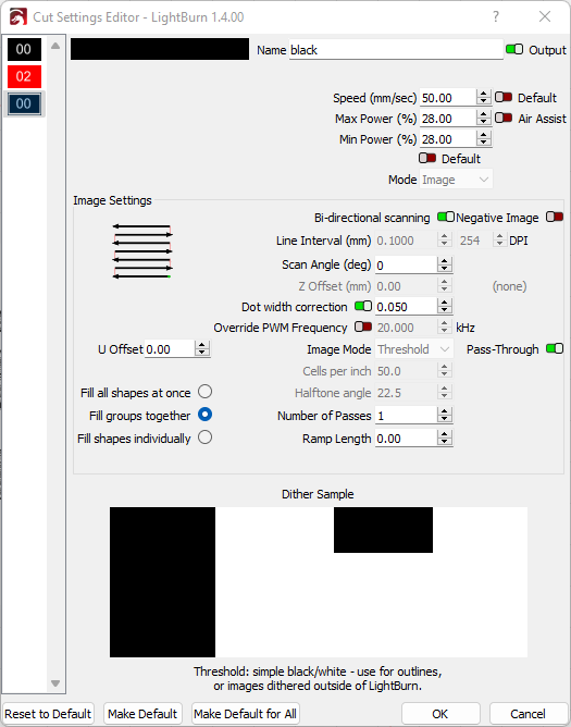

Given this, please show the screenshots from the CO2 profile that is producing the cross-hatch. Current shares are showing the Galvo profile.
These screen shots are from the CO2. “Frickin’ Laser” is my CO2 with ruida controller. I just walked out to double check. I also have a comMarker B4 with EZCad2 controller but that is not hooked up at the moment. Light burn is talking to my CO2.

I am seeing what you describe in the lbrn2 file shared, investigating further.

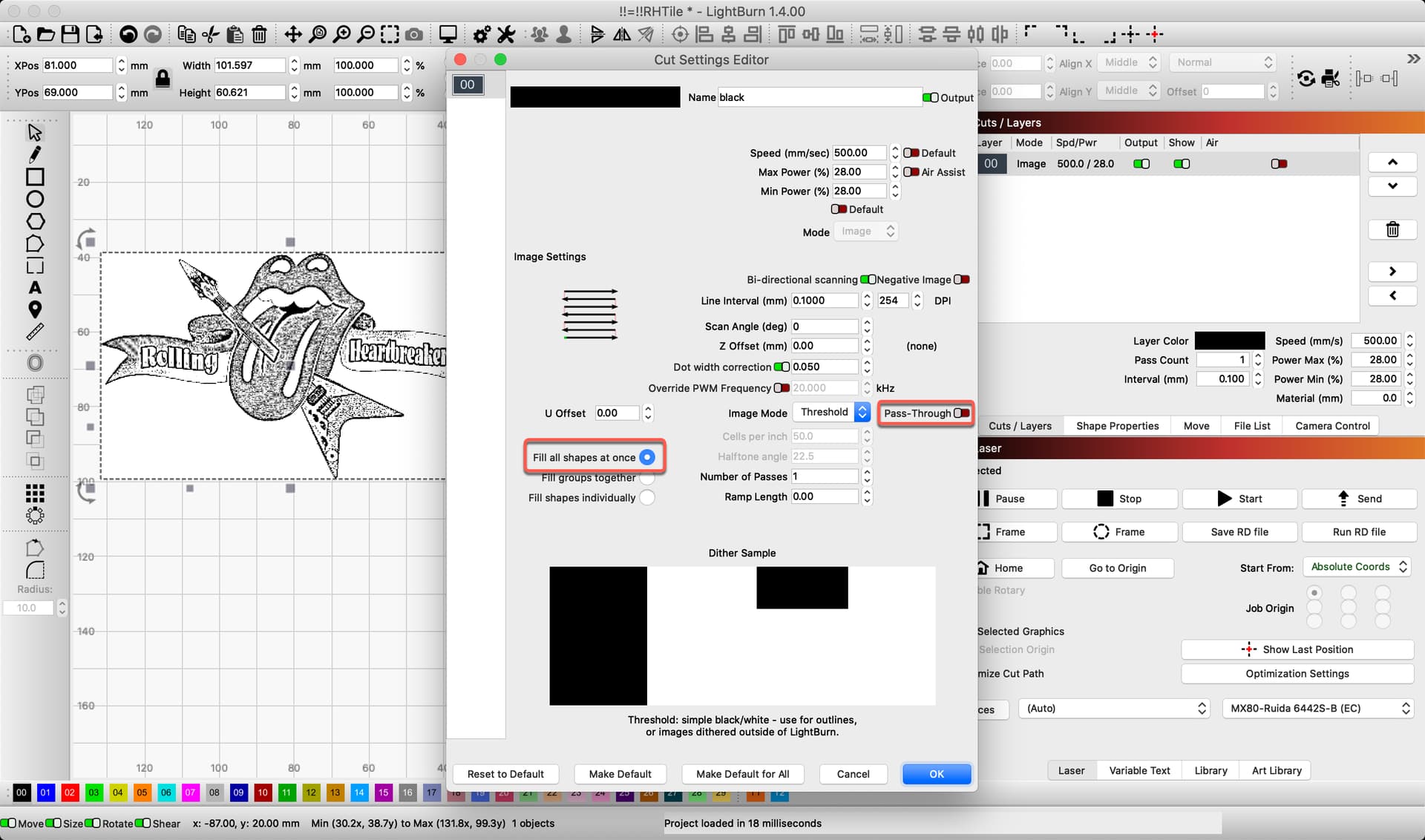

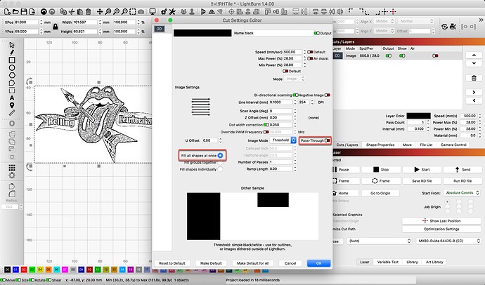

I note: If I turn ‘Pass-Through’ off (red) and set ‘Fill all shapes at once’, I can produce an image scan as you’d expect, without cross-hatching.
I can confirm. Same behavior here. Pass-through must be off and must Fill all shapes at once and the cross-hatch goes away. Any other setting will cross-hatch. But… I want to use pass through for images processed by imagr. This seems like a bug. Nothing we’re doing should be telling lightburn to cross-hatch. Where is it deciding to cross-hatch?
I just opened the lbrn file with a text editor (never did that before) and I see it has crossHatch Value=“1”. How the heck is this possible?? I’m going to manually edit it with a text editor to see if I can alter it… Will report shortly…

If I manually edit the lbrn file with a text editor to set crossHatch Value=“0” and reload, then the image does not cross hatch, even with pass-through on. So, I can do this as a work-around. Seems light-burn core code believes there is a cross-hatch option in the UI, but there is not.
I just tested, starting anew. I opened a new LightBurn file and ‘Imported’ the png file you shared. I set the Cut Setting to Pass-Through, and this is what the ‘Preview’ shows.
This is interesting. Loading your .lbrn file broke my LightBurn installation for images, with the crosshatch effect always being on.
I did not have that before. I had to revert to a previous prefs backup to recover.
So somehow crosshatch got stored in the .lbrn file and is unrecoverable after that point since there’s no GUI option to disable it.
More playing… No matter what I do in the layer dialog box now, I cannot get crossHatch to turn back on. Setting it to “0” in the lbrn file and loading it has made it off, no matter what. But, starting raw from a new file, dragging in the image, I get the crossHatch ON issue.
Load the “fixed” file… then go to the Cut setting for the layer. Then push “Make default”. That might resolve the issue.
