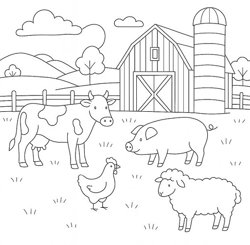

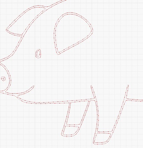

Would like to find out how to import a image and converting it ot lines that keeps image in a single line. What happens when I import and trace it creates a line on either side of the image lines.
See attached images!
What you want is called single line tracing and LightBurn unfortunately does not support this feature (yet?). You will have to find an external program like Inkscape for example which is better suited for it.

You may want the traced vector you have. If you get the single line version and draw this with a co2, then it’s lines will only be about 0.15mm in size. The traced version can be filled.
