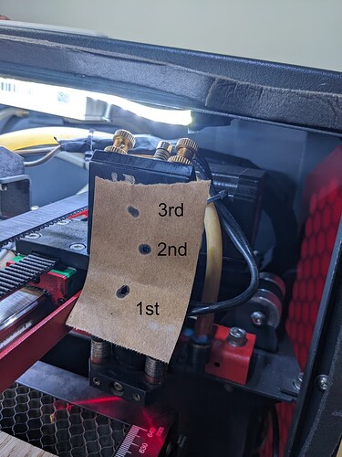

So the bed is level, I have checked this out.
I think I may be closer to the answer, so I did some test line scores. Top left and then middle and bottom right.
The focus height was the same in each area, but the top left looked out of focus, middle was perfect and then bottom right was blurry too.
So I decided to check the mirrors, First and second mirror are spot on and in the middle.
But when I do the check on the laser head (before it hits the mirror) I notice that the top left and top right were out.
Middle left and middle right were perfect.
Bottom left and bottom right were out.
See attached images.
Imagine the grey is the laser bed itself and then the checks are done left to right.
Would this point to a X or Y axis rail that isn’t level?
If these are done as per your graphic, I don’t see how it works at all in some areas. Am I misinterpreting what you’re showing?
It looks like you need an alignment.
