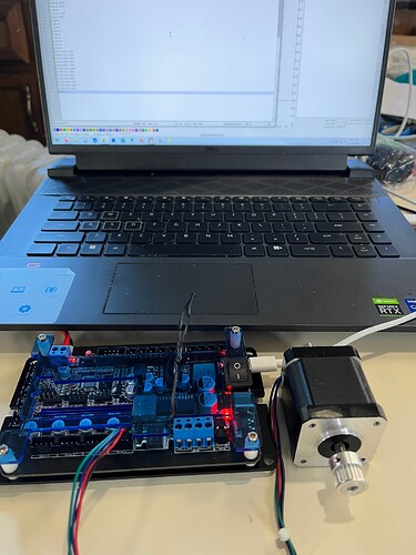

Gentlemen,
Thank you for your replies.
Enclosed are the equipment being used. Laptop, 4 axis board and NEMA17
Photos

When and IF I get this working the machine it is going in has a 1/4inch/20tpi leadscrew. Therefore 1 inch / 20 tpi results in .050 of advancement on the leadscrew for each rev. So an arbitrarily picked number such as 4 yields .050*4=.200. That would advance leadscrew .200 per 4 360 degree revs of the stepper.
The gear on the end of the stepper has set screw holes, I use them to tell if I am getting 360 degrees per rev.
With your setup, you could easily be off 2-3 steps per rotation visually and not notice a difference in stopping position.

The first photo is of the first press of the right arrow key, dro
1st pos move from 0
DRO vs ACTUAL Stepper Movement
1 050 to 050
2 052 to .100
3 054 to .150
4 056 to .200
