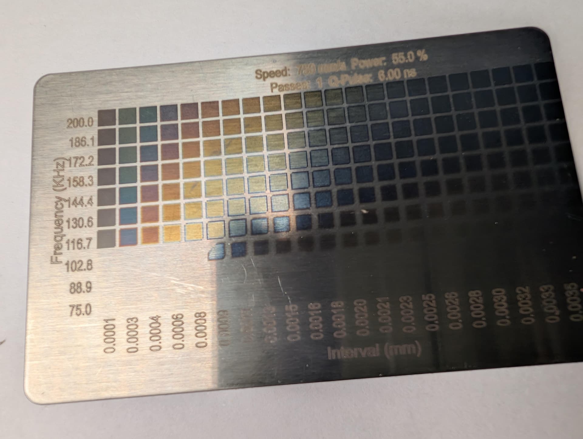

Hey,
I have a Commarker Titan 60W Mopa
I am trying to print a Colour dogtag, and I am running into an issue where its not working.
I have resolved it down to a number problem
I am trying to enter a interval number, and the UI is not changing the value to what I enter
I am trying to achieve a RED
According to the Material test print:
I should be using:
frequency of 130.6
interval : .0004
(see picture)
however, when I set the interval to be .0004 and click OK, its defaulting back to .1000
and I am not getting the color I want.
I have printed multiple testcard. and almost always, the colour I want seems to be in these ranges.
recommendations, help or other suggestions appreciated.
The smallest line interval that can be achieved (at least for me) is 0.001, not that I have ever had the need to go even close to that.
I would think that the limit is by design.
I think the minimum line width for most fiber lasers with a galvo is 0.001, I found that the cut settings UI limits it to that, but material generator UI doesn’t (it’s probably a bug). So when you use line widths smaller than 0.001 as you are doing then who knows what line widths are actually used.
Do material tests with line widths starting from 0.001, not 0.0001. Also a few days ago I posted some of my material tests for colors on steel, they include some nice red and other colors in a post here, you might find them useful, at least as a starting point.

My shortest lens is an F100mm and it has a spot size of 16 microns (0.016mm). So an interval of 0.0004mm would cover the spot size approximately 40 times. Not to mention take forever, even with a galvo.

I agree that the limit might be as designed, but as you can see, the Material test tool has exposed that its capable of going smaller, and its showing a difference when it does so.

It says that, but you don’t know that. Part of the problem is we assume (and hope) what’s displayed is what’s being used, however it doesn’t always end up that way.
These are the areas I expect to find bugs or more likely rounding errors occurring, as I stated, we need some help from one of the Lightburn developers to determine what’s going on.
I can set my q-pulse for values that the source manual states are not available.
It may say an interval of 0.0004mm, but that may not be what’s happening…
The galvo head itself has limitation on precision.
Hang in there and see if one of the Lightburn people can answer this for us…
