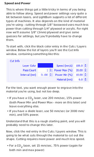

Thanks, I found this on page 16 of the Lightburn Doc; can’t find where it says the laser Watt. My wood has arrived for model rocket fins and centering rings. I’ll be setting up a cut test and will share results. Probably early next week. Thanks again.

5w is better, 10w is even better. If you have a good focus, the main difference is traveling speed. You just have to run a 3w machine slower, that is all.
My ply cutting with 10w is rarely less than 3 passes, so do not think yours is inferior because it won’t cut thru in one pass. I don’t run mine at full power to help the diode last longer.

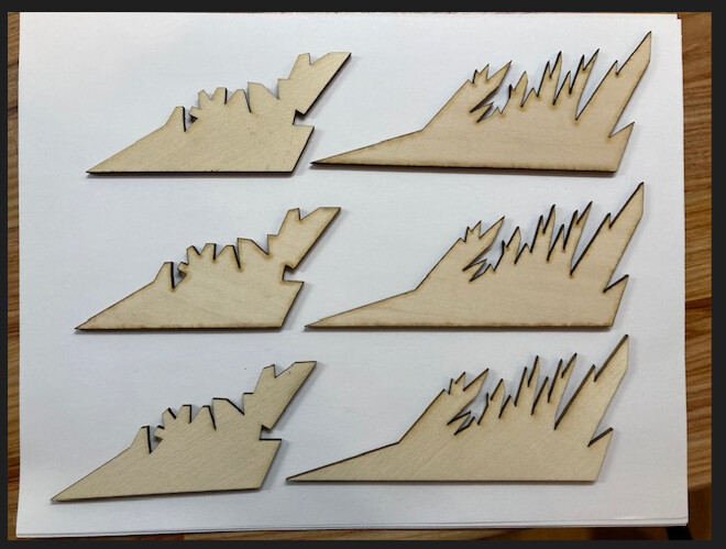

Here are the fins for my grandson’s model rocket, Dragon Wing. 3mm Basswood, cut with a 40w laser; 2 passes, 550mm/m at 90% power. Nice clean cut. About the same for 1/4’ plywood only 5 passes. Now I’m really having fun! Thanks Mike and all for all your help getting here.
All says welcome! Having fun is good!
By the way, those fins look more decorative than functional. Or did you discover a new drag-reducing concept? :grin:
OpenRocket gives good flight characteristics but with a warning about jagged edges. We shall see; we’ll stand well back at launch time! Thanks.
I think they meant saw edges. Supposed to stand way back anyhow. I did Model Rockets once too. Potassium Perchlorate and sugar is awesome!
