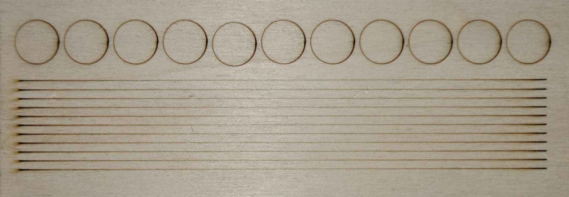

I have a co2 laser and a ruida board Lightburn V 1.4.01
When engraving on wood, some circles produce a relatively uneven image. Firstly, it starts relatively dark. The curves are uneven and end too early (circle not closed). If I make several circles, some circles are perfect and some look like the picture it doesn’t matter whether the circles are engraved at the beginning or at the end of the job
what can i do to get an optimal result (complete and even circles)

The Laser Starting dark and fading along the circle looks like a Tube or Laser Power supply behavior. If you’re working around 20% power the tube could be on the edge of firing or not firing.

yes that is correct with the simulation i read the settings from the controller so you can see how the controller is set if you need more details i will look under the machine settings what can i do to get an optimal result the circle is as line does not engrave as picture

This isn’t related, just curious why the pwm is set to 1kHz? I’ve tried a bunch of variations here and it wasn’t worth the effort in my opinion. I think it’s purely academic. The default that is usually 20kHz…
I got some rather non standard output with that low of a pwm, especially at high scan speeds.
for me, the normal engraving is at 1kHz, as in the photo, if I set it to 20 kHz, the whole thing gets a lot darker
if I cut with 20Khz then it chars properly and I can press black
I spent a lot of time with the pwm period… The higher periods (lower frequencies) are passed through and the lower periods seem to produce a smoother control voltage.
I went all over the place with these and I could not change the material like you have with a change in period.

I have observed that there is a difference whether I laser with 1kHz or with 20 kHz
with 1kHz = not burned (normal engraving)
with 20kHz = burned ( I can press black)
In relation to my picture, this means that at the beginning of the line there is a high frequency because it was burned, at the end of the line there is no frequency because it was not lasered
it almost seems that there is a scan offset when filling because the image is ok this does not seem to be the case with the line because the beginning and end of the line is not correct

This is an unusual setting. Some people here are experimenting with it for half-tones and softer shades. It pushes the engraver into an intenionally weaker state but the reliability of the engraver (especially starts and stops) can come into question.
This is very common for a CO2 laser engraver. For the 40W tube and power supply you should have a High speed and 30% power available to you that can make the light Brown color immediately and on demand. In the Cuts / Layers window what is the Speed, Percent Power for each operation and what units are applied to the commanded speed?
Without an oscilloscope to verify the input, or the operator adjusting the frequency of the controller output, the cause of the change in laser performance can not be attributed to a change in frequency.
I feel that the low frequency state is causing the unusual behavior.
I agree. This was noted previously as an erratic and occasional behavior.
I would come back to 20 kHz with the laser engraver in all modes and reestablish good speed power settings. The High voltage laser power supply at 20 kHz should be more reliable.

I have already done a similar test with the result that with the fill and 20 there is a slightly darker color in the line, however, there is no difference, that means it is darker at the beginning of the line, but I only noticed the large distance at the end of the line now

Set your min power to a much lower value to get a more consistent and even burn, e.g. 8%.
The uneven burn could also be related to acceleration settings being too slow, what do you see in Edit>Machine settings for this area?:
And try setting your PWM to be at least 3Khz, otherwise at higher speeds the burn will be rougher and not as smooth.
That looks better. The maximum speed I have is 200. If it gets faster, I lose steps
It’s still darker at the beginning and end, but not for as long

Do you maybe also know how to best set the vendor settings because I’m sure they are wrong because the board that is installed there is not original, that means it was originally a mk5 with a sooty board and the ruida board that is now actually belongs to the successor model mk6 the structure is still from the mk5
This is a good indicator there is something wrong with the configuration…
The user should not be able to break the machine… Your artwork should not be able to do this.
Please go to Edit>Machine Settings and use ‘Save to File’ and upload it here.
Nevermind I see you have PM’d it, I’ll take a look…
